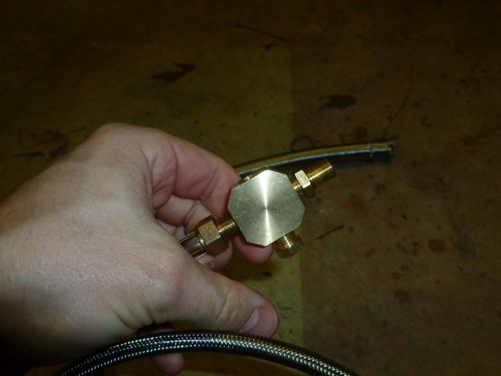

    Im sure that's were its supposed to fit. Im just not sure how or if the threads will fit. I don't think oil sensor threads are universal... :notsure:
    Here is the picture:
    The fitting with the two female threads is a pass through so Im guessing it mounts to the block and the side with no fitting is for the oil pressure sensor... Again, I don't like guessing and if the fittings aren't threaded right, Ill have to spend more time and money finding an adapter :mad:

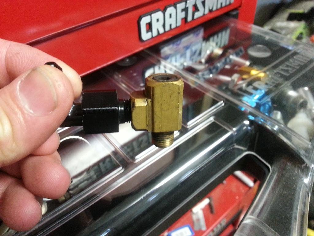

    It should be BPST. I used 1/8" NPT, and have not had one single problem. Primarily because I never knew what it was supposed to be when I got the STS kit. Then just stuck with it from there. Lol.
    Here is one picture.
    I will try to upload one of the fitting that I have.

    For Clifford's, we couldn't find one like this. So we picked up a female Tee. Then a union 1/8" NPT adapter, to mimic the male end of mine.
    I have no idea what the thread end of your hose is though. What I mean is, that is it threaded for 1/8" NPT, or AN?

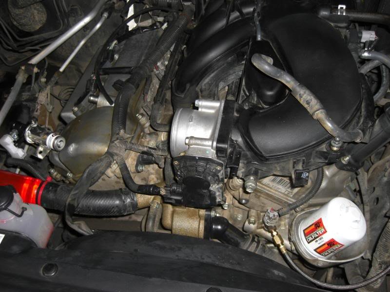

    There should be a spot near the oil pressure sensor. I'll take a picture once I get back home from my trip.

    Thanks man but I got some pics on the customtaco forums. Its also 1/8" NTP like Tor has but I don't think I have to remove the oil pressure sensor. Just a direct connect :yay:
