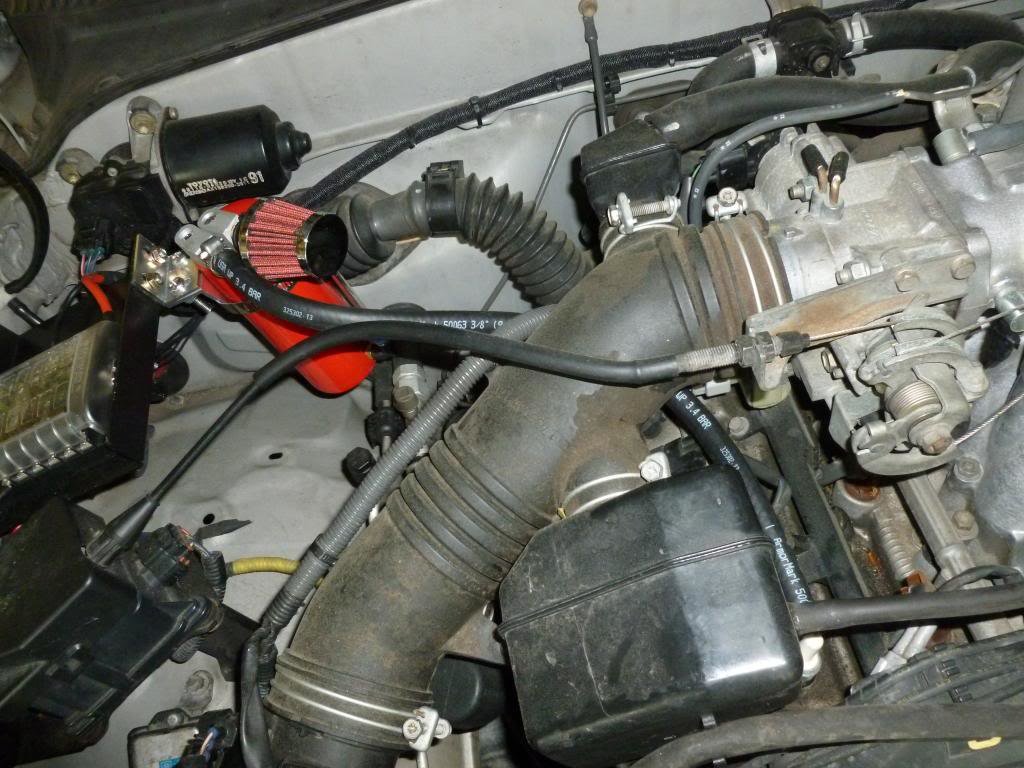

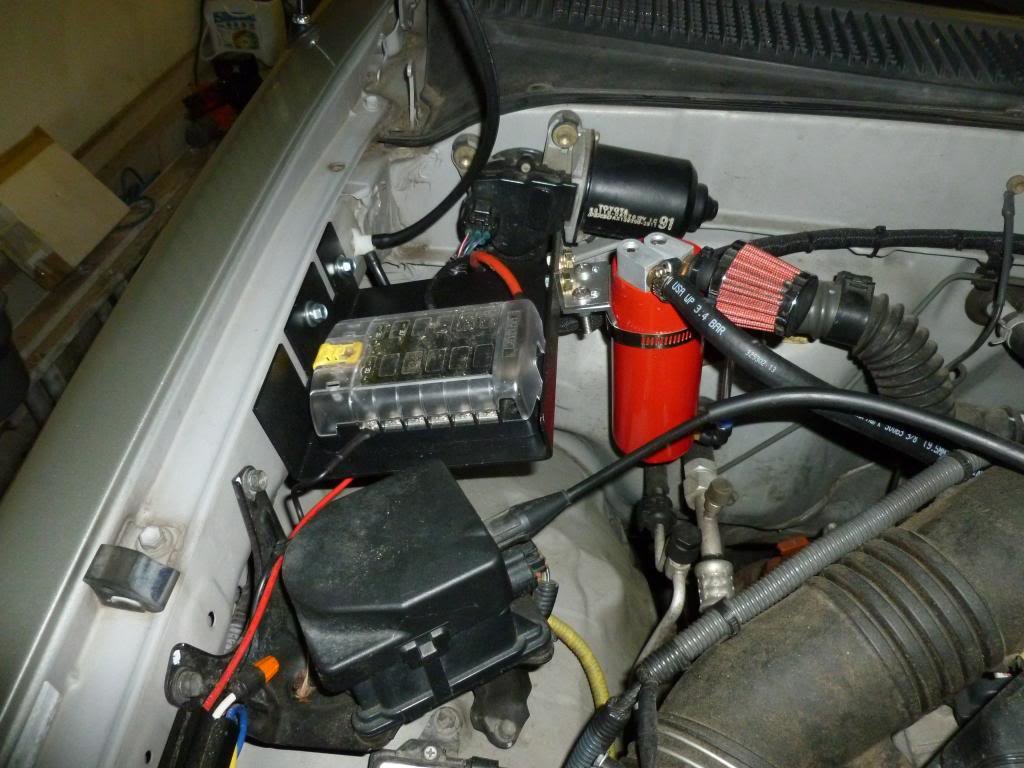

    Installed oil catch can and new plate for the fuse box.

    Is that going to have to be moved when the turbo gets installed, or is there plenty of room?

    There's room. It might be hard to see but I mounted it high up over the front wheel well, out of the way of the turbo. It will be a bit tight in there but there should be room for everything.

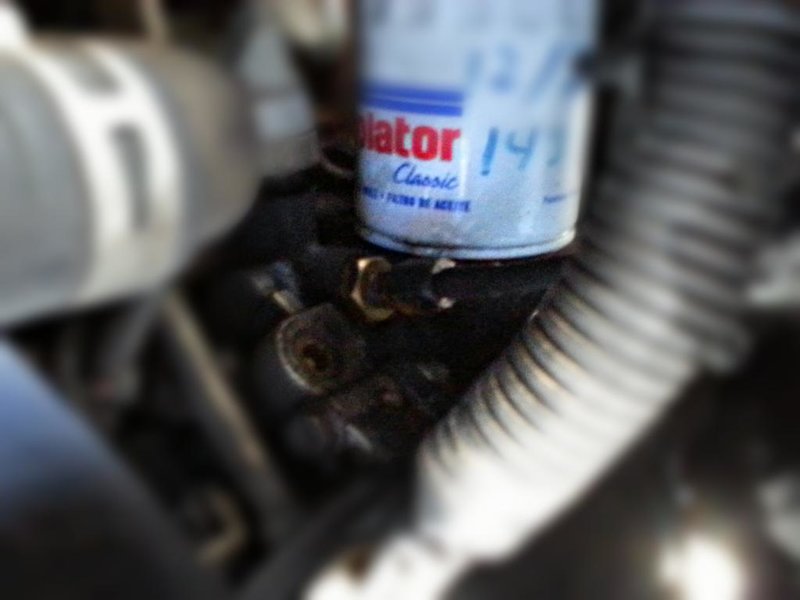

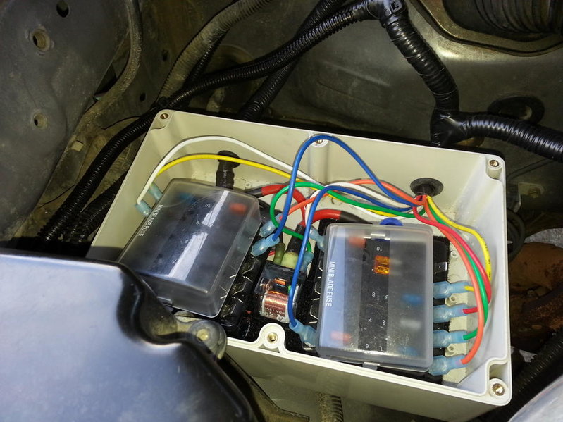

    Your aux fuse box is in the same location. I enclosed in a white project box.
    Attached is also the reference to the oil feed just in case someone is looking for it.

    Thanks for the oil feed pic! I think I have everything figured out except my IC piping rout... I dont think the kit pipe design will work with my planned mount.

    The oil feed was probably the easiest part of my setup to do. I think for the oil drain on the CX partial kit I'm getting, I'll just use the scavenge pump I have instead of being SOL until I get my oil pan tapped.

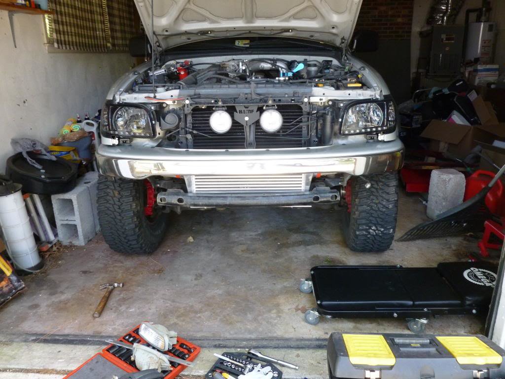

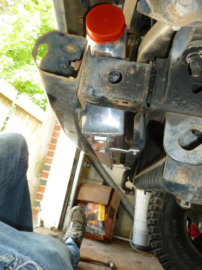

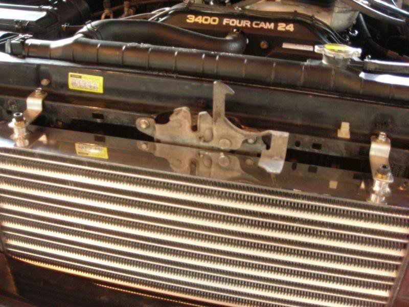

    *Dont mind the garage, flooded the other day from rain...*

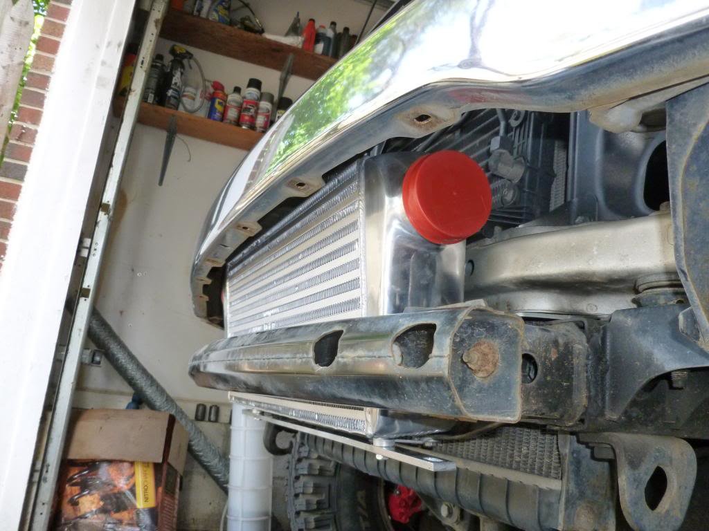

    Looks like the AEM FIC is working! No grounds and Im ready to move on :yay:
    Did some fit checking on the FMIC today. Initial mount idea when right out the window and had to get creative with the hammer and drill.... Im a little bit ashamed of the the outcome but it works :D...
    Needless to say, Ill have to get used to the idea that I will never be able to mount a wench on the front bumper...

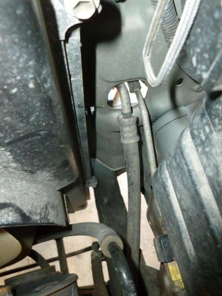

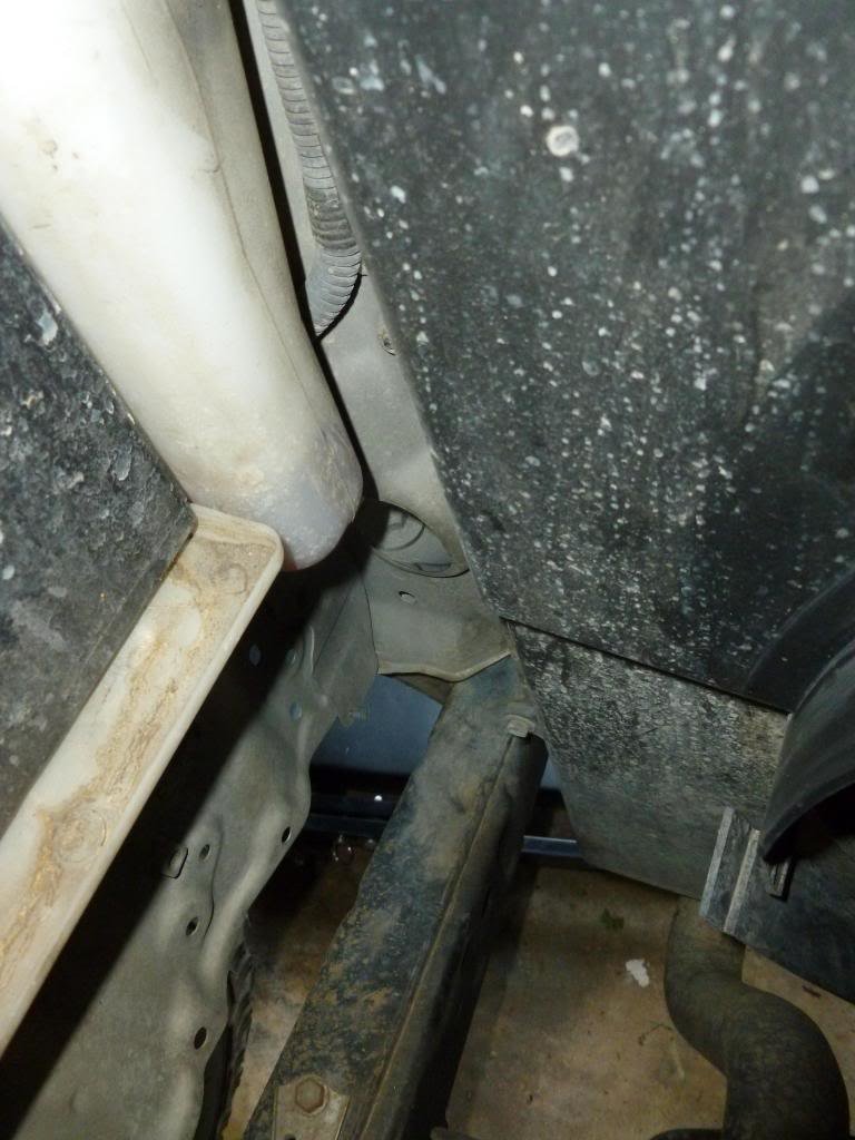

    Here are some pics of where the intake with be routed.
    Driver side is pretty clear :)
    Passenger side is not :(... I will have to find a way around the AC lines or get them moved...
    Didnt feel like putting the lower valance back on so I ghetto'ed it up in case I need to drive it anytime soon. All zip ties.

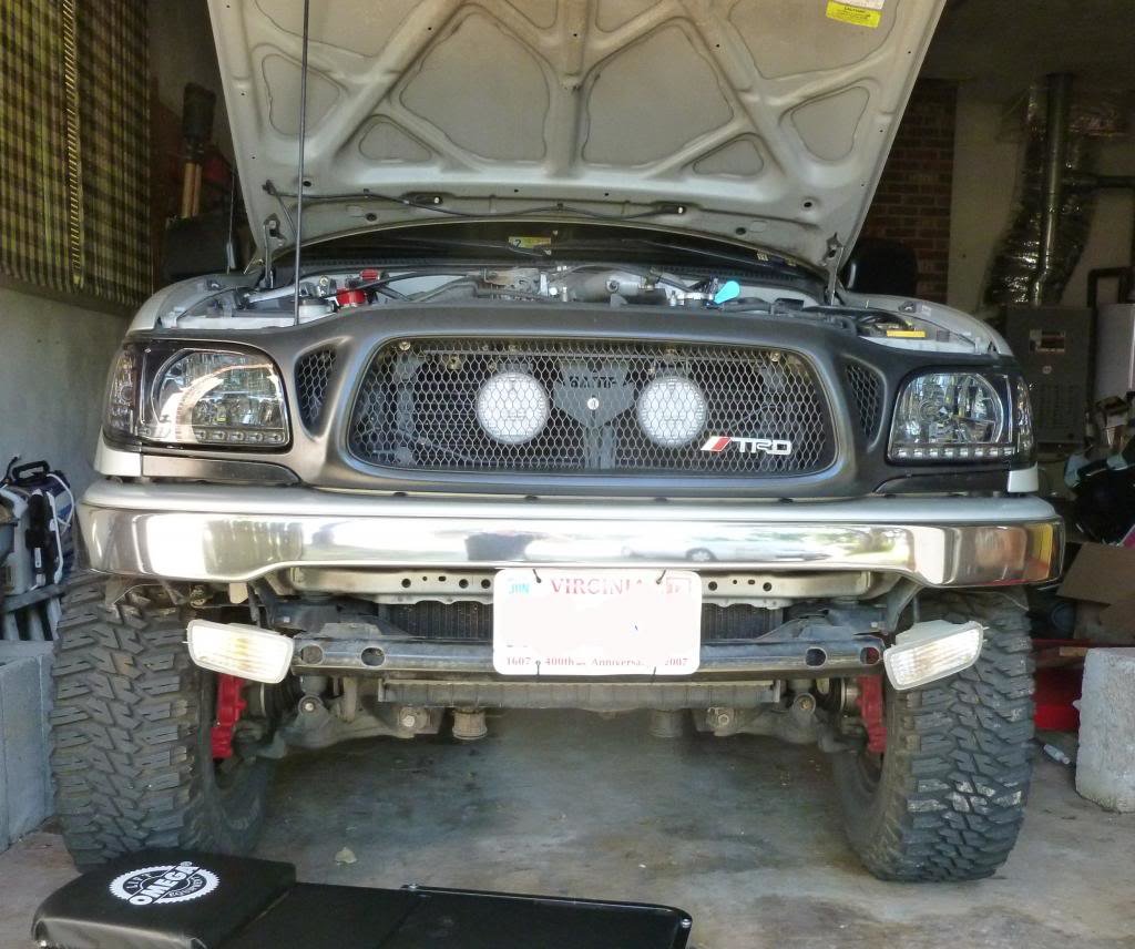

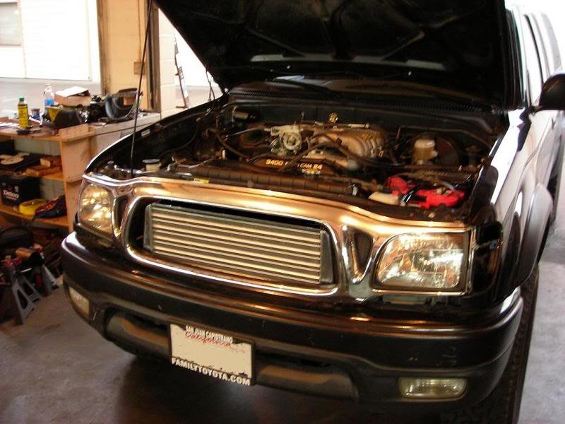

    I was thinking about the current IC mount and how that might get in the way of future bumpers. I like the lights behind the grill idea but figure I can mount shit on the bumper when I get it. So now Im thinking about doing a grill mount on the IC and get rid of those stupid lights... Something like this:
    Won't be much of a "sleeper" at that point... Probably paint a red TRD on it too :D
