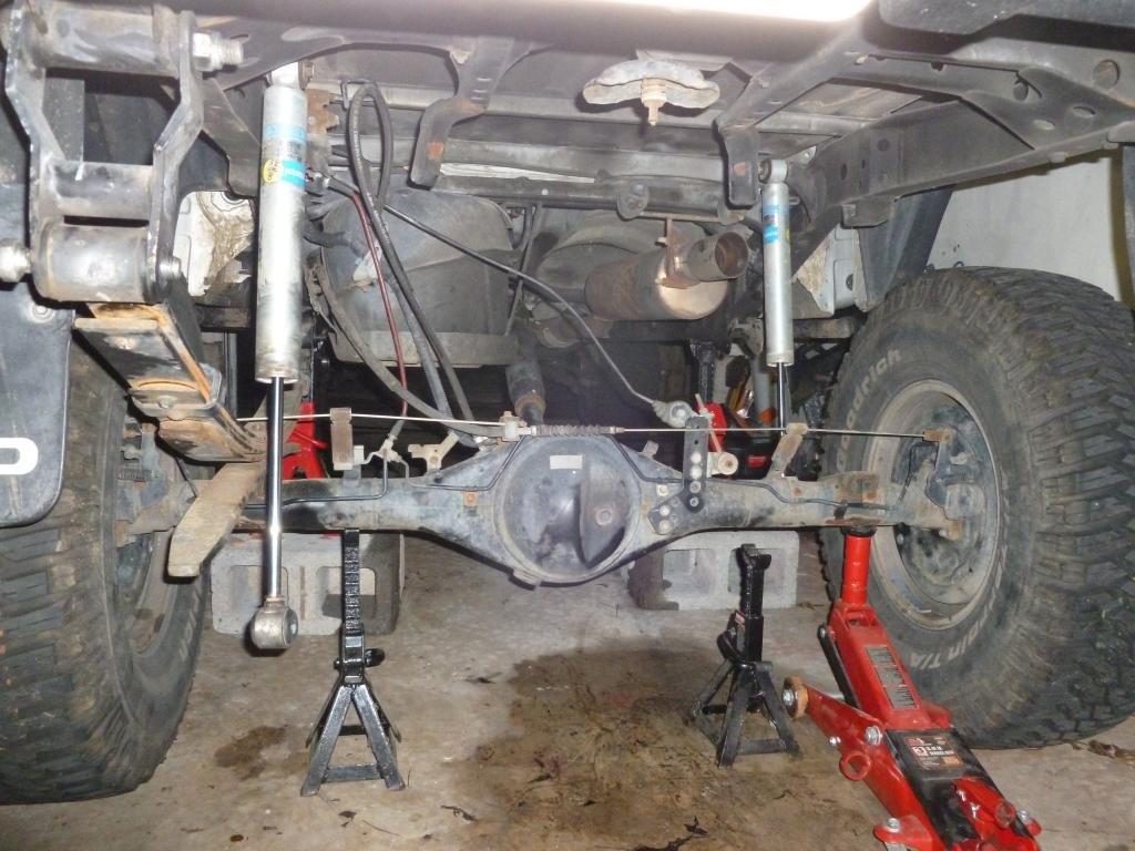

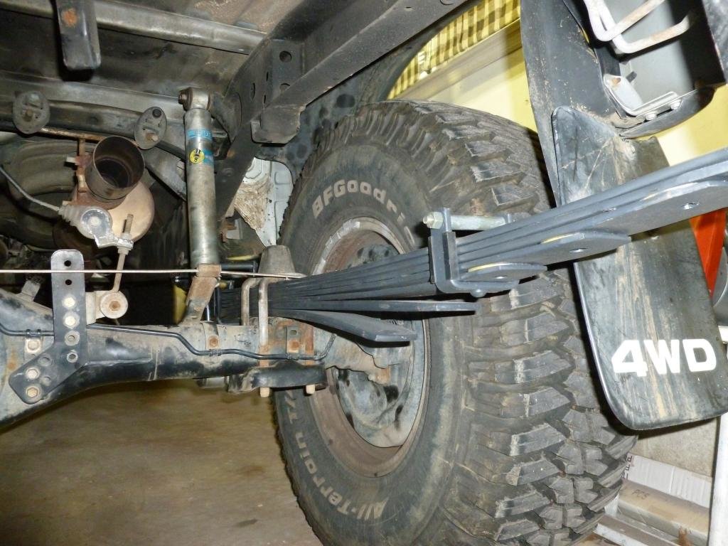

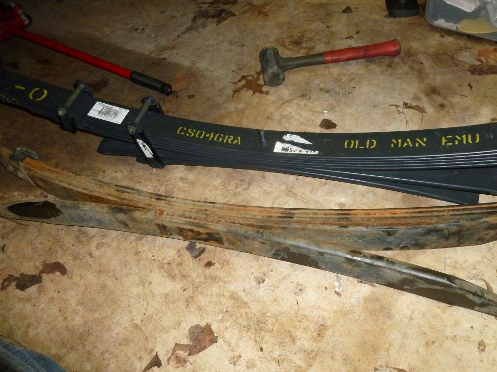

    A quick update: Finished wiring up the FIC and injectors. Initially ran like hell when i started it, turned out I didnt have the fuel tables properly configured so I was dumping in 2x's the gas needed!
    Also installed the new Old Man Emu leafs. Noticed my leaf shackles are bent, probably from the accident, so another trip to the collision center. Also have a leaky trans pan seal from the trans shop so have to take it back there too :mad:
    Leaf install:
