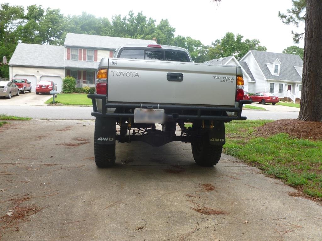

    Much needed update.
    Done messing with this IC. Im comitted to fitting an all pro baja bumper. Going to get this IC:
    http://www.amazon.com/gp/product/B00CO78JO6/ref=ox_sc_sfl_title_2?ie=UTF8&psc=1&smid=A2ZDMPK9MICO93
    Some suspension work:
    Added the 1/4" trim spacer on the driver side to fix the taco lean.

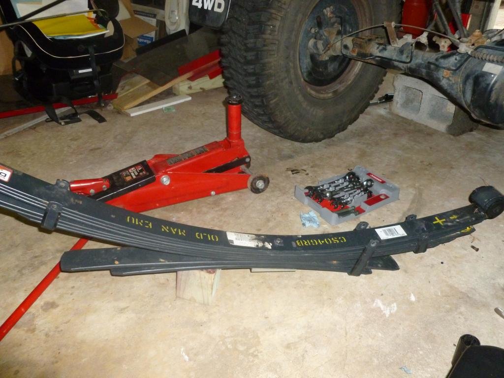

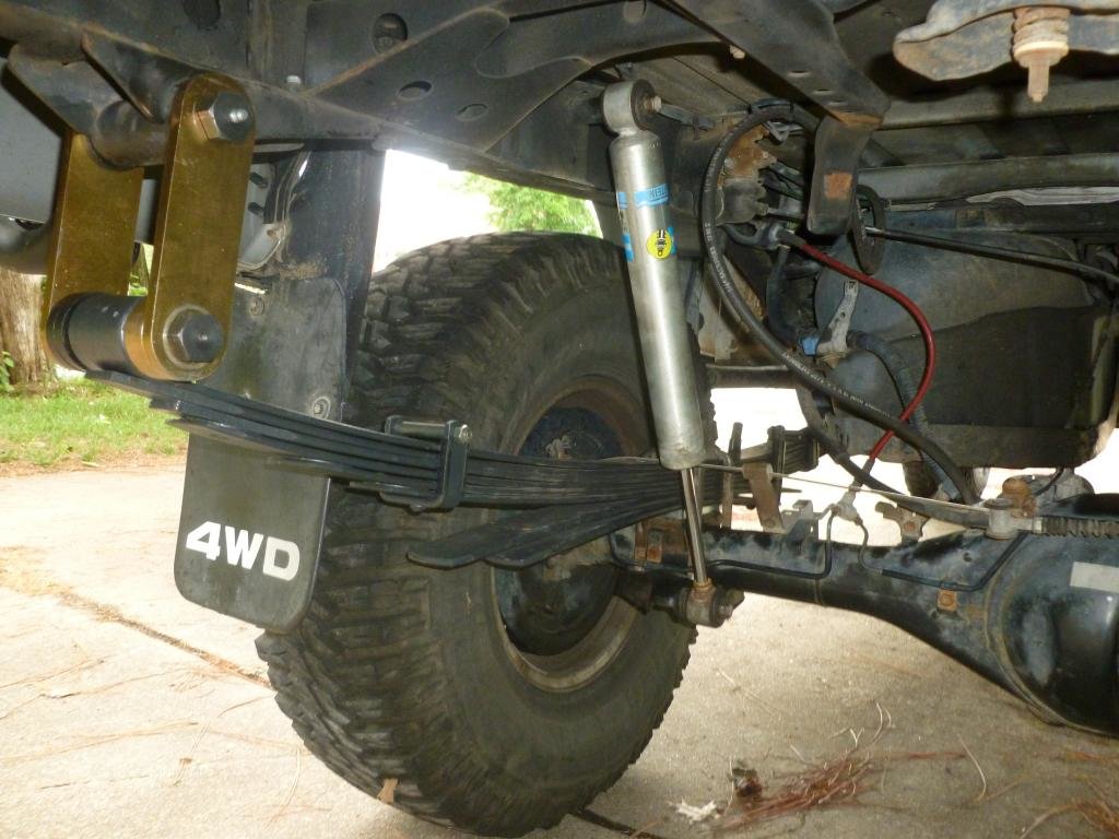

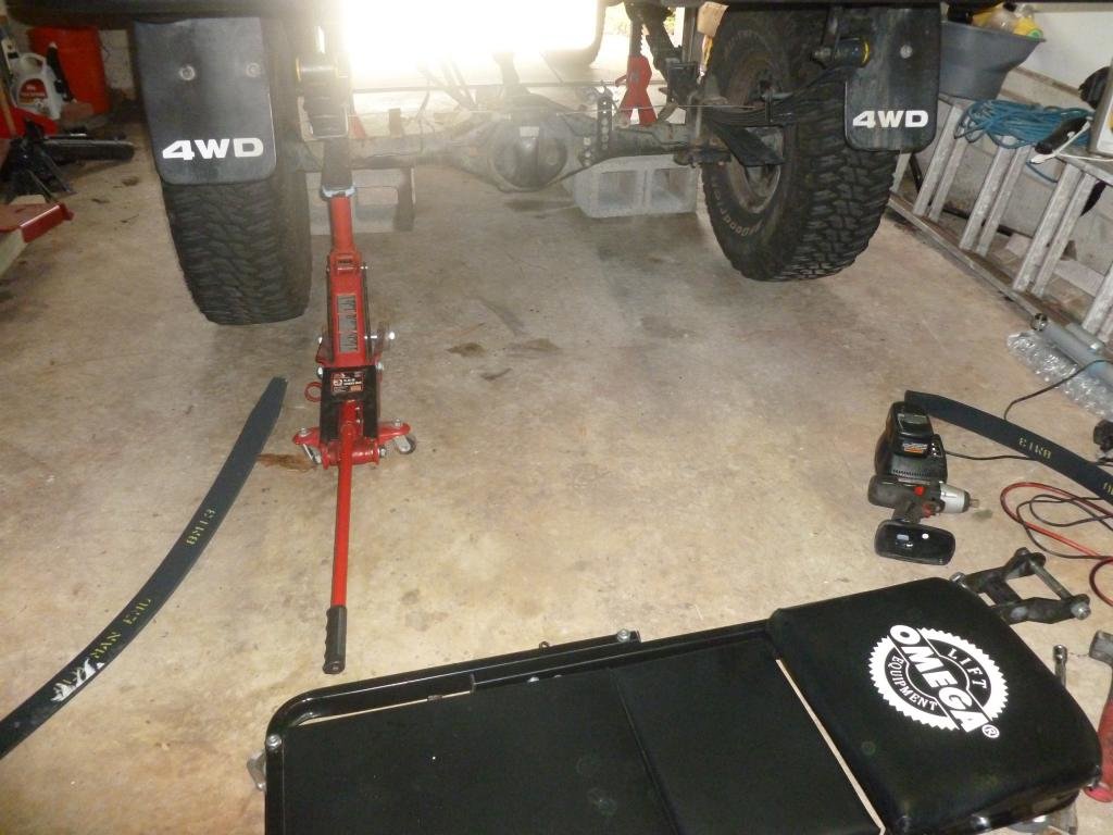

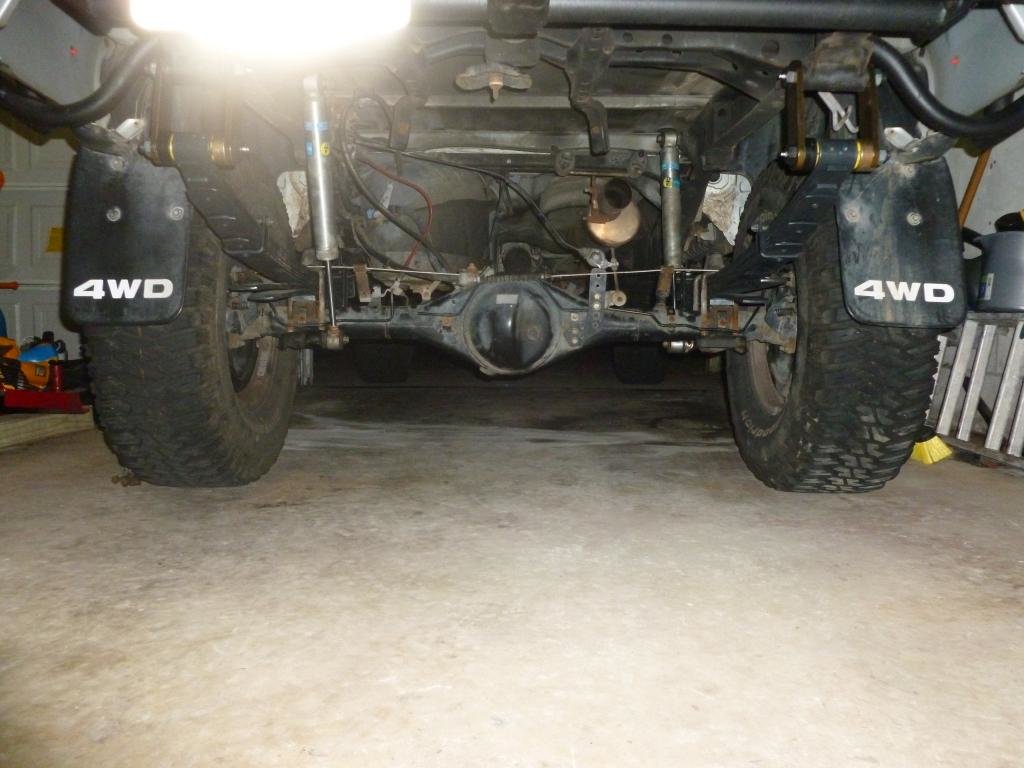

    Didn't like how soft the OME's were and planned on some extra weight in the back anyways so when ahead and installed some OME AAL's and some 3* axlr trim tabs. Also noticed the Daystar shackles bent when I did my power slide off the highway all those months ago. Replaced them with some Trail Gear shackles (beafy). Truck has a noticable rake despite the shorter shackles but it should settle.

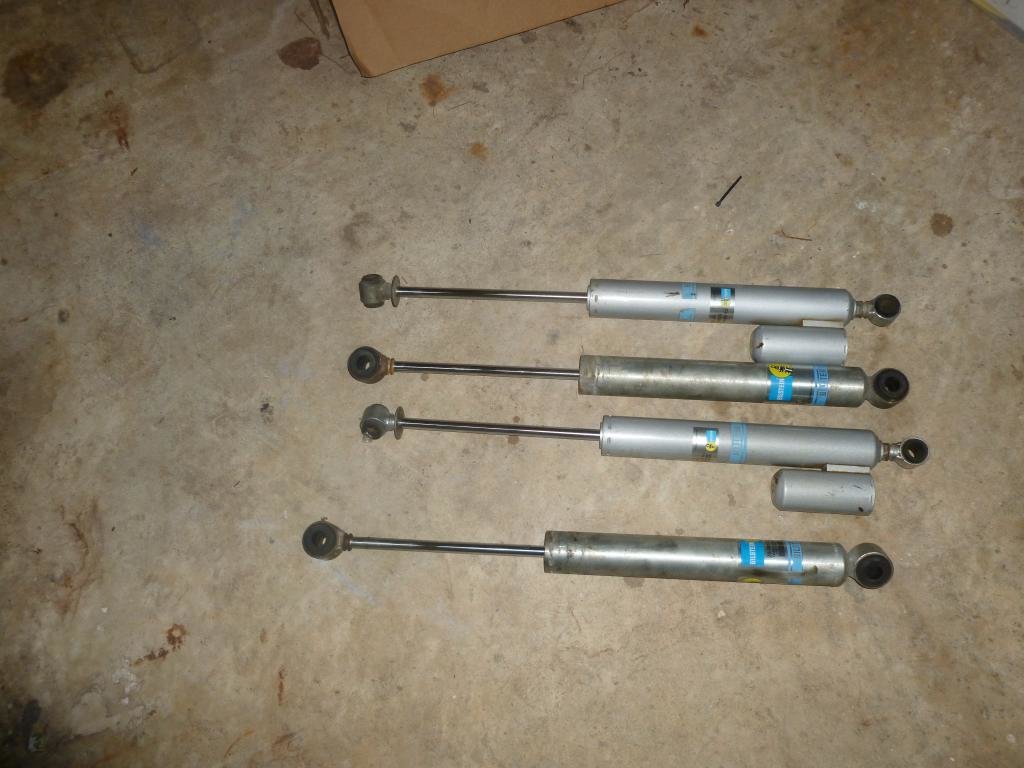

    Also have some 5150's for the shock relocation.

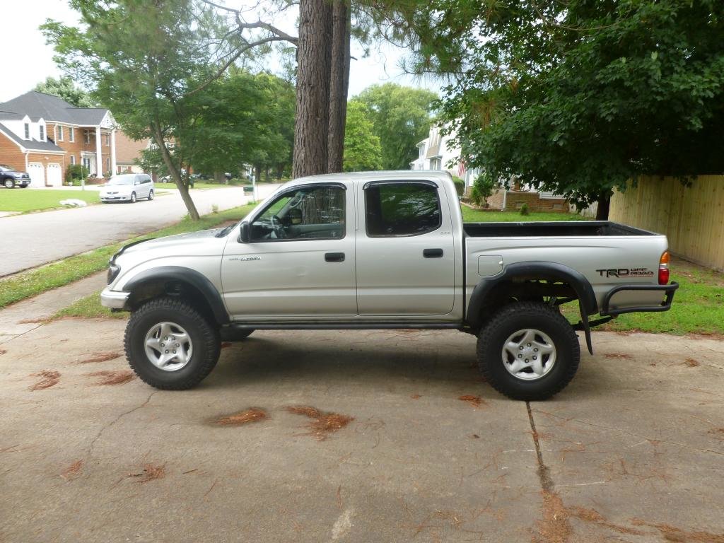

    A few more pics. The slopped drive way doesnt help with the rake...
    c74e505b-d639-47ec-90f2-fe837cf006da_zps_a7f908dac0c804f46ad5b8ef0321a0d2c20255b0.jpg

    Its comming. Just need to figure out the IC. I was hoping to get more work done this weekend but had to fix an oil leak and figure out an overheating problem with the Tercel. Oil leak is fixed and waiting for a new thermostat to fix the overheating.

    Thats the way my taco looked after i put my allpro leaf pack on my tacoma a few things of tube sand in the back should help with settling the springs and will make it ride MUCH nicer!
