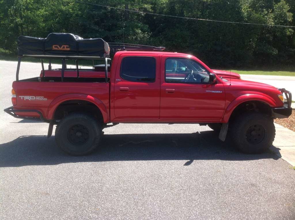

    Damn, I hope they settle. I didnt like how the OME's rode until I put the AAL in. I like my rear a little on the stiff side.

    Agreed, no one likes a saggy rear!

    Nope. But dont like my ass in the air either. Once i get the frame boxed and spare tire mounted, should be at ~100-150 extra pounds in the back. Not quite the recomended 200+ lbs OME recomends but should help the leafs settle a bit.

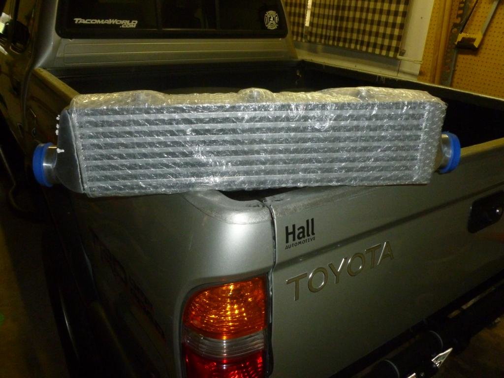

    FYI on the turbo build. Im ready to go, just underbudgeted about $500-$1000. I forgot to budget the exhaust. Time to save...

    So you figured out the IC mounting?

    Yup.
    (minor cutting will be required)
