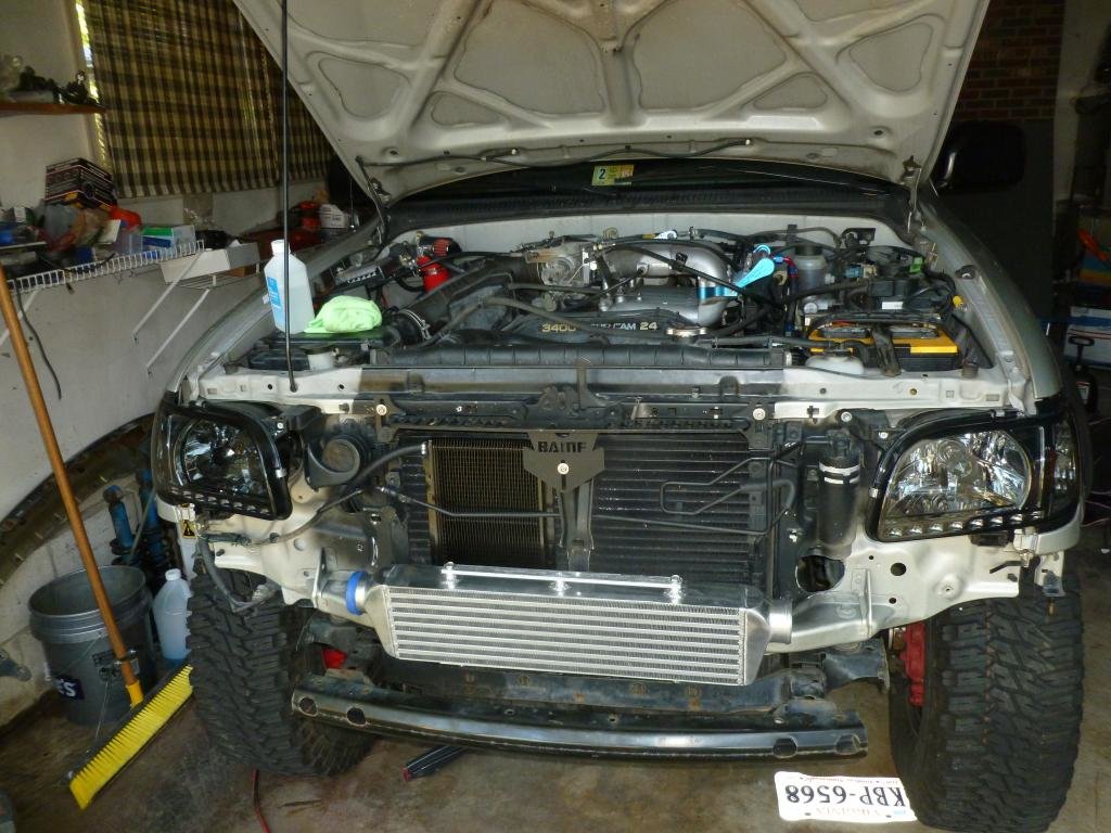

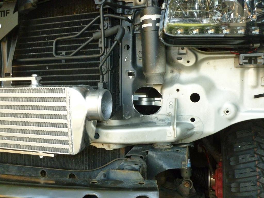

    IC lower mount complete. Not sure how Im going to do the upper yet:
    The drilled died by the time I finnished the first hole. I also mounted the oil relocate... didnt think it through though :facepalm: Going to remount on the frame.

  12. Aug 29, 2014 at 3:56 PM

    You should change out your break fluid before that mess clogs up your master cylinder. Mine was the same color and I ended up having to replace the calipers, lines and MC.
    It's super easy to drain and refill.
    That IC setup looks clean man.

    Finnished the second hole and just buttoned it all up and everything fits perfect (with stock bumper). The top tether is adjustable to change the angle and position of the IC so Im pretty happy how it worked up.
    The brake fluid is pretty new (less than 30k). Must be the camera, isn't that black in person (did a flush when I installed the Tundra brakes.
    Not sure yet. It will be tight but I think it might work :cool:

  15. Aug 29, 2014 at 6:35 PM
    #435
    Blackdawg
    Blackdawg Dr. Frankenstein
    Dec 31, 2010
    #48500
    81,618
    Monte
    Wyoming/St. Louis
    The Trifecta of Taco's
    Bumper style will make a difference....but from what I have seen..I doubt it.

    I cut down the center beam and have about a half inch to shift the IC back. I have about 1" up and down and .5" back adjustment :notsure: but yeah, will depend on the bumper...

    Looking good. I have that exact intercooler style. They just magically fit in that spot very nicely. I did flip my up just because I already have a tube bumper that would not allow me to run mine low like yours. Clean hole saw. Mine is a pretty ugly sawzall just because I needed a silicone coupling instead of tubing to go through and didn't want to slice the coupling in half on the core support.

    I wonder if the bumper will limit the air exposure to the IC pretty drastically

    Probably will. Ive been thinking on some fans but will have to see how much space with the bumper. I think the first step is to just get this damn thing installed :D
