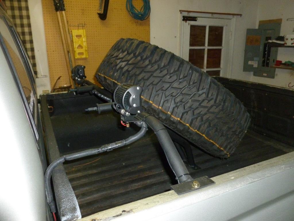

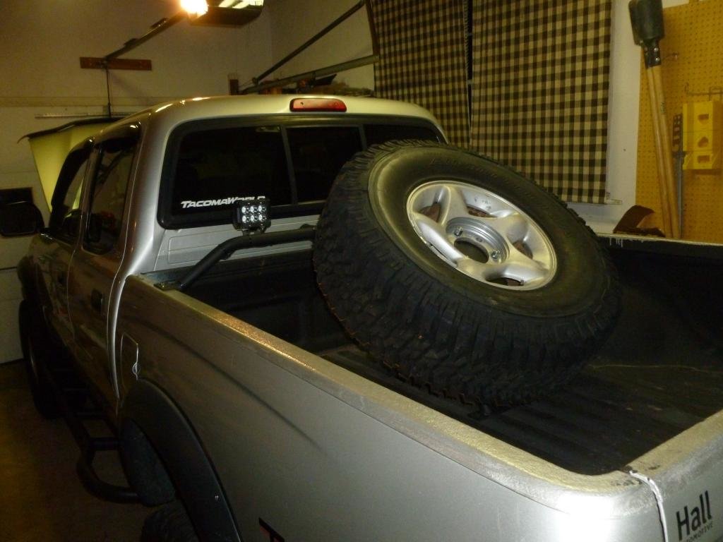

    New SOS Concepts Tire Carrier:
    Eddy is highly recomended.

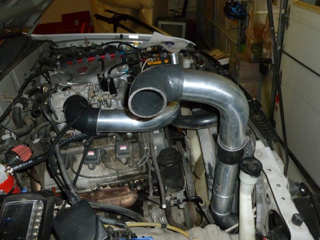

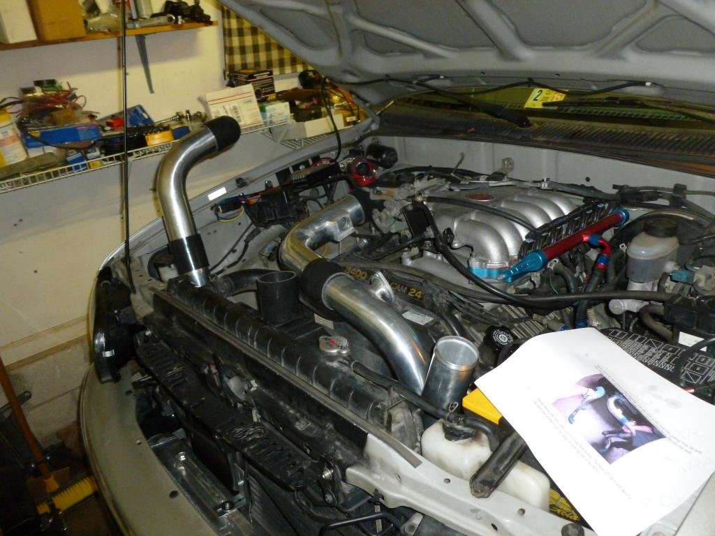

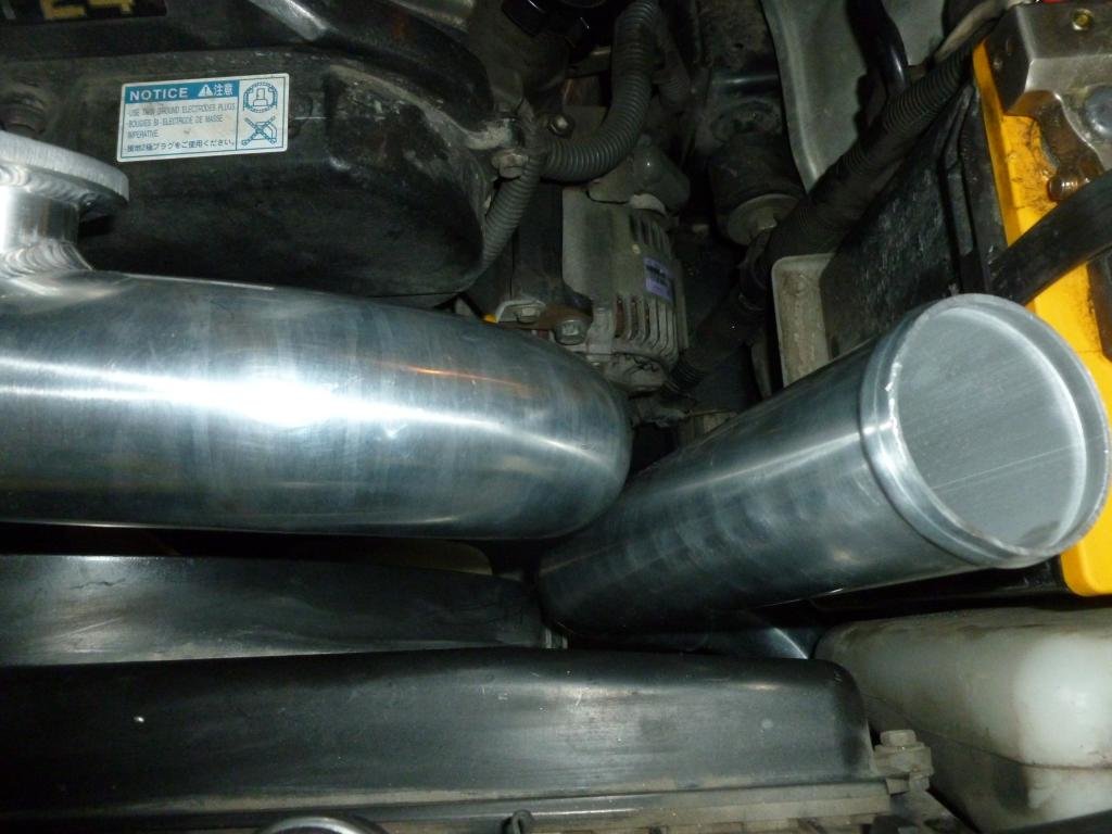

    Did some IC pipe fitting. Serious cutting is needed:

    :woot: pipe work finally!
    It gonna work out or gonna need some custom work?
    Also why not put the tire carrier closer to the cab?

    The high lift mounts between the carrier and cab. This was as close as I could get it and comfortably remove the lift.

    Oh nice I see it now. Very cool

    Not a lot of room for the pipes huh? Good to see progress.:) Which side is the input of the IC?

    No, its tight. The input is on the passenger. I can get the driver side measured and cut down now but Ill need the turbo mounted to get final measurements on the passenger side.

    Is the turbo going to be hard mounted or just connected and supported by the pipes?
    3" pipe doesn't give a lot of room for mounts and smooth bends. Good luck.

    Connected to the headers.
