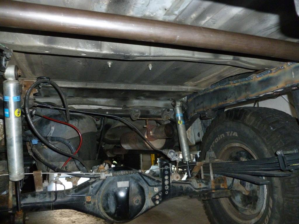

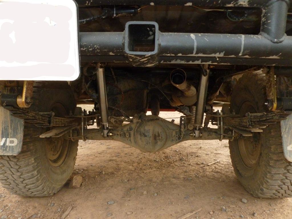

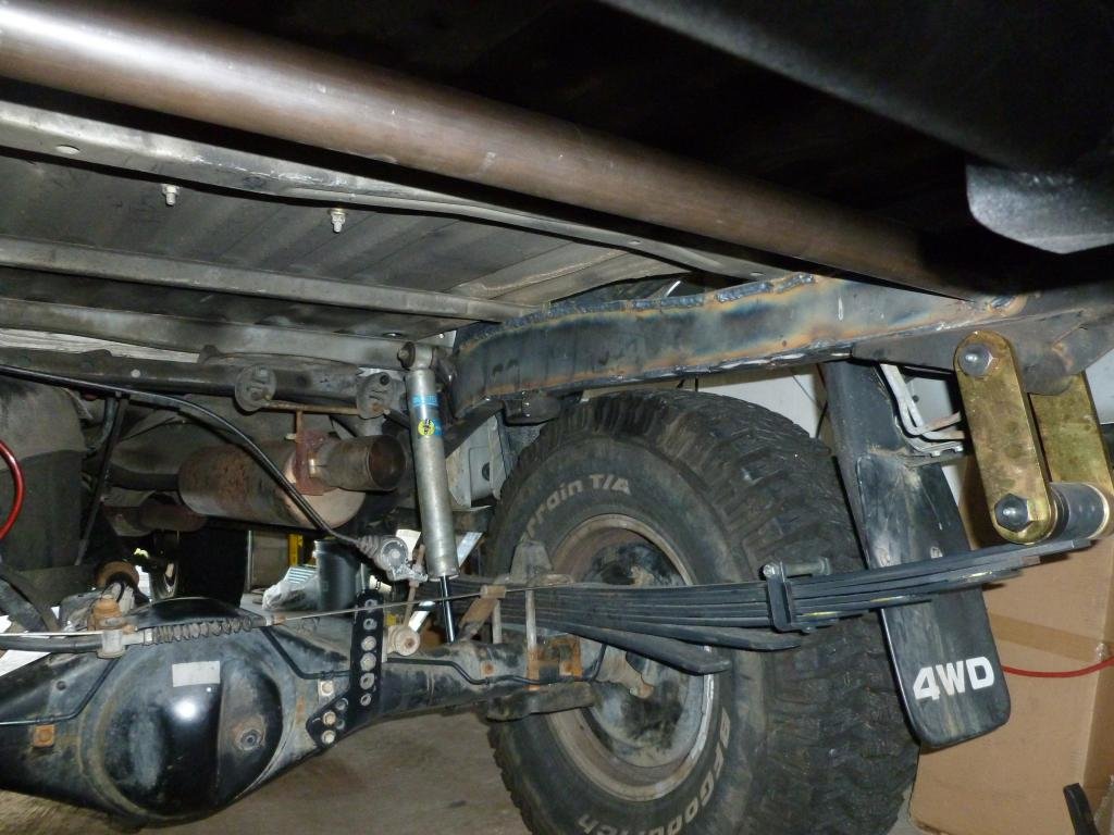

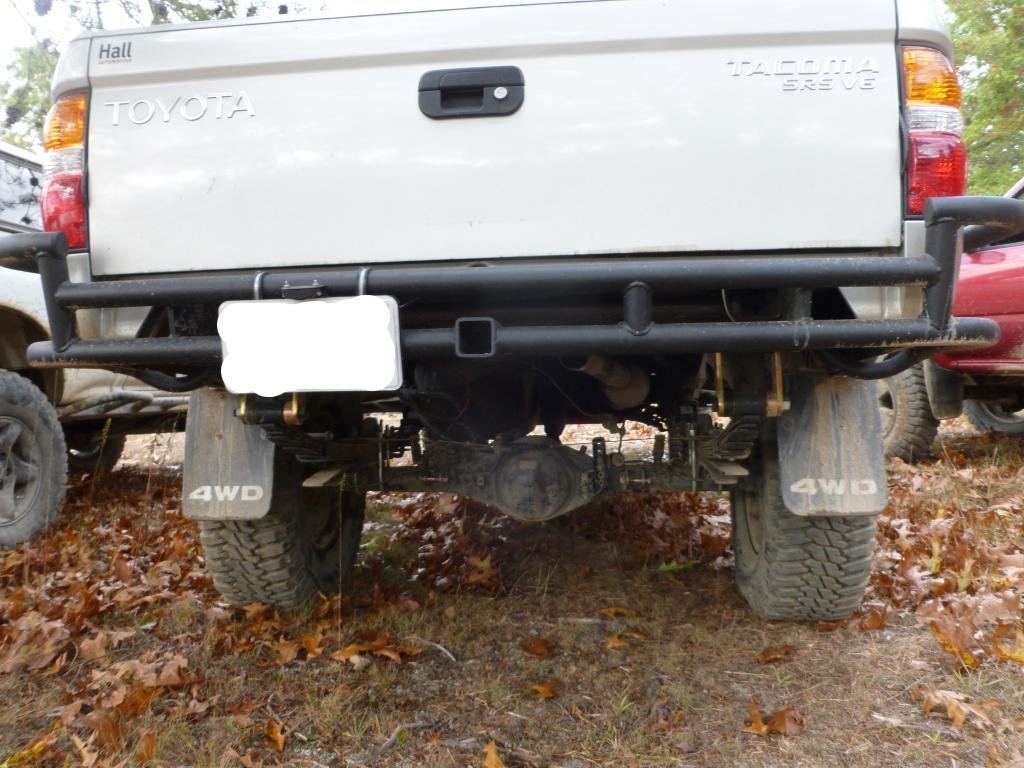

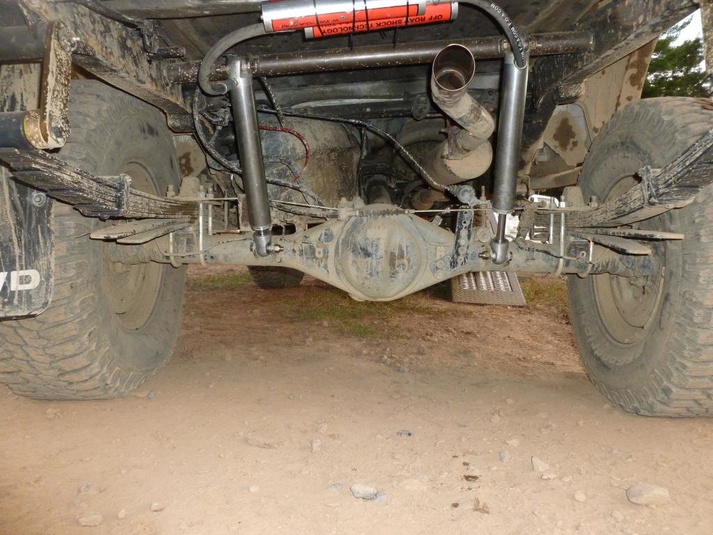

    Long needed update. Did some side tracking and did some rear suspension work.
    I welded in the rear box plates (Trail Gear kit). I left the stock mounting intact as I didnt have time to get the shock relocation done. I had to take a trip to San Diego for work so dropped of the truck to get the rear shocks done at a shop in time for the Big Dogs meet.
    Unfortunately the shop, which did a good job on ponethousand's (Paul) truck didnt take time to measure everything out. They left about 1" of uptravel for the shocks. I had to run Big Dogs without any shocks. Not recommended
    Pics:
    Rear frame plates. Dont mind the welds.
    New rear shocks mounted... :facepalm:
    Total flex with new shock mounts... :(
    (I zip tied them back on after wheeling)

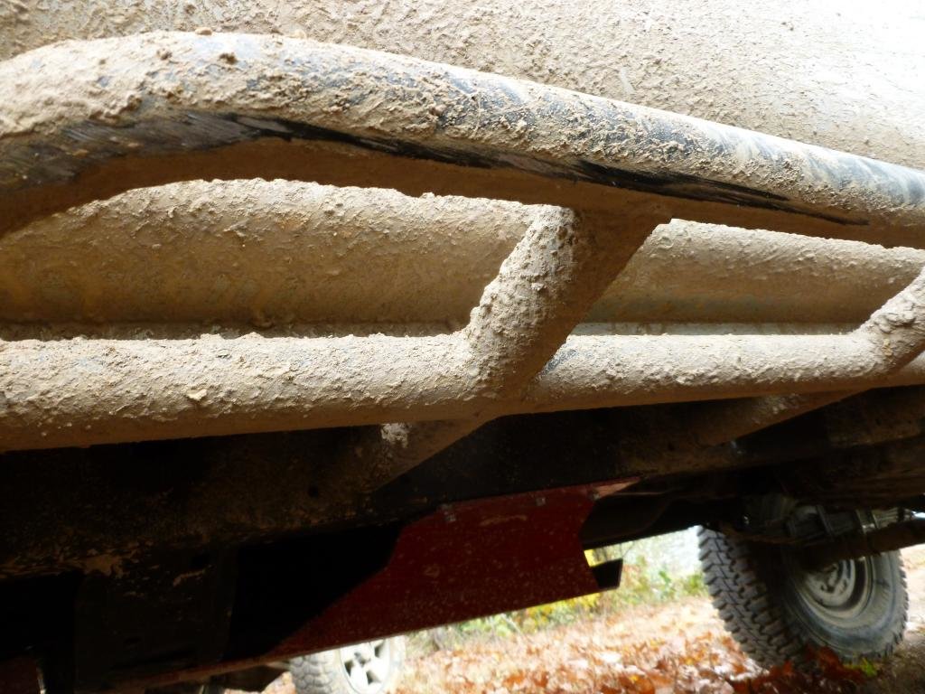

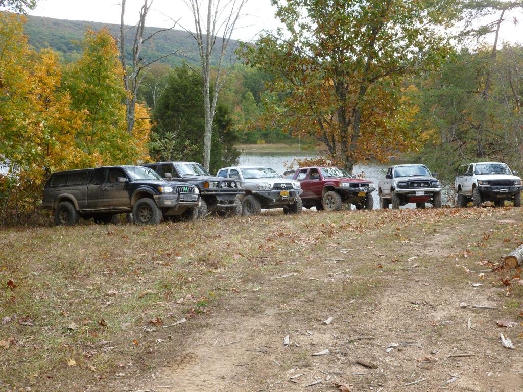

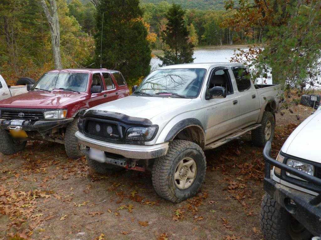

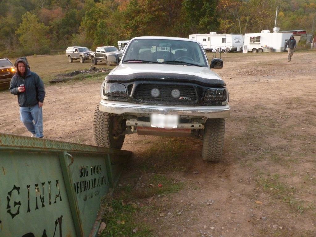

    Finished about 4 hours of trail riding at the Big Dog's meet. Did the med to hard trails. Rocks where a challenge but the trees were brutal at times:
    No shocks... :cool:

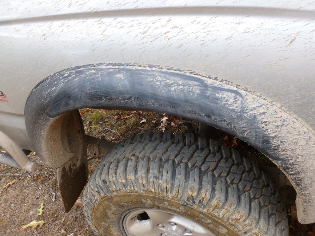

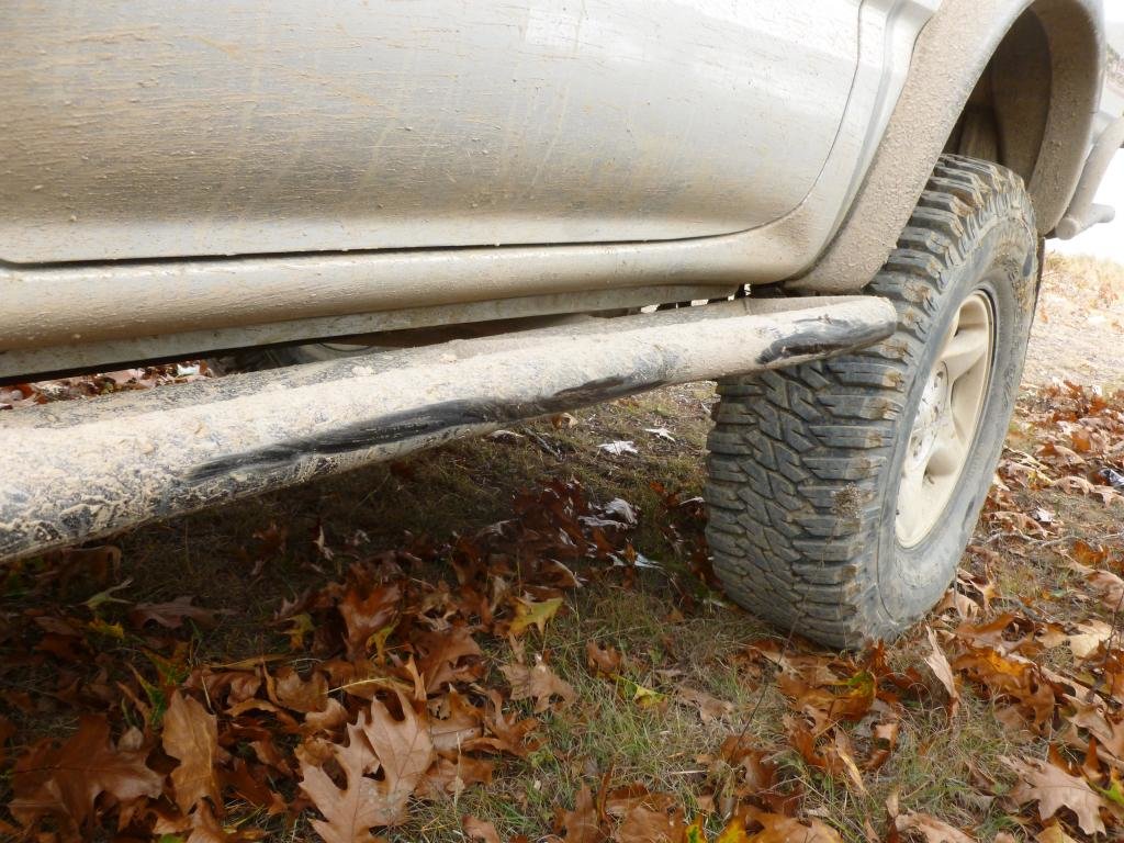

    Some minor trail damage:
    Trees got a little close...
    Trees got very close...

    Good thing you had all that protection! :eek:

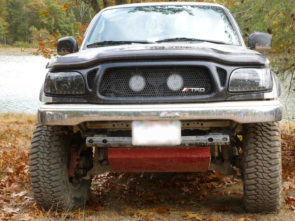

    I was surprised how little I used my skids but damn those slides came in handy! There were a few rock and trees where I didnt even try to missed. Just lined the sliders up and let them do the work.

    Those shocks look way way to big to be mounted in that setup to begin with
  18. Oct 5, 2014 at 5:51 PM

    Probably.... Clint and I were discussing that this weekend. There is a bit more adjustment available in how he mounted the cross bar but I may have to go down a size. At the stock mount they were too short by 1/4" :confused:
    They def need to be moved back to open the angle up a bit. They keep catching the e-brake cable causing my rear tires to lock up when I hit a big bump. Should have seen my wheel hoping at 65mph on 664 headed home last night :eek:
