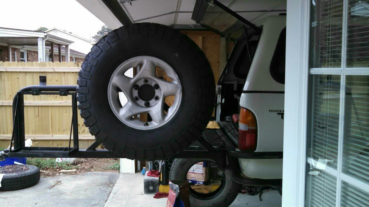

    From cdj1's build, Id like to try and make something like this:

    judging from his pics and description his swingout uses a single shear spindle and cdj1's is a double shear.
    You may be better off just building one from scratch.

    Just remember my bumper has plate welded between the tubes to support the extra weight/loading...

    That bracket might be hard to attach as is, but figured I could cut it up a bit and weld on...
    Or just get this and do the top/bottom bracket Clint has: http://www.comp4x4.com/Tire-Carrier-Hinge-Kit-HEAVY-DUTY-1-3-4-Spindle.html
    On the to-do list :thumbsup:

    The tio and bottom bracket will be easier to incorporate into the TG bumper. I ha e seen the bumper a few times and looked at how to do it. It would not wrk well with a big single shear spindle which that double shear you post basically is just with the top bracket. You couldn't get it in good enough without some major modifications done to the bumper.
    The double shear with the flat bracket would be easy to do though. As Clint has done. Add some plate or box tube and make it flat.
    My only beef is it'll make the swingout stick out a bit..but when I built the one I id I made everything as tight to the truck as possible.
    Should have a write on that soon too

    Yeah, didnt see the double sheer spindles at first :eek:
    I'll have to check your's out. I think the way Clint did his, it could have been a little tighter and even a bit higher but I don't think he has any clearance issues.
