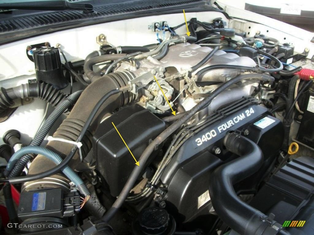

    I have two hoses that connect down stream of the TB; "vent line to the atmospheric side of the fuel pressure regulator diaphragm" and "filtered air source for charcoal canister system." Not sure where to hook these up; can I just put a filter on these? Otherwise may get some fittigns to weld into the pipe b/t the filter and turbo.

    Like already said the brake booster already has a check valve, so only 2 (I think) lines need check valves plus the PCV which you already have taken care of. They aren't super duper important if you aren't drag-racing right away so you don't have to let that delay the turbo install till they come in. Your booster line should be on the far driver side of the intake mani which shouldn't need messing with at all. In regards to all the post filter/pre TB hoses, I just tee'd them all together (excluding FPR hose) and hooked that single hose up to the 3" intake elbow with a single 10mm nipple that is right before my turbo/after filter. You can see it on my thread pics.
