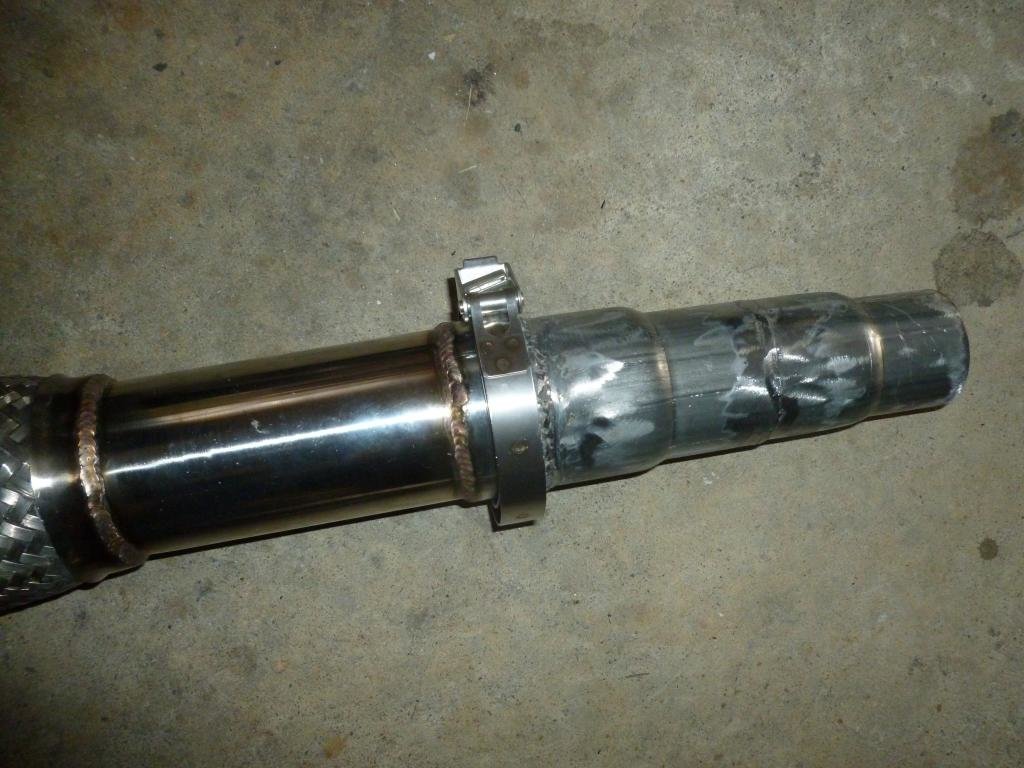

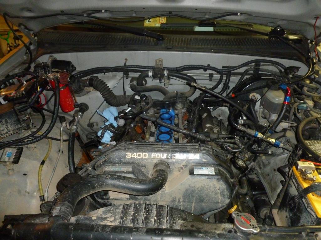

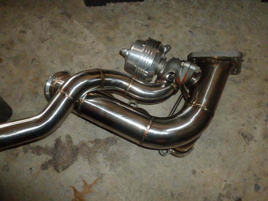

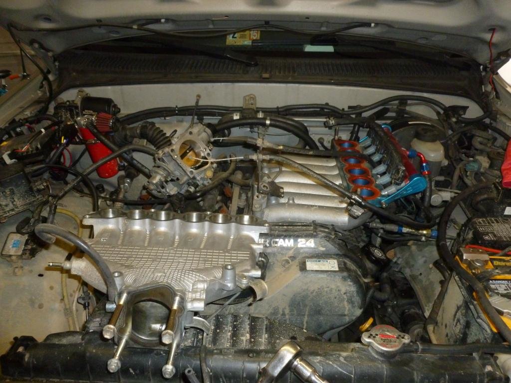

    FedEx came today but I didn't hear them knock at first. They left a card for a package and I knew exactly what it was. Ran them down and got my turbo :yay:
    Did some work today. Got the driver side valve cover gasket done and working on the passenger side. Got all bolts and nuts off the exhaust and manifolds but one. Ill have to cut the cross over pipe; that will have to wait for Monday.
    Some damage done today. Didn't have much time for camera work but here's what I got (forgot to get turbo pics but its noticeably smaller than the last one)
    Down pipe with 3" to 2.25" adapters and a shit weld job :facepalm: For 7$ good enough to get me to a shop for a nice 3" setup.
    Got the wastegate mounted up. Didn't even bother with the shit gaskets; used the Cu based high temp FIPG.
    Getting the FIPG off the URD port injector took entirely too much time. I put way too much on it when I installed; going to have to be careful this time.
    How it sits now:
