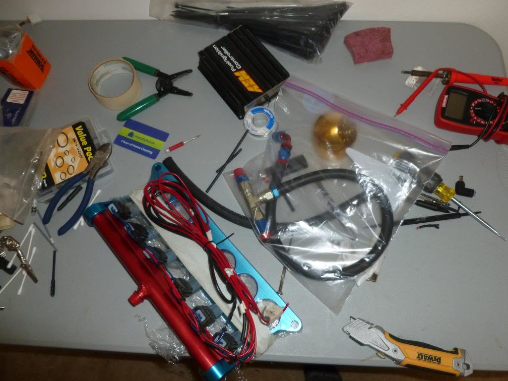

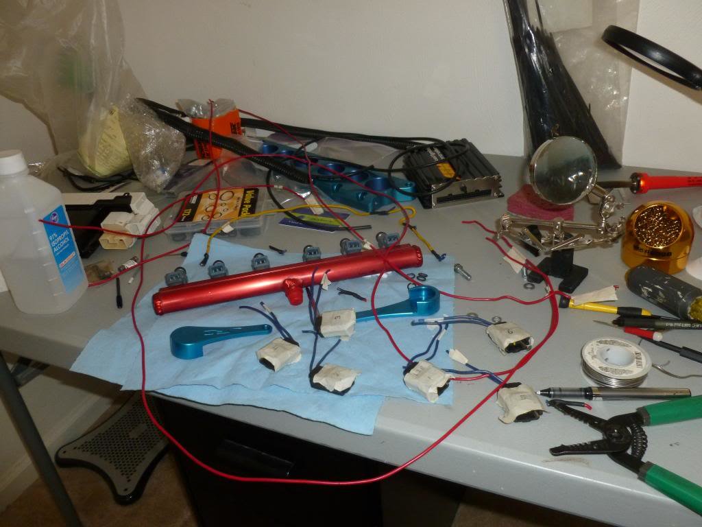

    Today did some work on the injectors/URD Port Fueler. Came for the previous owner wired already, however not very well. Im not going to say what it looked like, but it rhymes with smis-mortion.
    Started with cleaning the injectors and port fueler (lots of grime/dirt) and finished with wiring the injectors.
    Everything cut up and ready for new wiring (no pics or original wiring, camera was still charging when I started. It was basically a lot of electrical tape and rats nest of wires):

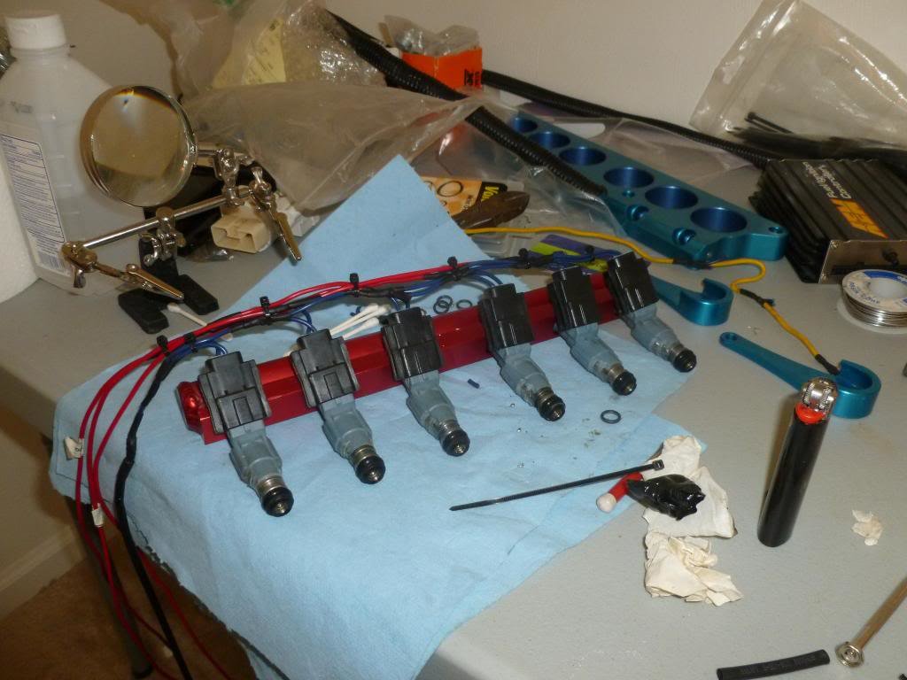

    Wiring complete. I hate soldering and heatshrinking. I usually f it up but this time everything went ok.
    Ready for install (plastic wrap to keep the ports clean):

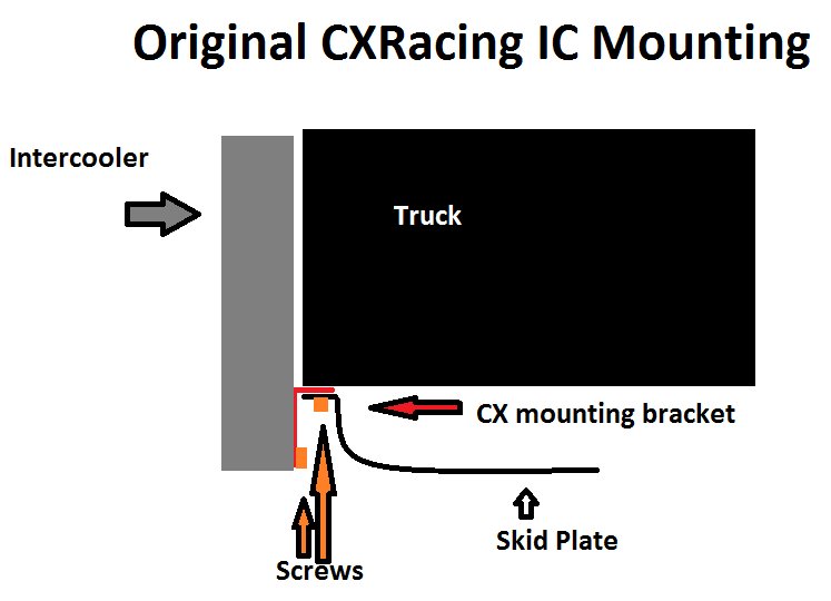

    Def will have a in depthreview on the kit and fitment. Heard that the cross over pipe doesnt alwaysfit/match. Not sure why not; it has a flex hose in the middle. Measurementswill have to be WAY off for it to not fit right I would think.
    The stock IC is HUGE anda rock hazard for offroaders:
    My "MSPaint" rendition:
    I needed to mod the mounting bracket to fit the IC i picked (same length but much shorter). The original intercoolerhad screw holes on the side and the new IC has holes on the bottom. I flipped the original bracket over to stick up instead of down, then bent downthe mounting bar 90 degrees and re drilled two holes to match the new IC mounting. Goingto mount something like this (MSPaint FTMFW):
    Im at work but will get thebracket pic up this afternoon for a better visual.

    so bye bye aftermarket bumpers too then. was wondering how they fit the IC on there.. cool.

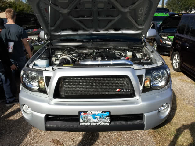

    if i was to do it id get a super small one to fit behind the gril and satoshi it. Take more creative piping but..could work

    I did the Satoshi conversion and I thought about it...
    Still thinking...
    This is about how it will be mounted, just a bit wider, and mounted about 1-2in higher with the step-up.
    You dont think Ill be able to fit a front bumper?
  20. Feb 21, 2014 at 2:01 PM

    hmmm...looks tight..i think it would hit the winch mount plate area of the bumper though..
