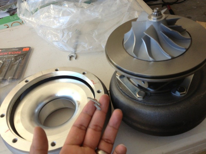

    Yeah, on a 7000+rpm Supra with boost turned up, china turbo's tend to do that. It looks like the waste gate was either set too high or defective. You can hear the turbo max out and probably had some on-compression surge. Probably some users error in that video as well.

    One thing that i have seen on a few Chinese turbos, journal bearing, was that people had to pull apart the turbos before installing them. There would be large shavings inside the bearing housing.
    I believe that Redlantern found some in his as well. Turbo'd 1GR.

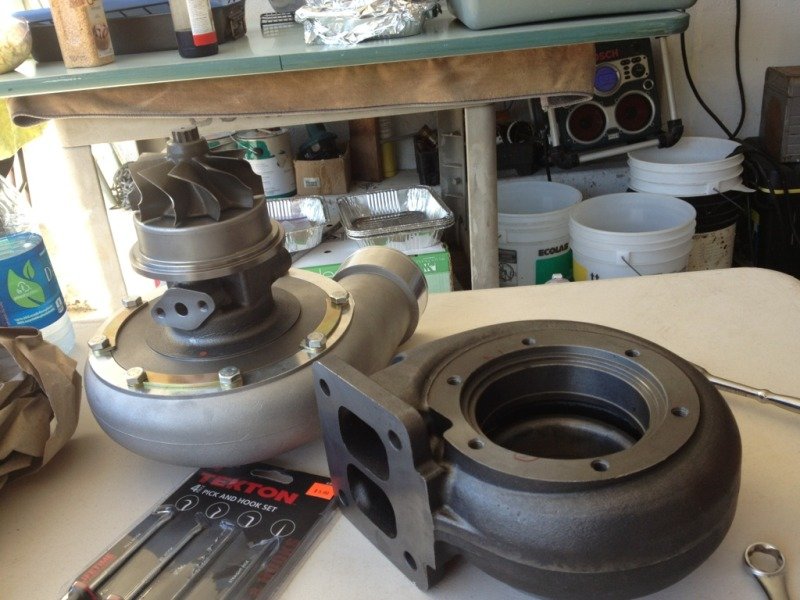

    I pulled mine apart and inspected everything. Looked good to me :notsure:
    But I have heard that (which is why I pulled it apart :p)

    Yup. Here it is. A common problem, it seems, while searching the internet. Could have played a factor in the 2JZ YouTube video. That, or a number of other things.
