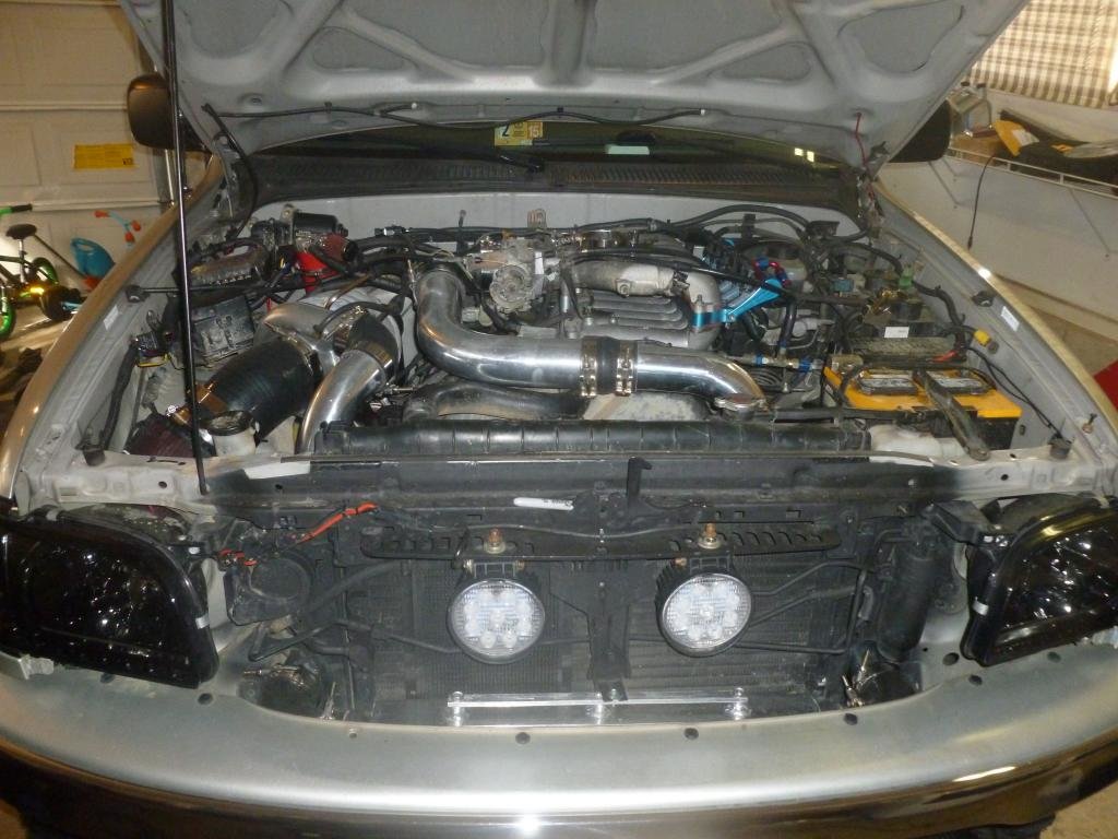

    Need some troubleshooting help.
    When I picked it up from Production Offroad, had some bad idle, AFR's were high, etc...
    On the way home, had some issues:
    -Trans would launch in 2nd
    -Trans lockup clutch wouldn't engage
    -When it got stuck in 2nd gear at initial launch, the engine temp gauge would go squirrely and rise and lower with the engine speed. Once the trans shifted, the temp gauge would read correctly.
    Got the engine codes read and had a bunch of shift solenoid codes and P1135 (A/F sensor) code.
    I took the FIC unit off and that fixed the trans shifting for the most part. I had two instances; once the trans wouldn't go into reverse and the other the trans was in limp mode again. I also checked the dip stick and the fluid was ridiculously high. But both instances, shutting off the engine and restarting fixed the shift and today while the truck was running, the fluid level was perfect.
    The P1135 didn't go away so I ordered a new A/F sensor. Initially the engine ran ok when I installed the new sensor but now I get the P1135 code again, rough idle, and 17-19 AFR's...
    I'm thinking bad ECU but open to suggestions as well.

    This might be overly redundant, but have you disconnected the battery yet?

    Yes. Engine light comes right back on...

    I think you have a leak somewhere on the intake.

    Ya, sounds like a vacuum leak to me....

    Yep. And with the AFRs reading that high. I'd say a big one. Like forgotten hose.

    Ya, definitely running rich! After you figure it out you may wanna check your plugs, just a thought....

    No he is running very lean. Not rich. Haha
    The leak is post MAF. so it's not adding enough fuel because it doesn't know there is more air then it's reading.
