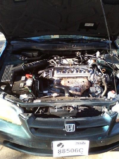

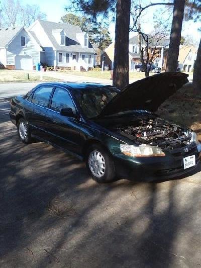

    Haha, chill, I just put him on *ignore* for now. Don't need this thread going stupid.
    The shop just welded some rear shock mounts afaik. I'll get to the truck Friday; just found out I start work Monday :woot:
    For now, got some work to do on the new car (of course); O2 sensors, spark plugs, and brake pads should put me back in business.

    U Should boost the Honda too. Haha
