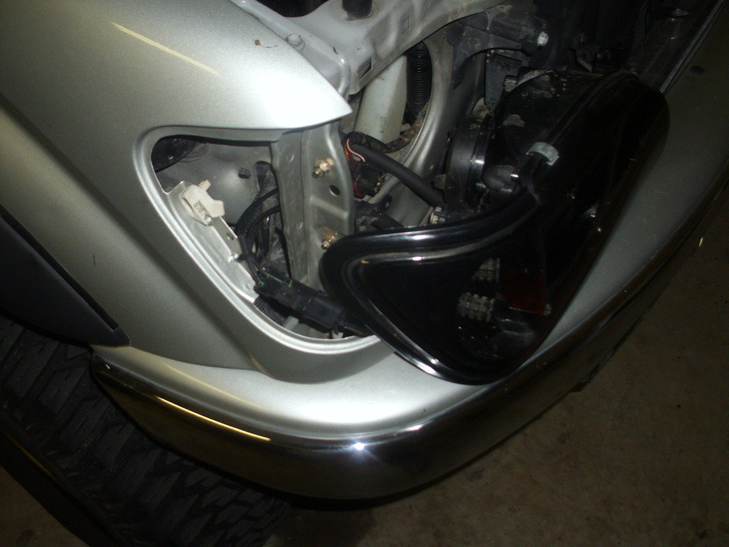

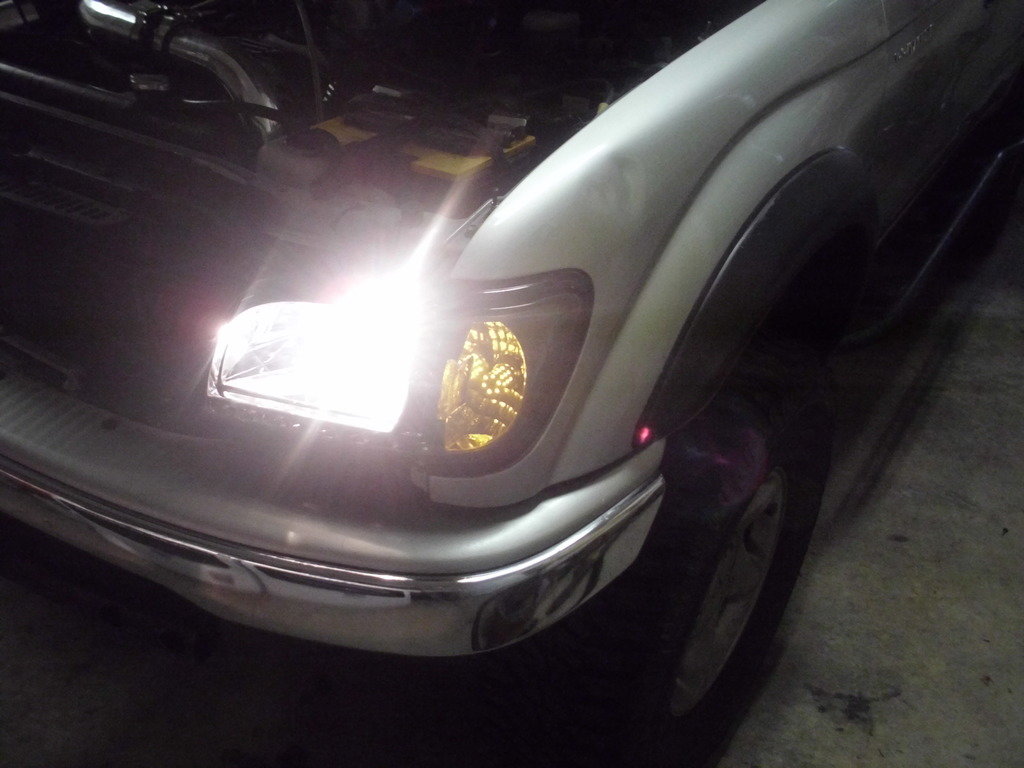

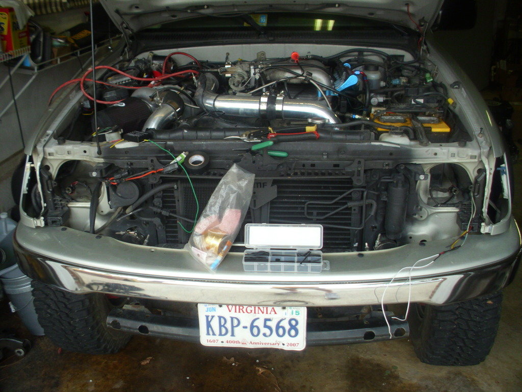

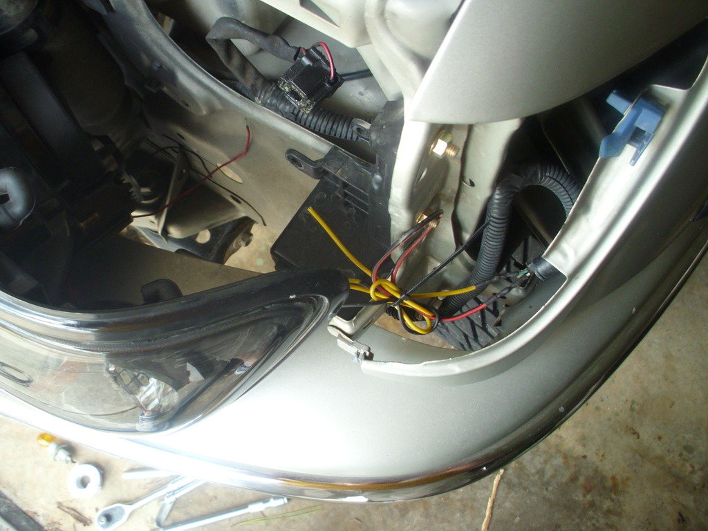

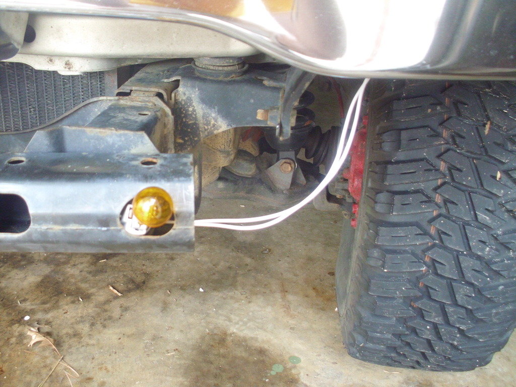

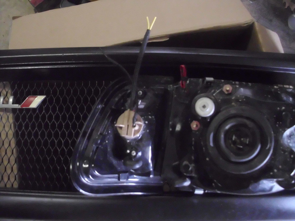

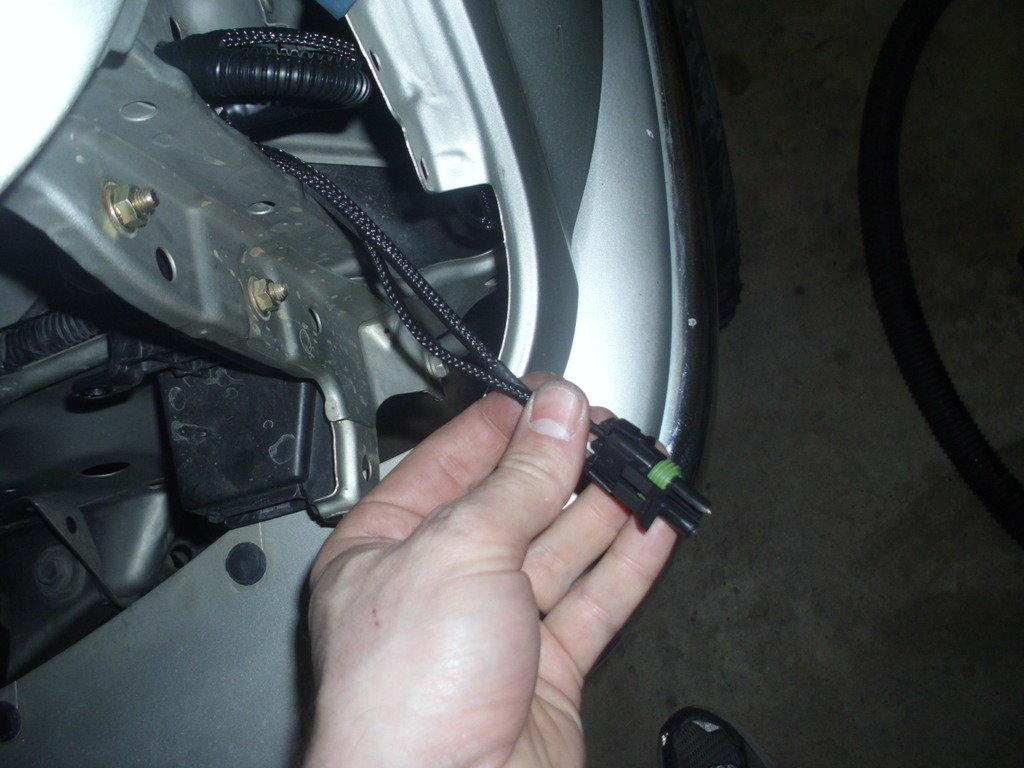

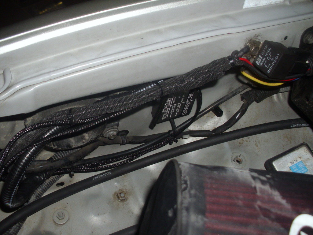

    Busy as hell with new job. Got a few minutes a day into redoing the wiring. Originally pieced some shit together to pass inspection...
    Got some wire braid and quick disconnects and a 3 to 2 wire relay. Wired it so the corners come on with the parking light but will flash if the turn signal is on.
    Getting the truck ready for Big Dogs Ice Breaker on the 25th :woot:
