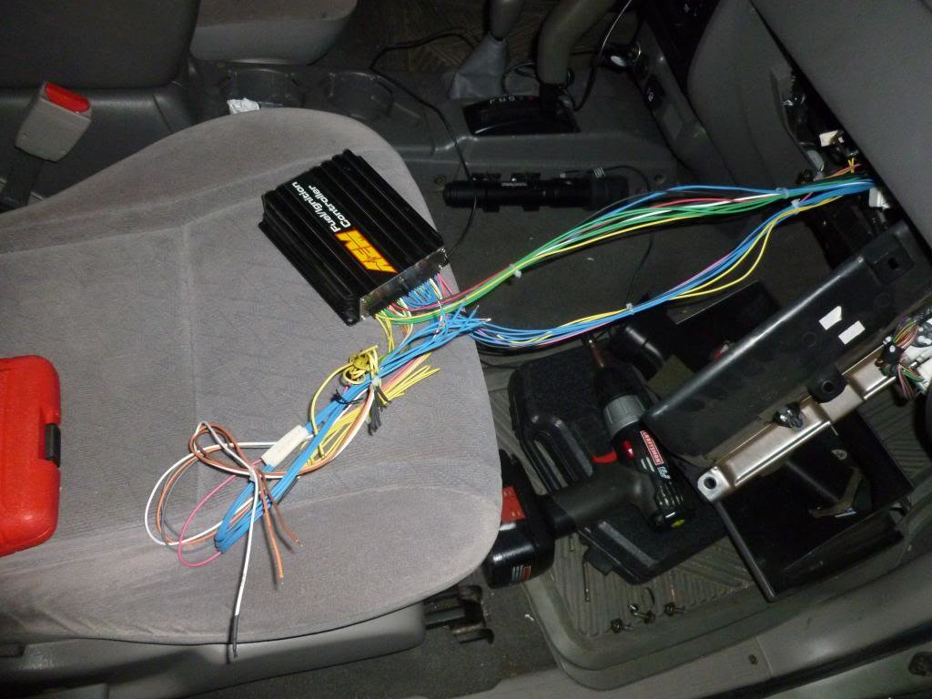

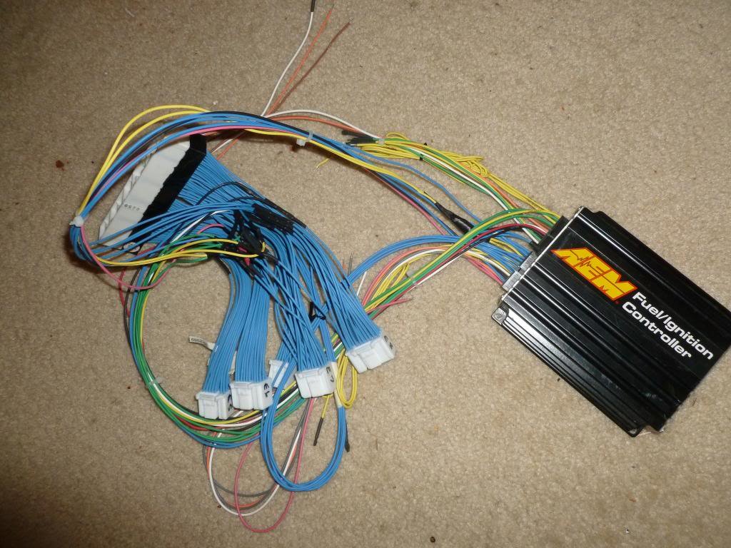

    AEM FIC wired and tested. Special thanks to Ron (Rons01TRD) who did the wiring.
    No codes and runs great, but a few tweaks I have to work out. RPM signal isnt reading; the AEM gauge reads a constant 12000 RPMs. And my Ultra Gauge no longer shuts off when I turn the truck off :notsure:.

    Damn. Truck was dead this morning (I may have hooked the FIC up to the constant 12V line vice the ignition power line, will test this in a sec).
    Also getting two codes:
    P0100 (MAF) and P1300 (ignition circuit)...

    Anyways, I figured it out. The Ultra Gauge was the culprit. Unhooked it and no more codes and the injector duty cycle gauges started reading properly on the FIC.
    I also forgot to calibrate the FIC RPM gauge... fixed that so now Im not reading 12000 RPM's anymore... :eek:
