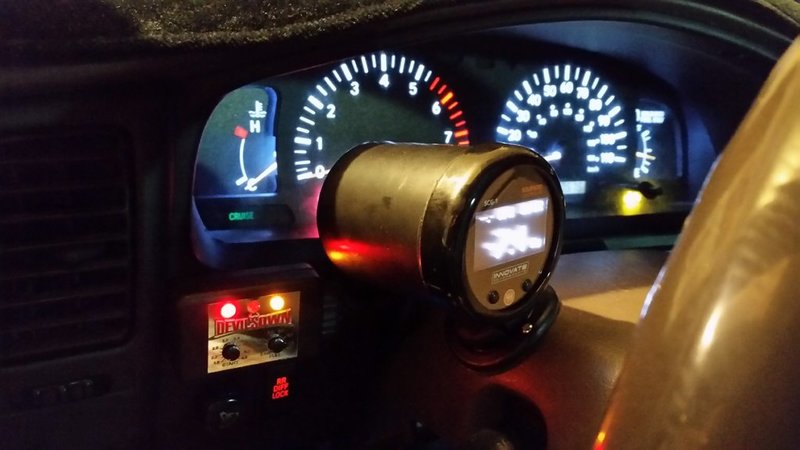

    Oh, and I got my ebc/wideband in one, and alcohol injection up, but not running until boost nasty.......!
