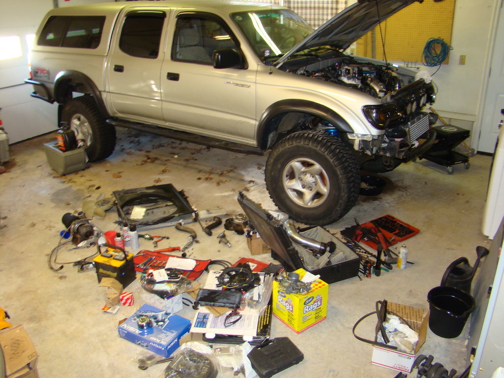

    So pulled the TB out, IAC was gummed up. How does that happen? Took all day and an entire can of TB cleaner to clean it out. Got all my parts in minus the new radiator and fan controller. Looks like I work next weekend but hopefully will get some work the following weekend.
    Large projects planned so far:
    -Timing belt, water pump, etc...
    -Oil pump
    -New radiator
    -Flex-a-light fan and fan controller
    -New injectors (OEM)
    -Spark Plugs
    Torspd likes this.

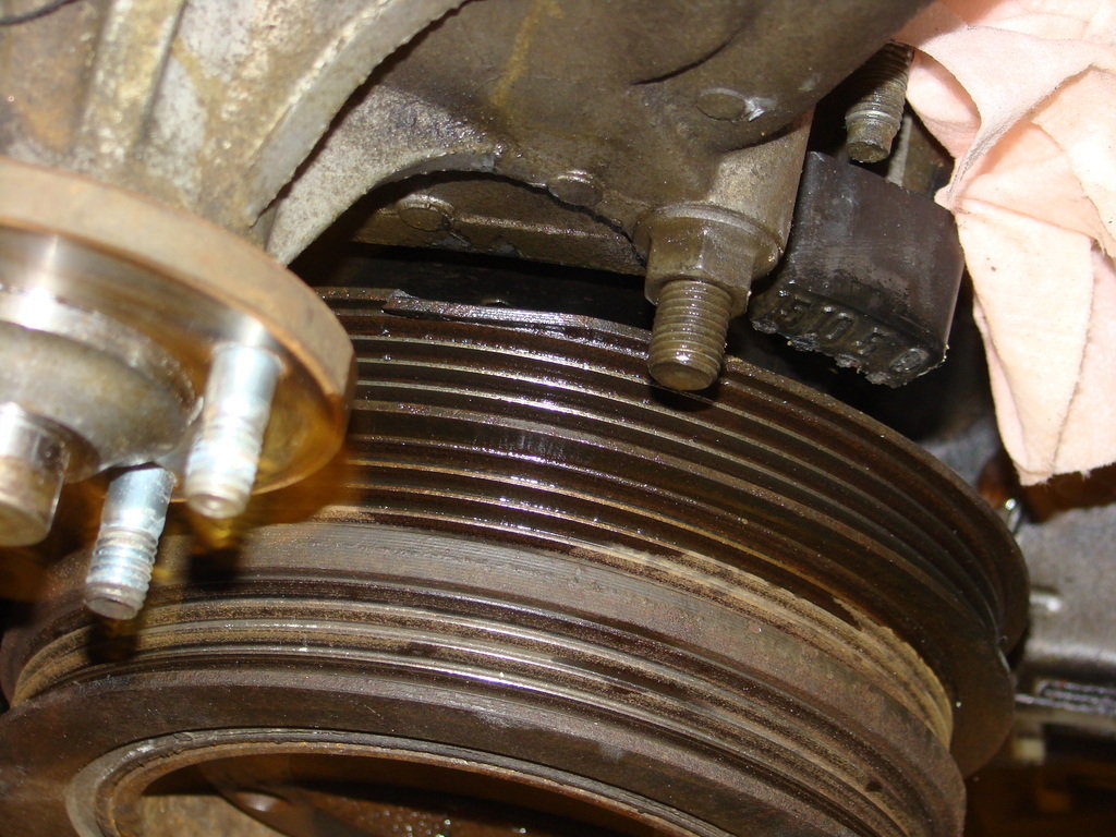

    Well.... shit!
    Anyone have a spare 5VZ crank pulley (assuming I can get this one off, its pretty stuck)?

    May I ask how that happened?
  19. Feb 11, 2016 at 11:26 AM
    #1419
    StAndrew
    StAndrew [OP] Wait for it...
    Feb 8, 2010
    #30950
    8,435
    Hampton Roads, Va
    SR5 4x4TRD
    Intake, exhaust, lift. Typical stuff.
    Its seized on the crank. I pried very carefully buy not careful enough apparently and heard a snap. I thought it was loose and did a victory lap around my garage until I saw what the snap was... :facepalm:
