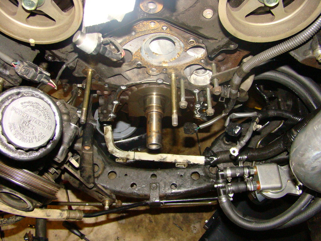

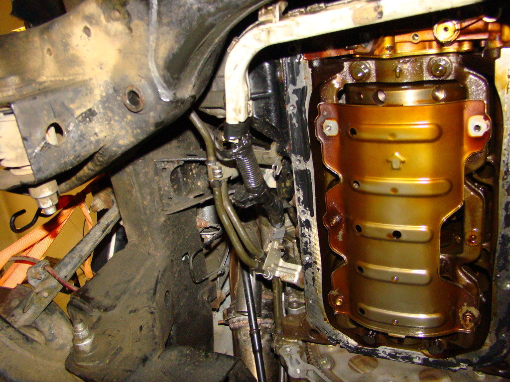

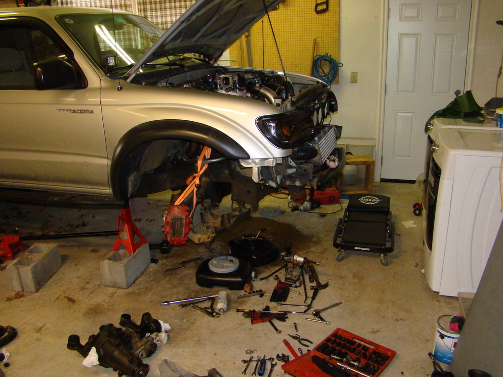

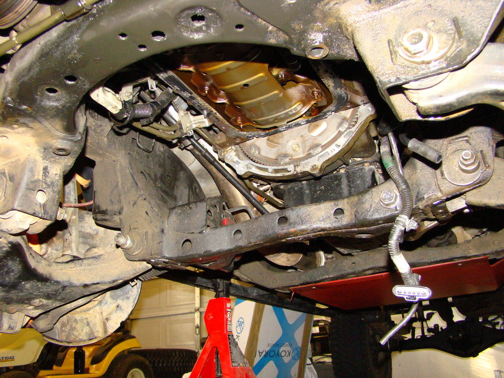

    Work was done today, thanks to Clint, Ron, and Steve. Got the diff out and dropped the pan to get the oil pump out. Just need to remove the crankshaft timing pulley...
    Crankshaft Pulley. Need a puller to remove. The Toyota kit is $500ish :facepalm:

    Rons01TRD
    Rons01TRD Well-Known Member
    May 30, 2012
    #79732
    1,142
    Ron
    Virginia Beach, VA
    2007 4Runner 4WD
    Thanks for hitting my finger with the sledge hammer....lol. Still sore as hell and swollen but glad to lend a hand.:thumbsup:

    #1451
    Torspd
    Torspd Tor-nication
    Sep 18, 2009
    #22958
    26,477
    Tor
    The Great America!
    MMVI 4.4L 4x4 Access Cab
    Torspd Custom Turbo kit [] Borg Warner 9180EFR Turbo [] Haltech Elite 2500 [] TiAL Q BOV [] TiAL V44 Wastegate @ 15psi [] CP Pistons [] CP Carrillo Rods [] ARP Head studs [] ARP Main Studs [] ARP Header - Head Studs [] Ported Heads w/ 1mm oversized valves intake/exhaust [] Brian Crower Forged Stroker Crank [] Darton M.I.D. Sleeved Block [] Kelford Camshafts [] Torspd 160* T-stat mod [] APR Large Fuel Rail [] Walbro 460 LPH E85 Fuel Pump [] FueLab FPR [] APR T56 Conversion Kit [] KP RACING Built T56 [] McLeod Racing Custom Twin Disk Clutch [] One Piece Aluminum Driveshaft [] MGW Shifter [] Custom lowering kit [] Ohlins Front Coilovers [] QA1rear shocks [] Custom Ron Davis Radiator [] Dual SPAL Electric Fans []
    I can see up your flexplate. :spy:

    #1452
    StAndrew
    StAndrew [OP] Wait for it...
    Feb 8, 2010
    #30950
    8,435
    Hampton Roads, Va
    SR5 4x4TRD
    Intake, exhaust, lift. Typical stuff.
    Sorry, bro and thanks a ton for your help. I was hoping the day would have been easier but I really don't feel good about that oil pump. Good thing too because the strainer was clogged up a bit...

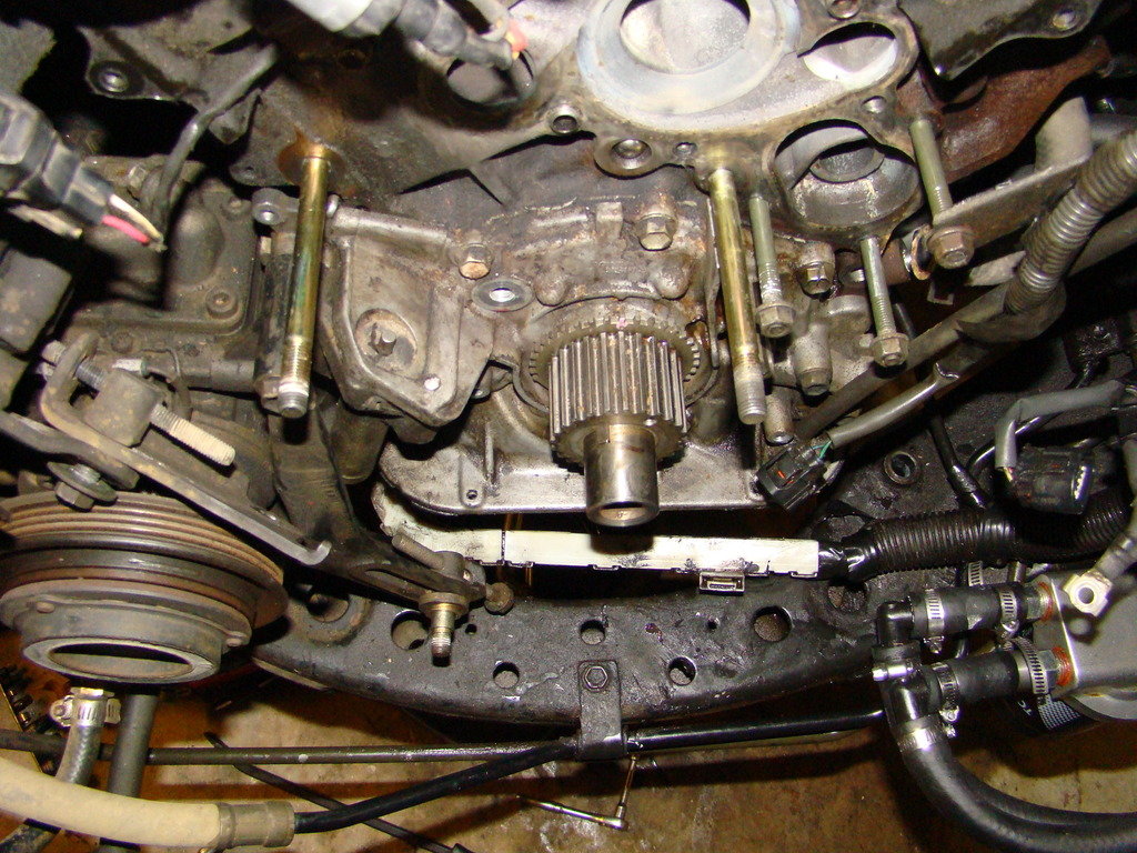

    Oil pump was a bitch to get off. The Repair Manual didn't reference this at all, but there is a bracket that overlaps the oil pump and shares a single long bolt. To get the pump out, the entire bracket has to come off. Of course to get it off, first the AC compressor has to come off.
    So got everything off, just ordered all the gaskets Ill need to put it all back together, and now just need get some new oil feed and return lines, weld a bung into my old oil pan, and put everything back together.

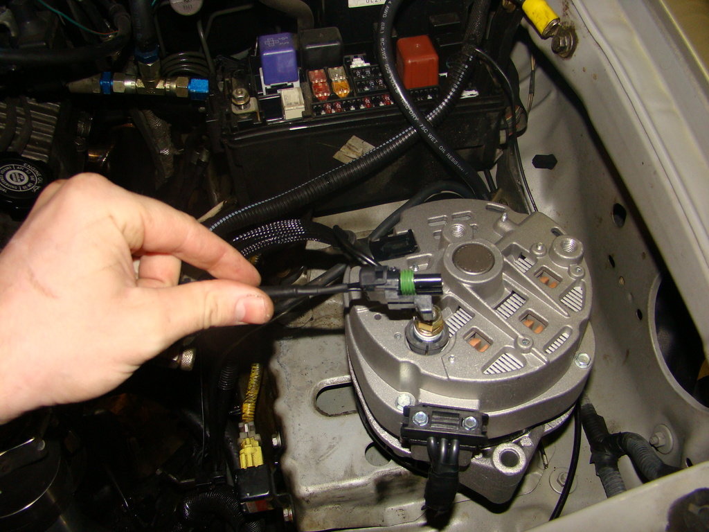

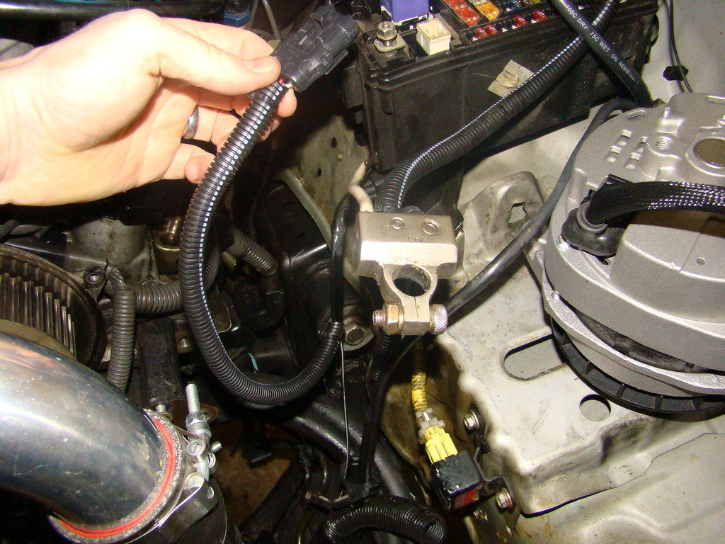

    Spent the day cleaning up some of the wiring and removing the loom. Replaced the old alternator connector with a all weather connector. Put a female end on the new alternator and going to put one on the old alternator in the inevitable case of me fucking this up and I have to go back to stock very quickly.
