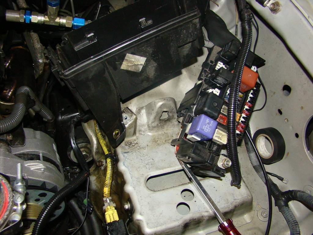

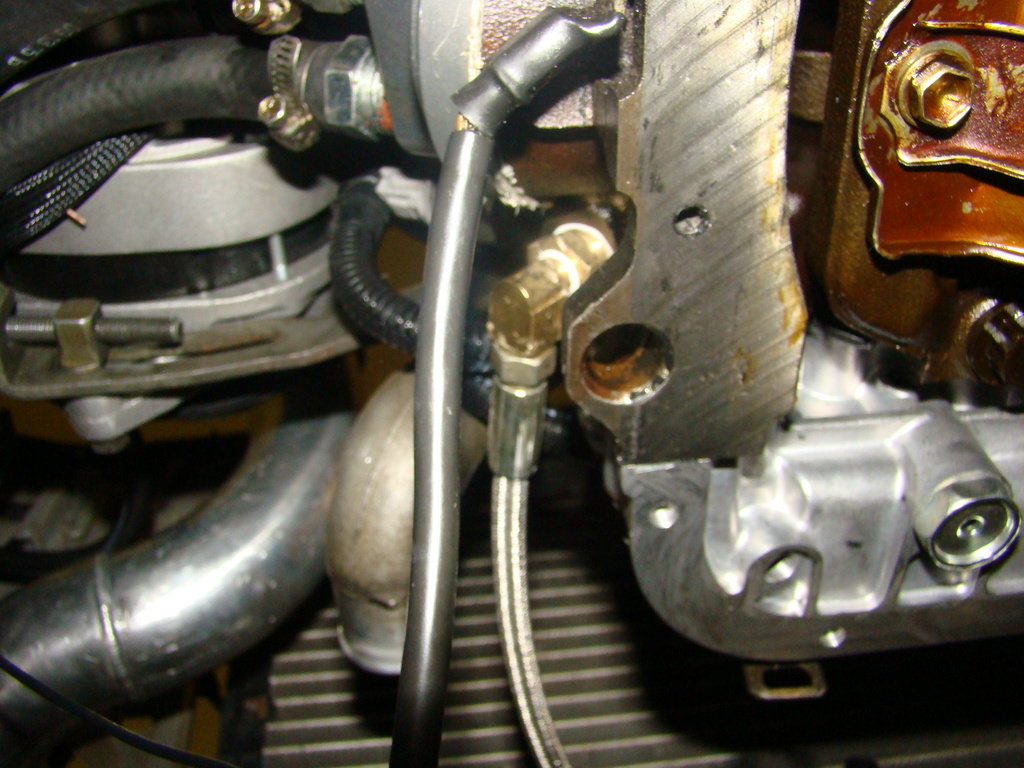

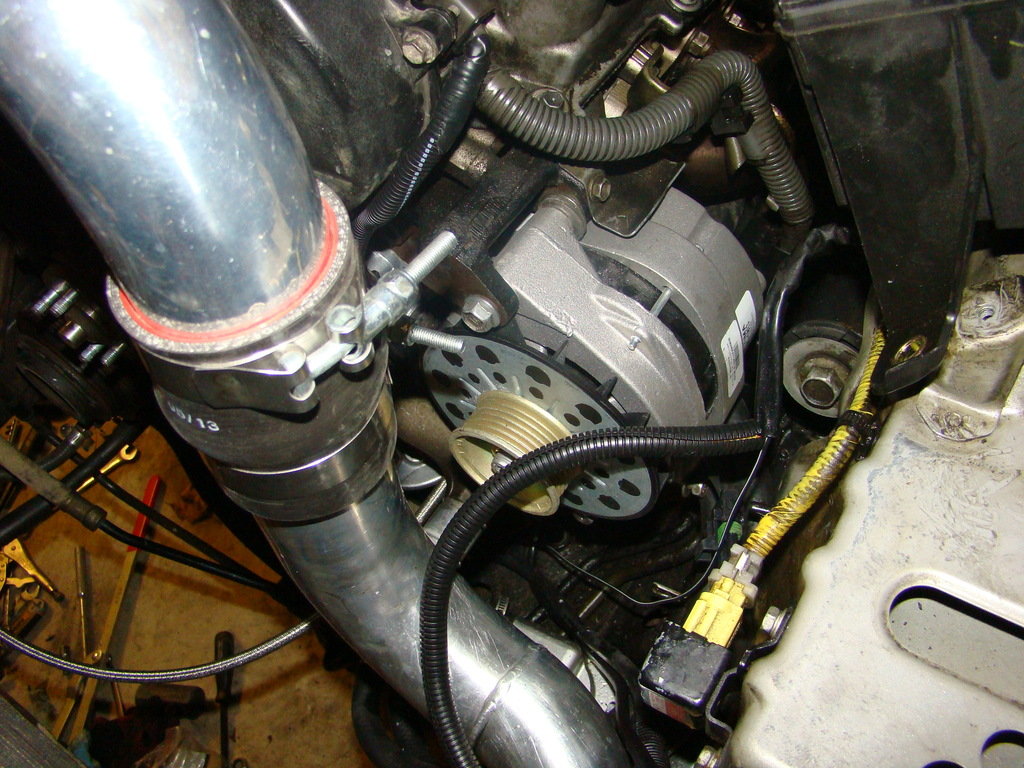

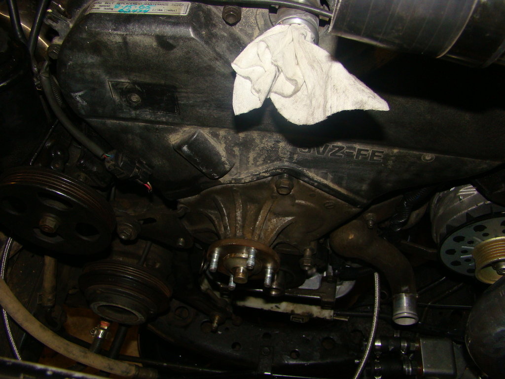

    Got a bit of word done this week.
    New Alternator:
    New oil feed:
    Timing covers on:
    Some electrical work getting done. @Blackdawg, which cable did you upgrade with the new alternator? Below are the two cables from the back of the alt to the fuse box, and fuse box to the battery:
    Before I go any further, I need to clean up the wiring, reloom, etc...

    So Monte, just re-read your post. You went from the Alt straight to the battery (with a breaker) and kept the wire from the batter to the fuse box stock, correct? The wire from the alt to the fuse box was removed.

    Don't run the alt through the fuse box. The stock alt fuse is 80amps haha you'll just pop it. I left the stock wire from the stock alt in my harness and just taped up the one end and unbolted in in the fuse block. Makes for an easy swap if I need to swap in the stock one on the trail

    Gotcha. What breaker did you use? I might get one as well.

    Just a 150 amp one from the parts store.
