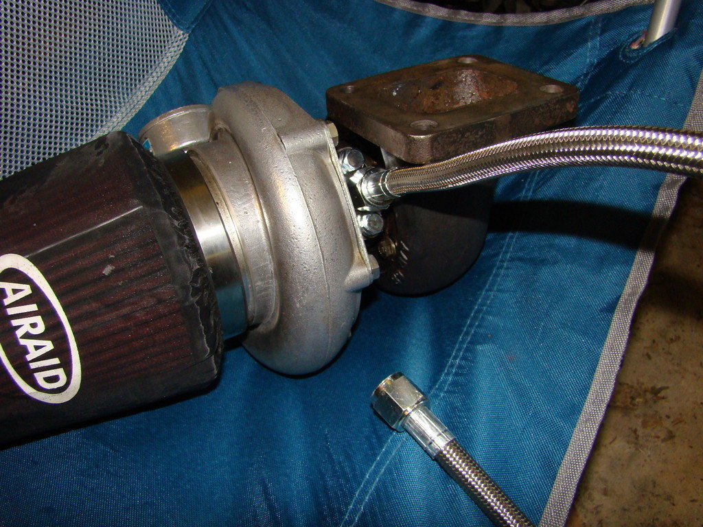

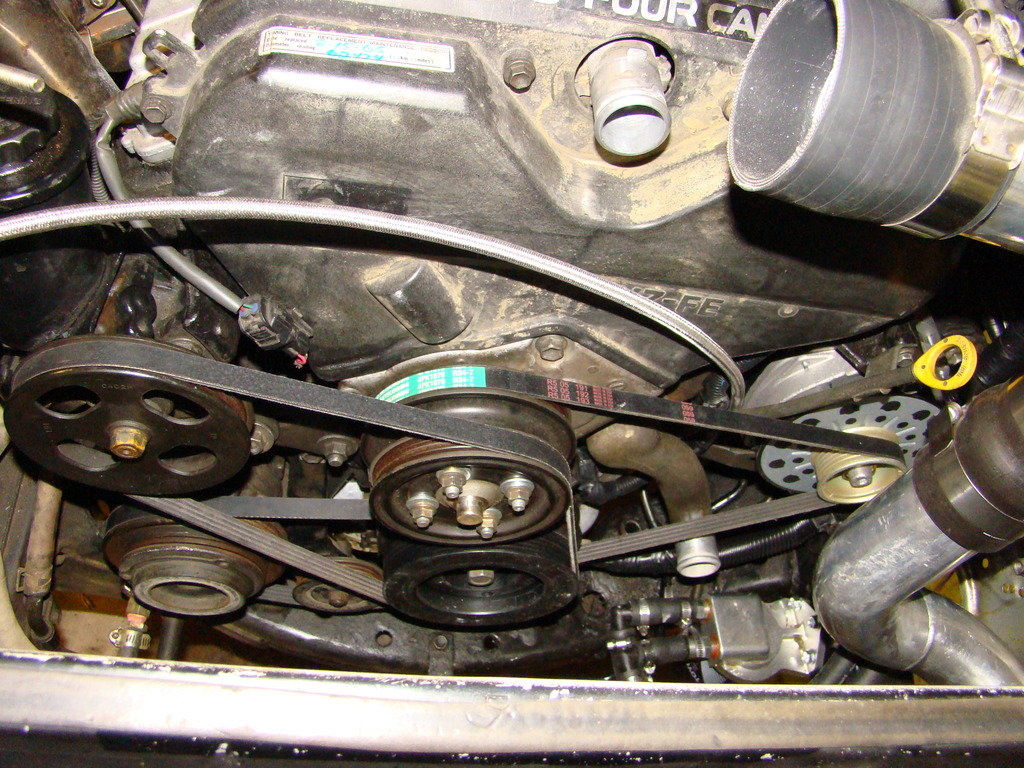

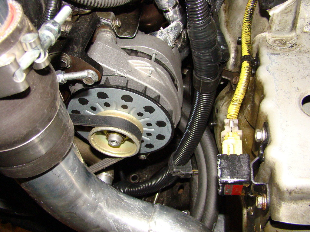

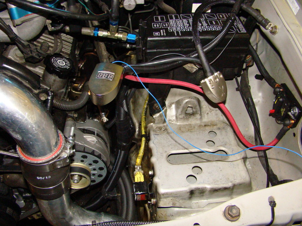

    I can't pay people to build my truck; doing it myself in whatever spare time I can find. With three kids (one only a few months) not much time laying around :p
    Finished up the HO alternator and new wiring. Taped and loomed up. Thanks @Blackdawg for the breaker suggestion and alternator notes, worked out great! I was able to use the power steering pump belt but just barely.
    Belts on:
    New oil drain line for the turbo, this hose is the tits. Most flexible steal braided hose I've ever worked with. Had to grind down the hose fitting and the flange to get the turbo to clock further over for a more up and down oil feed and drain but its still not perfect.
    Just need to find a welder to attach the new drain plug into my oil pan and I can start putting this thing back together!
    Blackdawg likes this.
