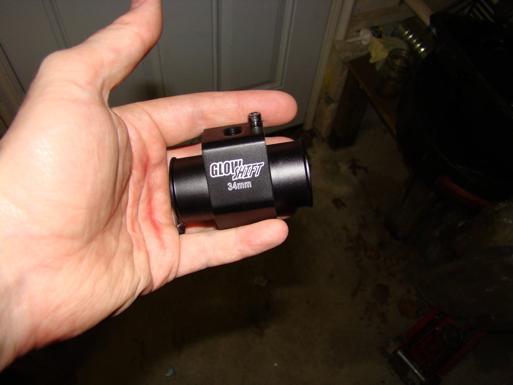

    Lots of work done, a bit more needed.

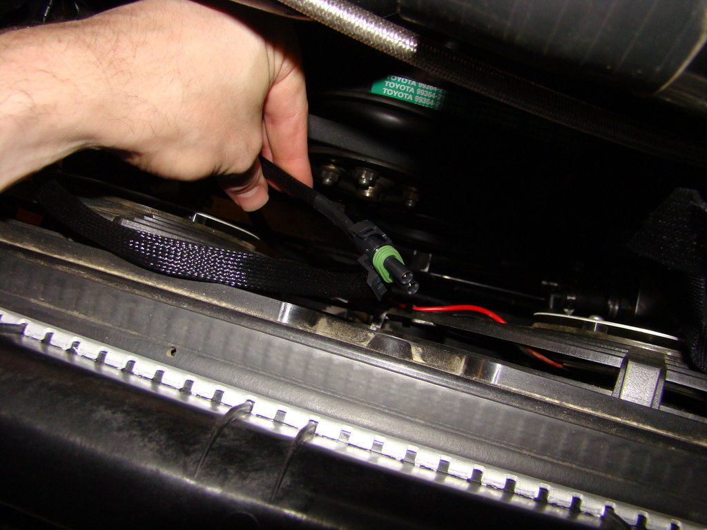

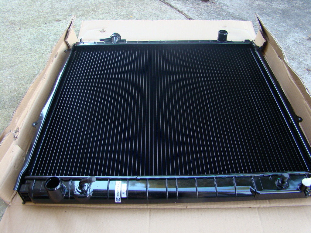

    First, got the radiator and fans installed.
    Fan connection

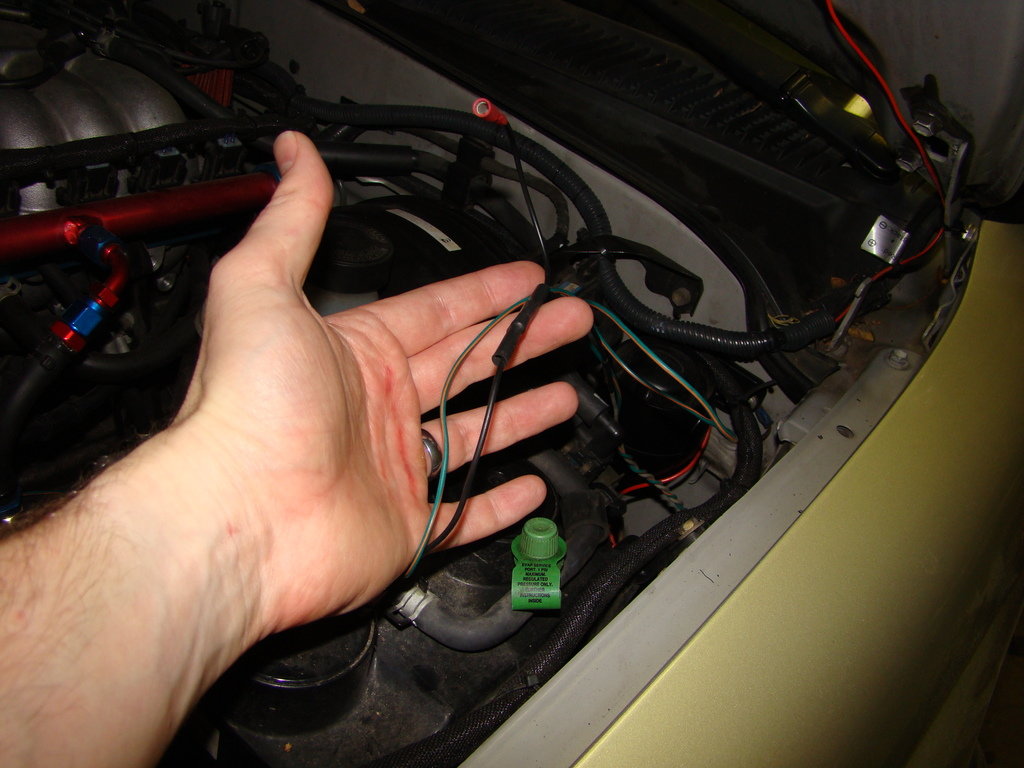

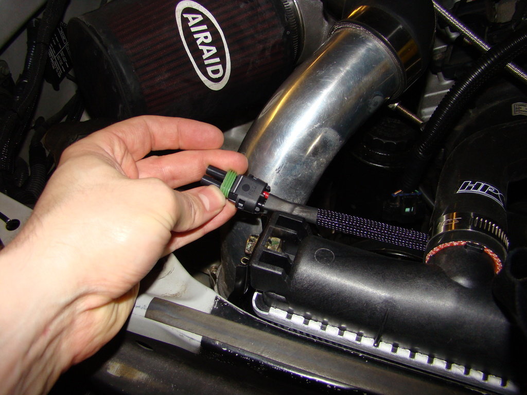

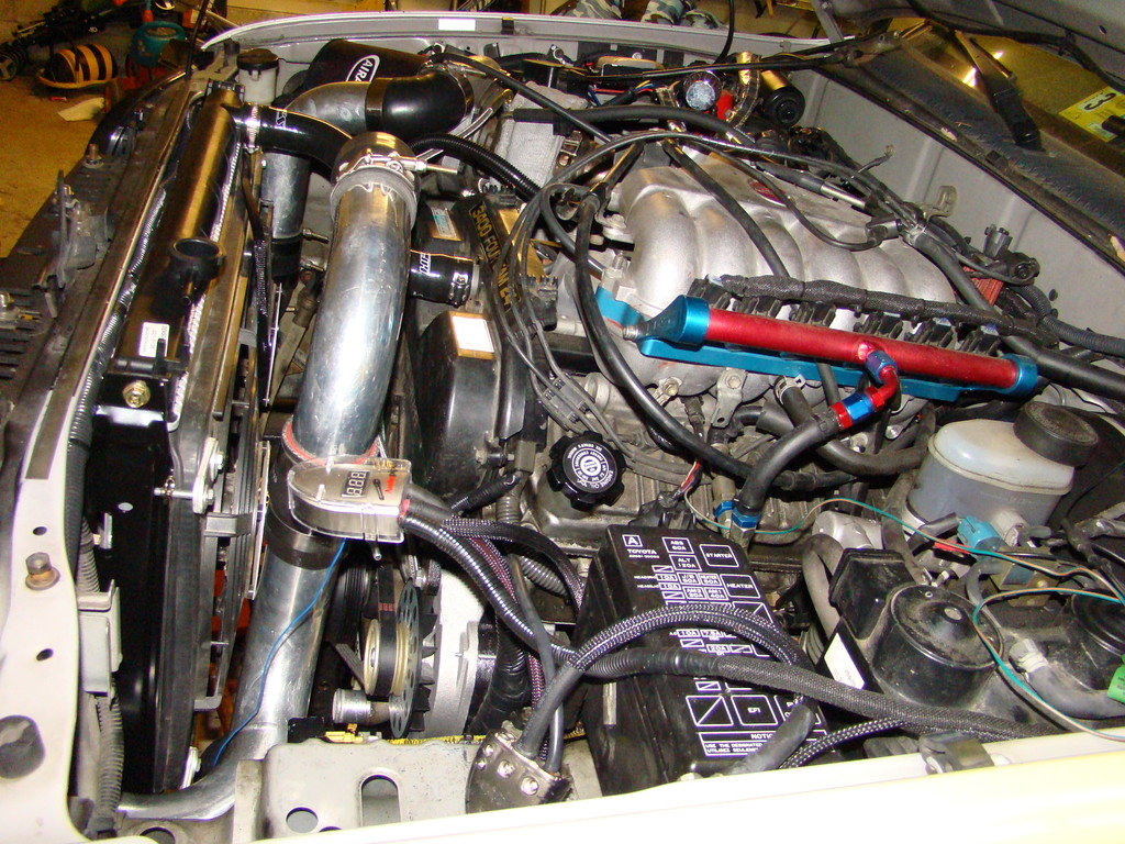

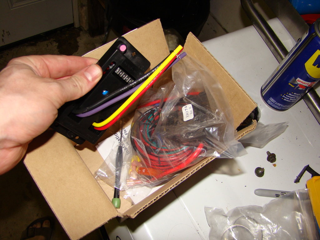

    Got the upgraded fan controller with a proper threaded temp probe (not the probe you jam into the radiator fins). Its water proof but I still want to mount it high up, thinking the rear firewall but not sure yet.
    Lots of re-looming to do to consolidate some of these wire runs.
    For the temp probe, when with Glowshift adapter. Flex-a-lite was the only company that made a proper threaded adapter but it was almost $30 more than I got the Glowshift so I'm jut going to drill and tap it. It also comes with a grounding attachment; I'm going to mount it on the lower rad hose.

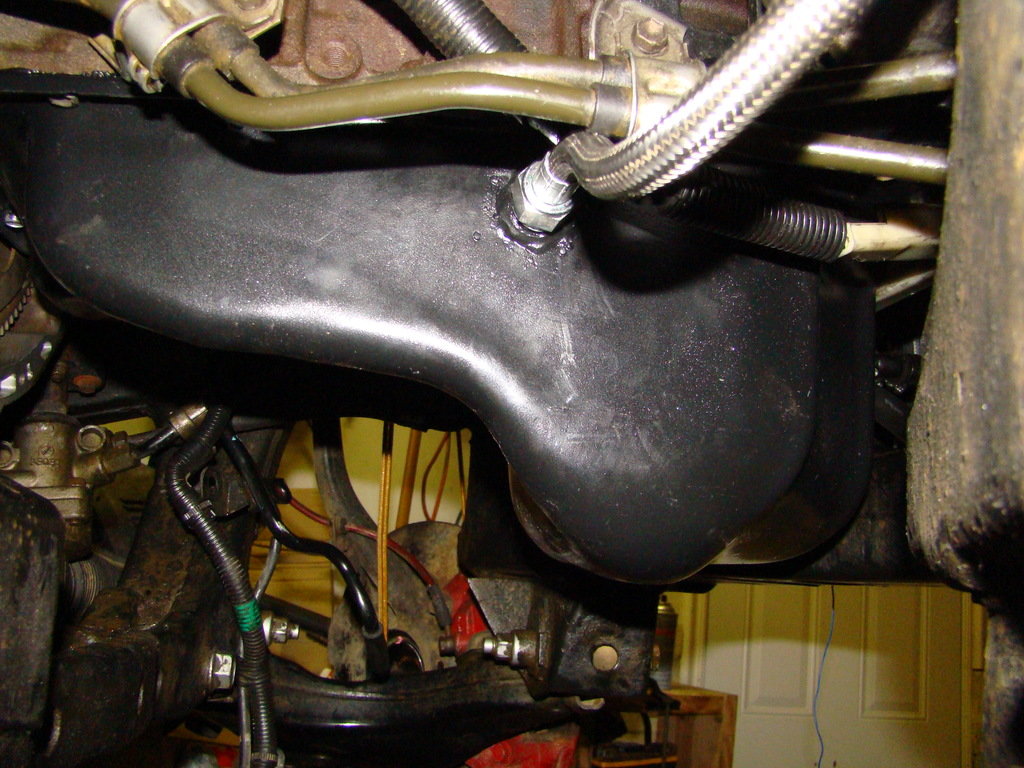

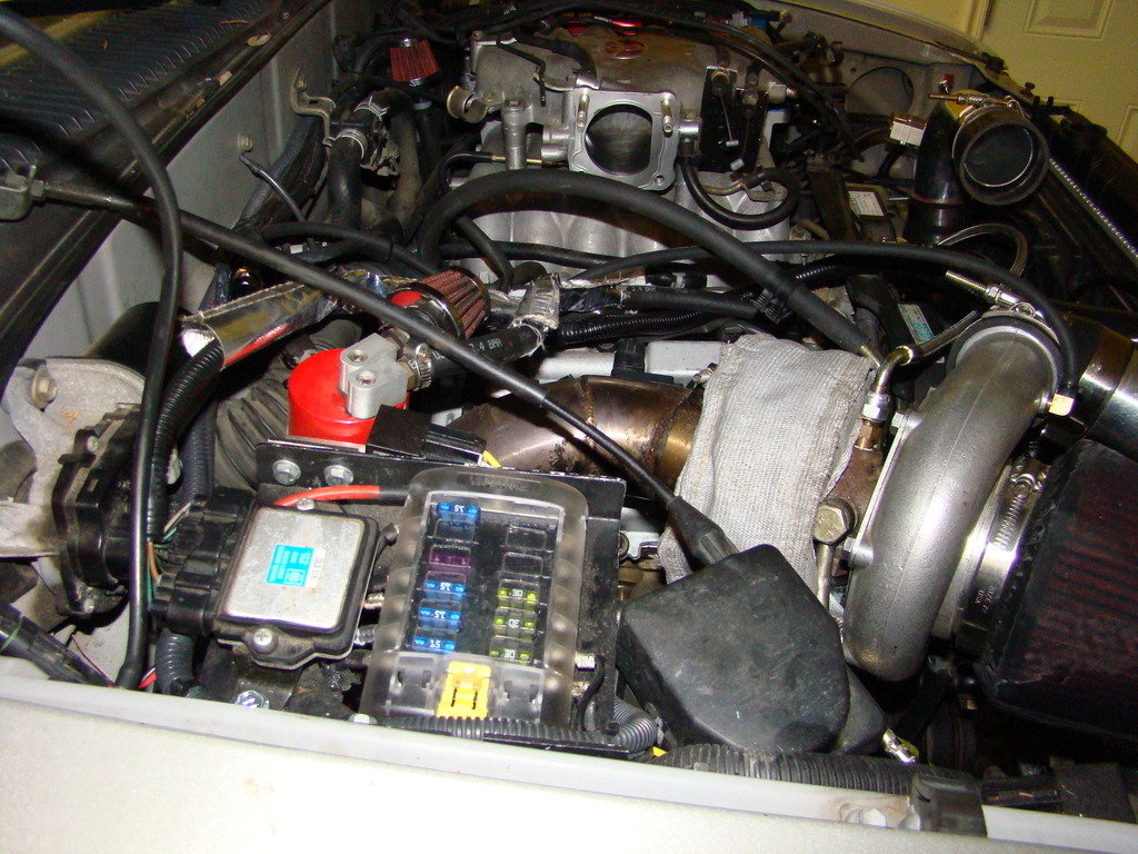

    Oil pan in. Where I mounted the fitting was close...

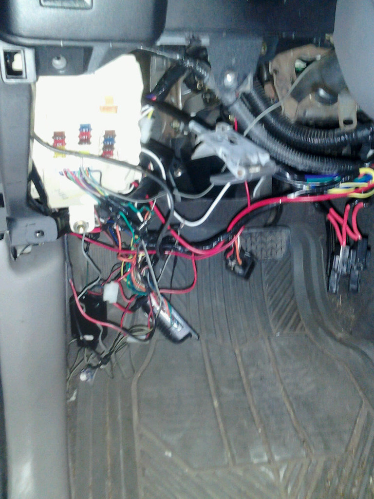

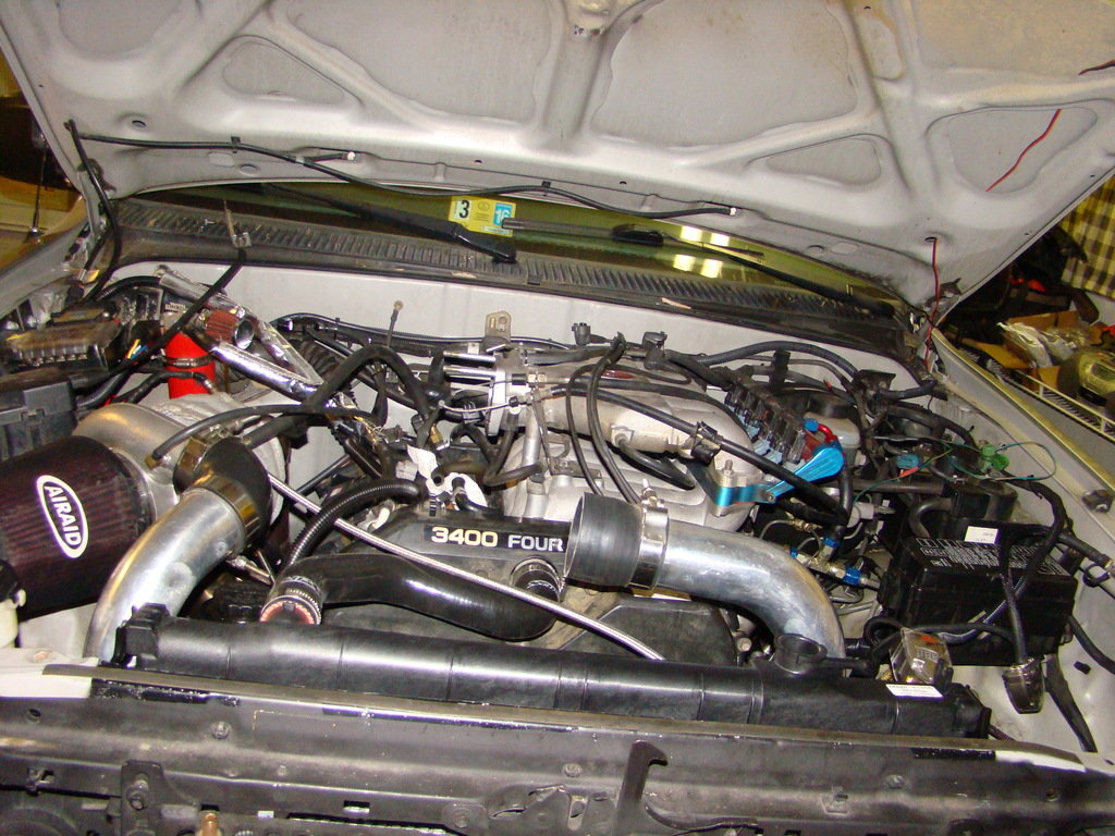

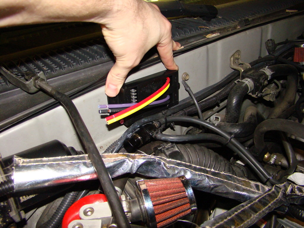

    Mounted the igniter module next to the aux fuse box to keep the wire loom away from the down pipe. Where it was previously mounted put the wireloom perilously close to the turbo and down pipe. Still not perfect so to be safe, got some heat resistant sleeves for now. Again a lot of wiring that needs to be re-done.
    What a fucken rats nest. Bro, do you even wire?

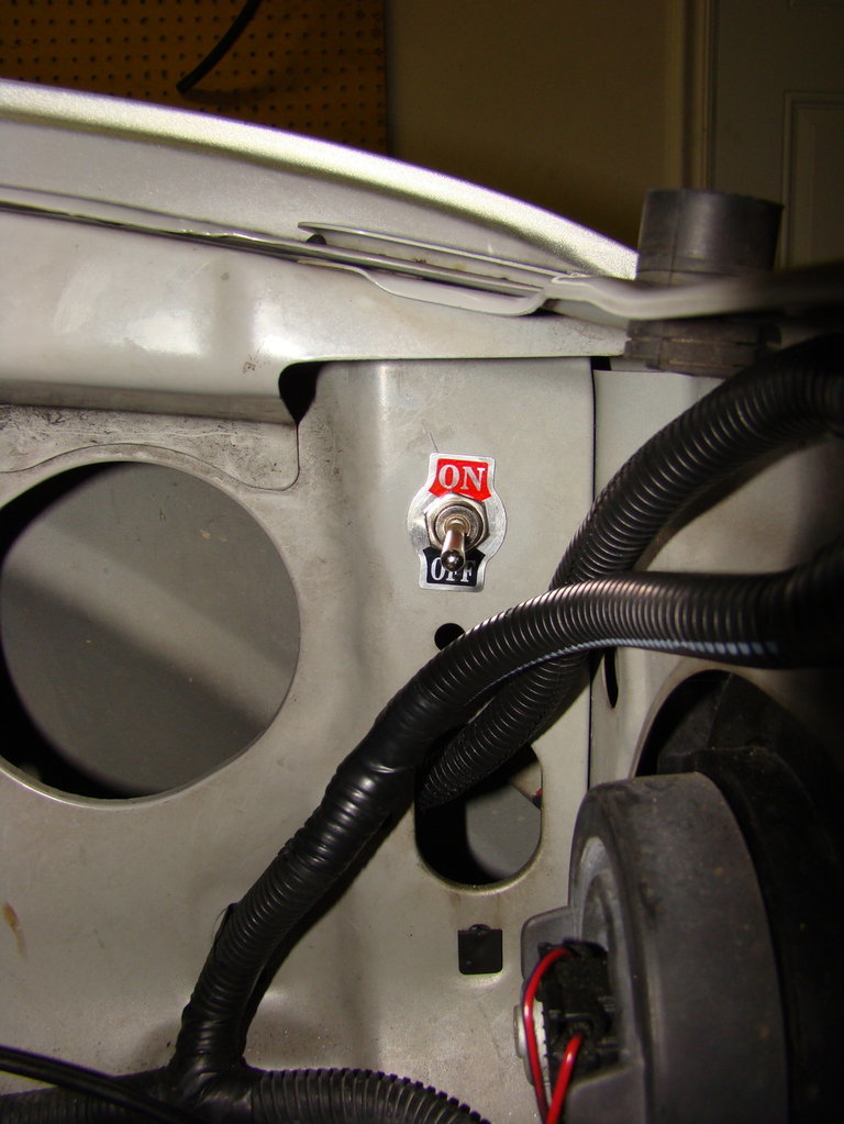

    Took the hood pin off for the engine bay lights and put in a switch.
    While I was going over the wiring, figured its a good time to unfuck the alarm wiring. Took off the hood switch for that; don't really need it. Now just got to figure out how to wire it so the alarm doesn't go nuts.

    Lots of work man. Would love to do away with the clutch fan. I've read it doesn't do much to switch to electric but I still think think they are better. Get that fuel rail pumping man!

    Spider web of vacuum hoses!!!!! :annoyed:
    You've been putting in some serious work. Finally. :p

    I don't think it will be a big difference. Just shifts the load to the alternator. The module I got has a "force on" and "force off" function but I don't know if you can do both. What I would like to do is have a three way rocker switch with a neutral in the middle and on/off on the top/bottom. If not, just a force off function in case I have to go through some deep water.
    Yeah, its a rats nest and probably will stay that way but I think a few hours of work can make it a tidy rats nest :p Focused on function now. When I get some time, Ill get one of those waterproof fuse/relay boxes Skygear used to make and clean up some of the wiring.

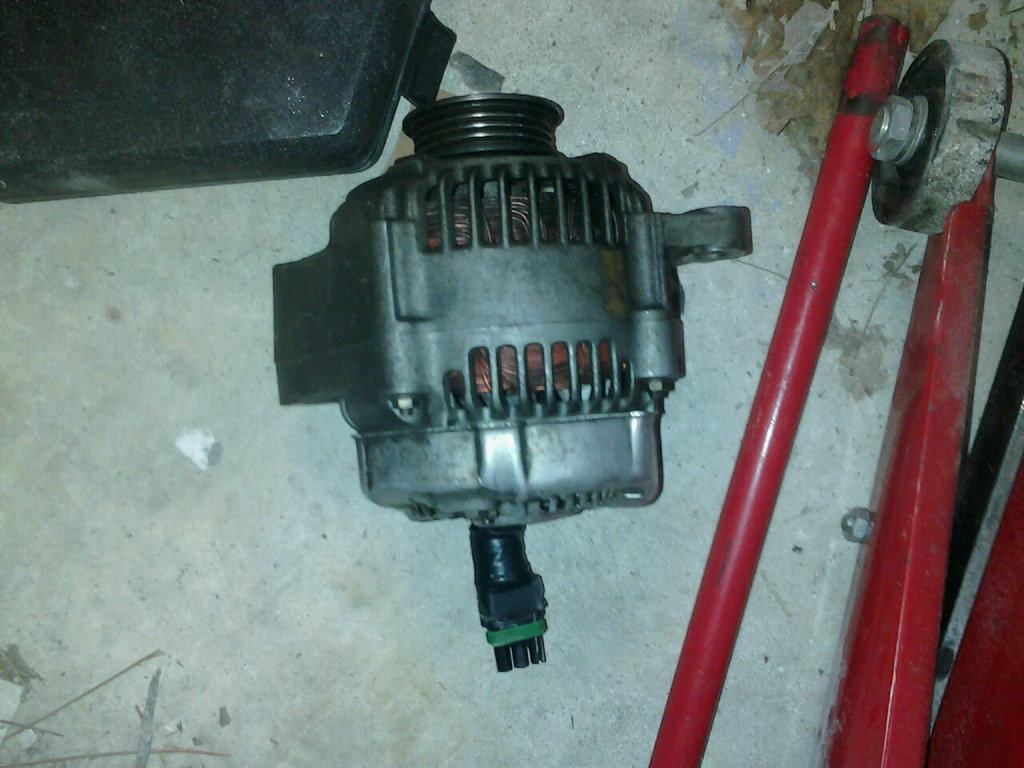

    Update:

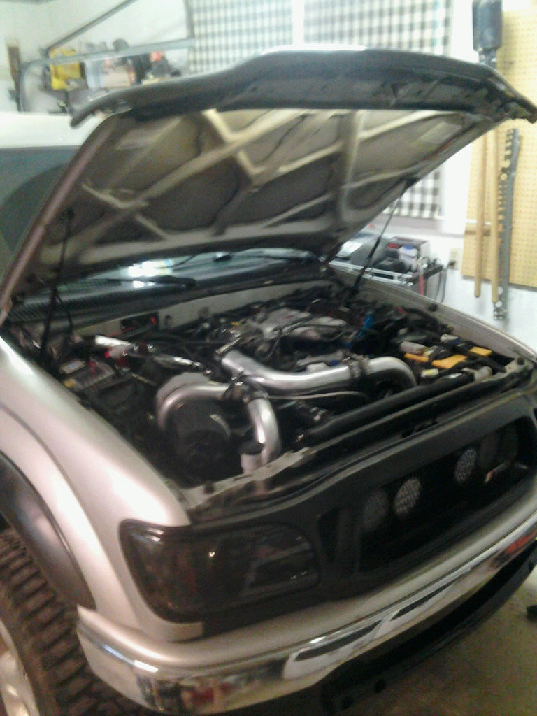

    Had a ground fault. Fixed! Officially done with the engine! *Cant find the battery charger for my camera so had to use my phone, sorry for the pic quality*
    Original Alternator with new pig tail, just in case.
    Everything together but a few more tasked on the to do list:
