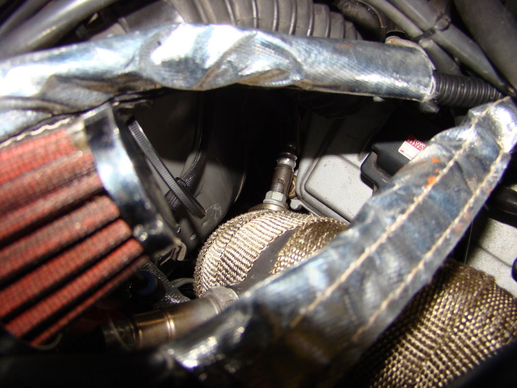

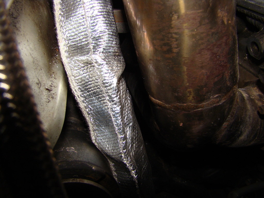

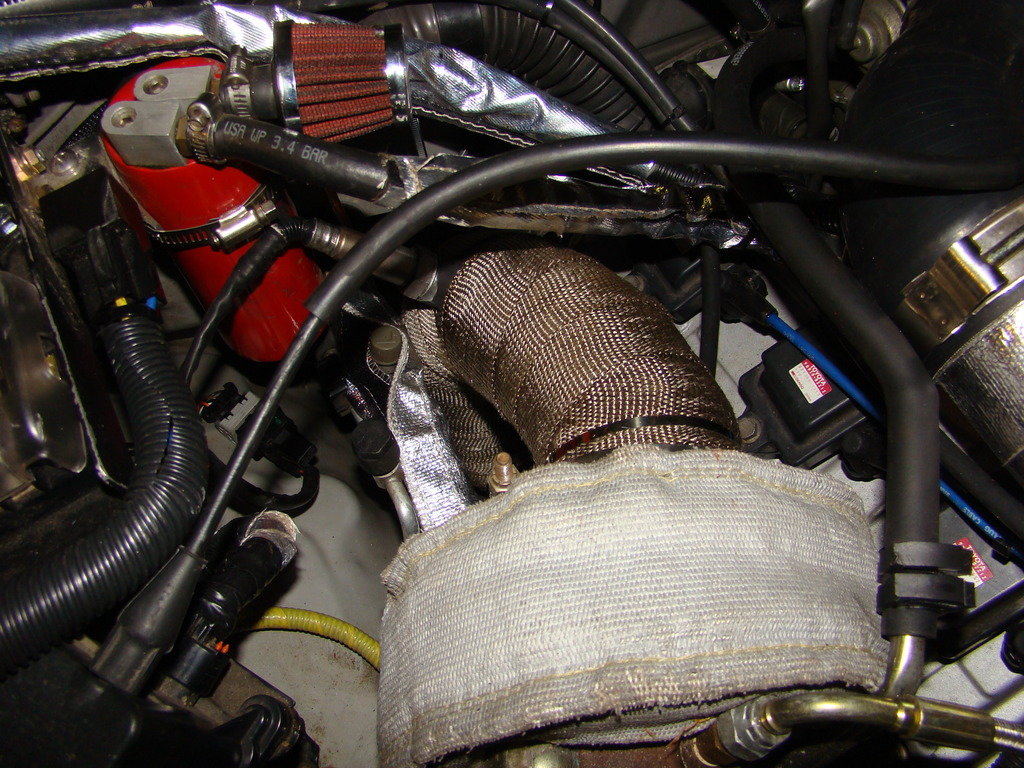

    So quick update. Moved my stock AFR to fix a persistent AFR surge and fall at idle and light load. Runny %90 better but still a fluctuation at idle however instead of fluctuating between 10 and 18+, its now between 14 and 15ish. The engine used to surge and fall almost to stall then surge again.
    Also wrapped the down pipe as it is so close to so many things that don't like heat. The brake lines and A/C in particular.
    I got a heat reflecting blanket for the A/C line as it gets real close to the header's up pipe.
