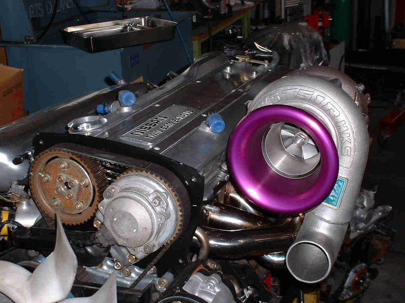

    If you were to take the filter media off of the base, which bolts to the intake, there would be two style of designs. One would be a flat surface, with a hole in the middle. Creating a 90° edge. The other would be radius'd and look like this.
    The 90° inlet, to close to the MAF, has been well documented to creating turbulence across it.
