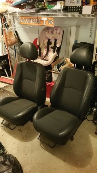

    Just picked these up for $150... Now I need to fit them to the Toyota rails and install the seatbelt on them. Not sure how that will work.

    Seats are from a Dodge Charger. I'll need to mock something up for the buckles as these seats never had any so no bracket or anything to attach. I have some Corbeau seat brackets but for some reason they didn't have a seat belt buckle bracket either. Weird. Will have to mock something up.

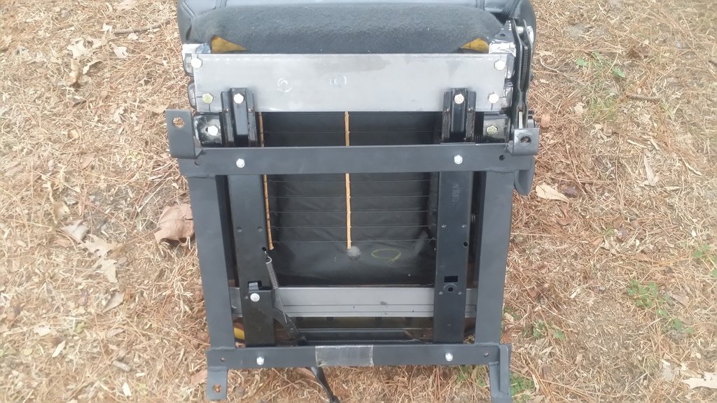

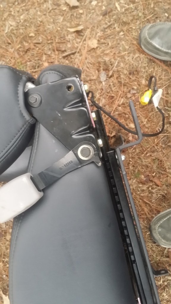

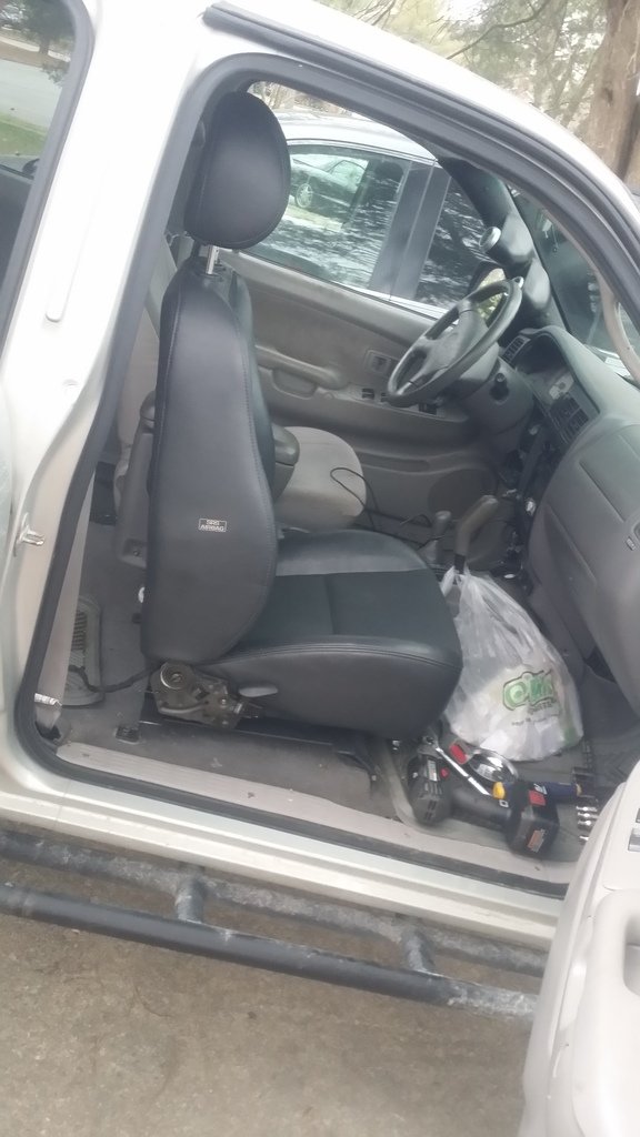

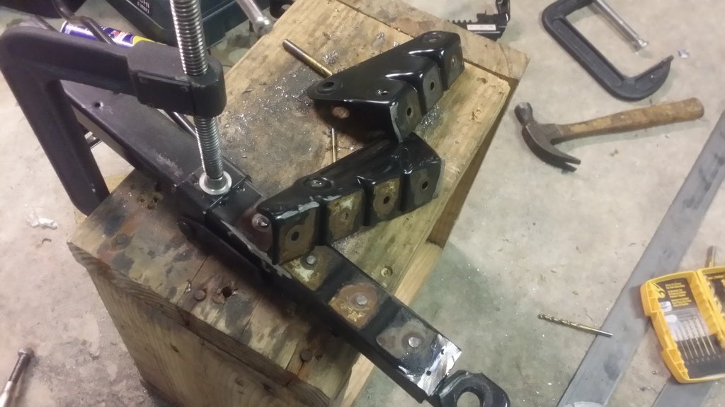

    So these seats are a PITD. I thought I had it figured out but apparently the back of the seat were mounted via the brackets welded to the slides. I was hopping I could do this without messing with the brackets.
    Issue is these have to be supported pretty robustly; only one bolt on each bracket attaches to the bottom seat so I had to drill holes in the metal brackets of the seat and used the sheet metal to provide a little more support. This was about %99 of the PITD so didn't get any pics; maybe when I do the driver seat if anyone cares.
    Success, adapters done and new slides mounted.

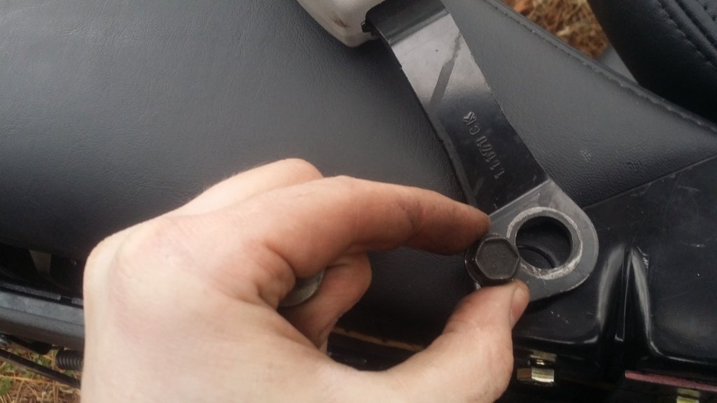

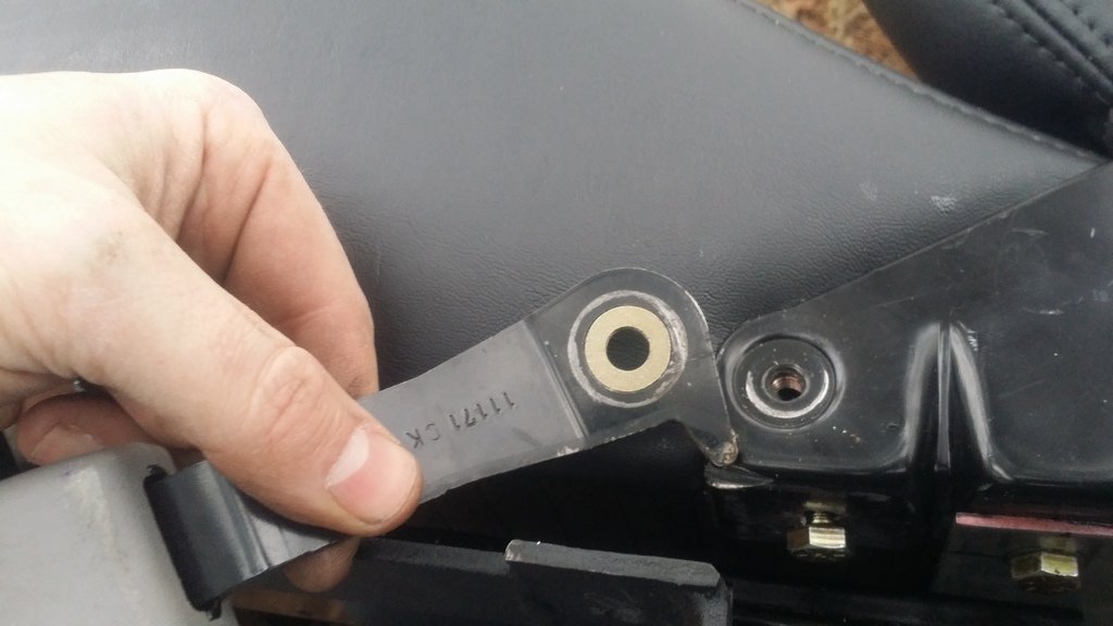

    Next issue was the seatbelt. Stock belt and bolt where I wanted to mount it didn't match
    Easy fix. Used some perfectly sized washers to fill the hole.
    In! Unfortunately not quite as low as I wanted them... Might have to do some mods on the driver side but not sure how that will work yet.
    So of a bitch...

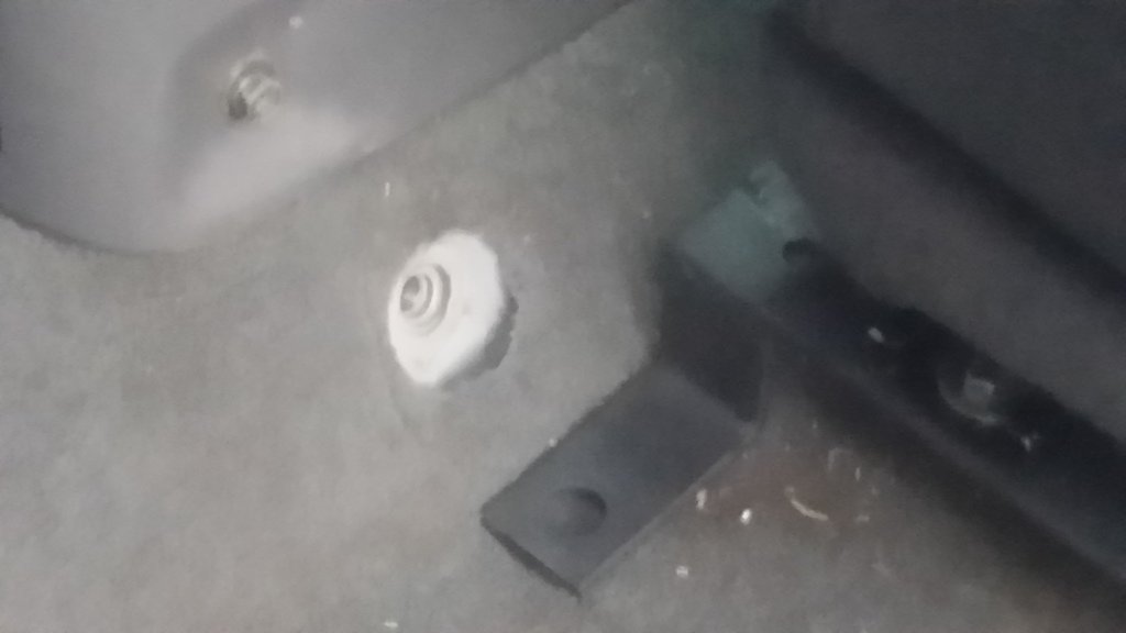

    Not sure what to do with that last mount bolt. Its ok if someone is sitting but it's a bit wobbly with no weight on it...

    Yes, so if I cut it and re-weld sideways it MIGHT work but I think I need to add in a spacer to move the bracket a bit closer to the mount.

    Just drill str8 thru the floor and bolt it where it is... If it suits ur fancy weld a nut on the bottom side so its more oemish

    Am honestly considering this.

    Get it fixed either way. I wouldn't want my seats loose in my rig..

    Def not. About %95 committed to drilling a new hole in the floor. Just not sure how I'm going to keep it sealed.

    Silicon the bolt. Be fine. How ive done bolts through the floor.
