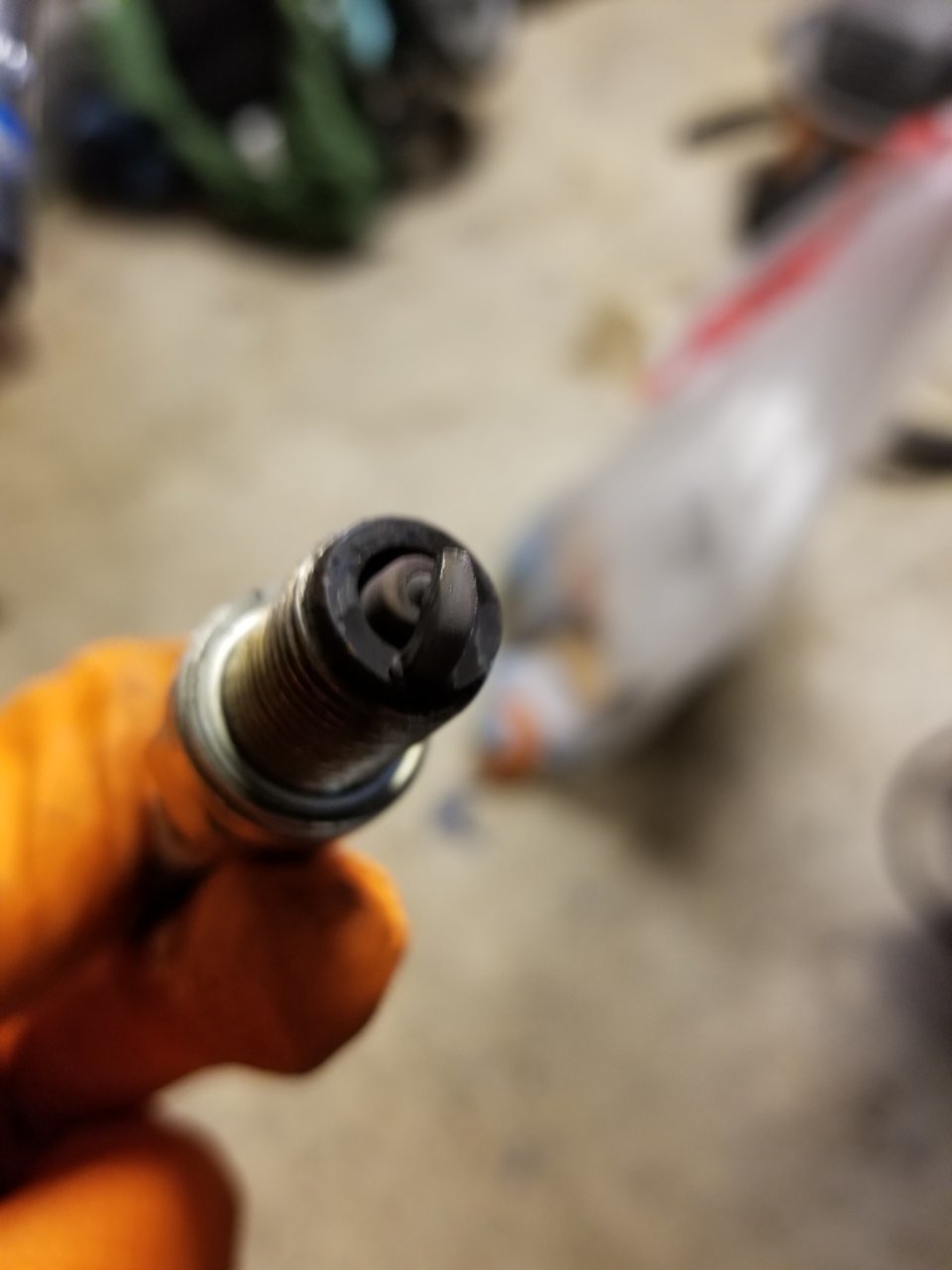

    Denso heat range for the 5VZ is IK16. The recommendation for the turbo is two ranges colder so IK22. Today I've determined that was a lie.
    These were way cold and my garbage fuel mileage was even more garbage lately, maybe around 12-13ish. Swapped them out for IK20 plugs.

    Curious if you see a difference in mpg.

    It feels a lot better. And idle is smooth. I didn't even notice the idle until the new plugs.
    Looking back the recommendation started with URD and the recommended the IK22s for the super charger which makes sense since that thing runs hot and doesn't have an intercooler.
