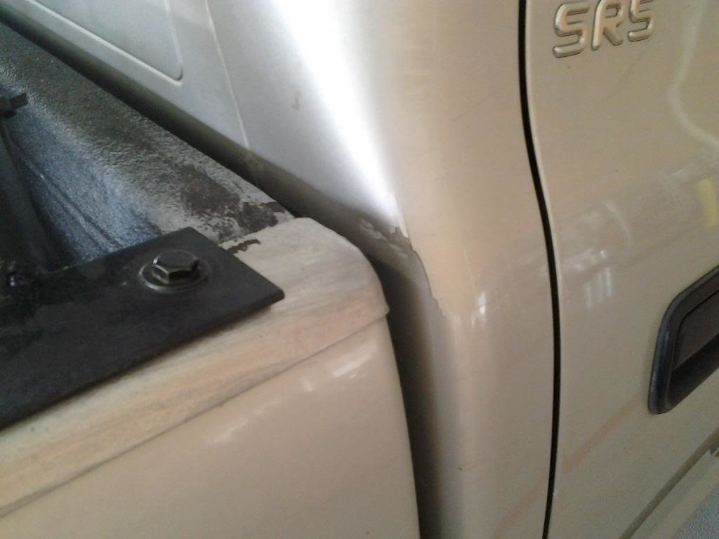

    Dropped the truck off at collision center today and got a bent frame... :(. Also found this:
    Good news is appraiser wants to buy a new bumper rather than hassle with trying to straighten this one out and believes the total $$ for repairs wont "total" the truck :)

    So they are gonna buy you a new bumper...but not straighten the frame??

    No they are going to straghten the frame but not even try to straighten the bumper. Just too thick. I mentioned they could try to pull it out while anchoring the truck but he was afraid it will tourque the frame again (duh). Just dont have he tools to straighten it out. Besides, at $355 (plus shipping) actually cheaper than the stock chrome bumer (~$500).

    ahhhh so new TG bumper and frame straightening! sweet man.

    Better if I didnt need it but at a $200 deductable, I can live with it ;).
    Got a call from the assessor, the frame was off about 1/2 inch... Not bad.
