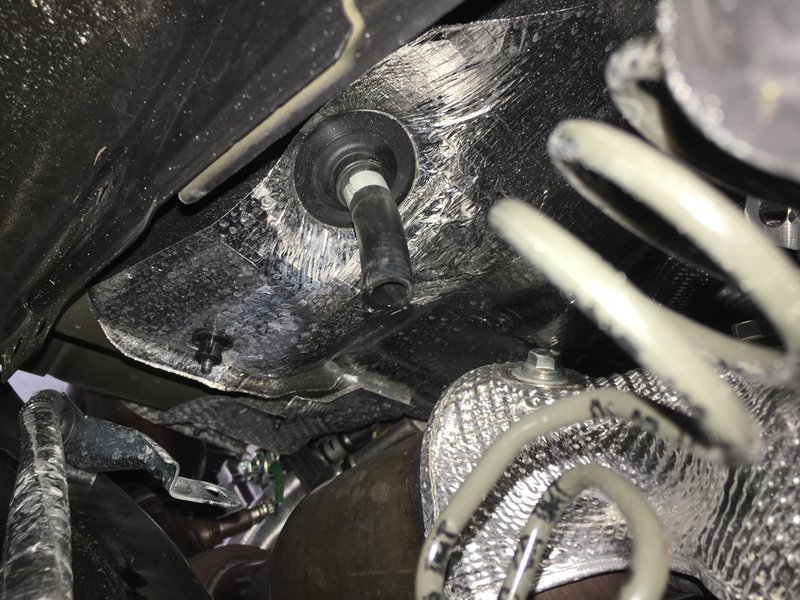

    I plan to actually. Picked up some tubing and a hose clamp last night.

    So I pulled the blower and the cabin air filter. The coils weren't readily visible. But the "ducting" that the fan blows into is easy to access with the blower out of the way. Snuck the hose through the ducting and lit er rip. Smells nice in there now.

    I wish someone had an exploded view of the air box. Maybe the vent tube is the best way to access the coils. Maybe @splitbolt @Saeros or @Jeff Lange can snag an exploded view?

    Can do tomorrow.
    Also Toyota in Canada now offers a AC foaming cleaning service. 00289-ACRKT is the part number for the kit. I hear it makes a good bit of difference.

    See attached

    And to add, the AC Kit that I spoke of earlier, you attach to the drain tube thats outside the truck. We also have a kit by BG that basically does the same thing, but they have you pull that tube through into the interior, and shove a long straw up through that hose and spray. Basically fills up the ducts and coats the evaporator in a foam, then you let it drain for a while.

    Nice! Looks like I was able to hit the coils by going through the curved circular portion on the output of the blower motor.
    Thanks for this!

    It is. The A/C evaporator is in the box this drain tube drains out of.
