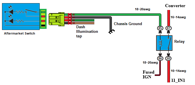

    I would definitely recommend running it through a relay and then you switch the relay on and off. And definitely add a fuse inline.

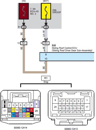

    Does your Taco have a sliding roof?
  4. Dec 18, 2024 at 7:36 PM
    Pahonix
    Pahonix [OP] Active Member
    Mar 2, 2022
    #391668
    37
    Portland, OR
    2022 Tacoma TRD Sport Lunar Rock
    The basics
    It does not.
  5. Dec 18, 2024 at 7:37 PM
    caribe makaira
    caribe makaira Well-Known Member
    Feb 13, 2011
    #51121
    11,741
    Caribbean, Puerto Rico
    05 PreRunner TRD Offroad AutoTrans
    Hood Struts, My version Fogs always ON, Map & Overhead Light Mod,

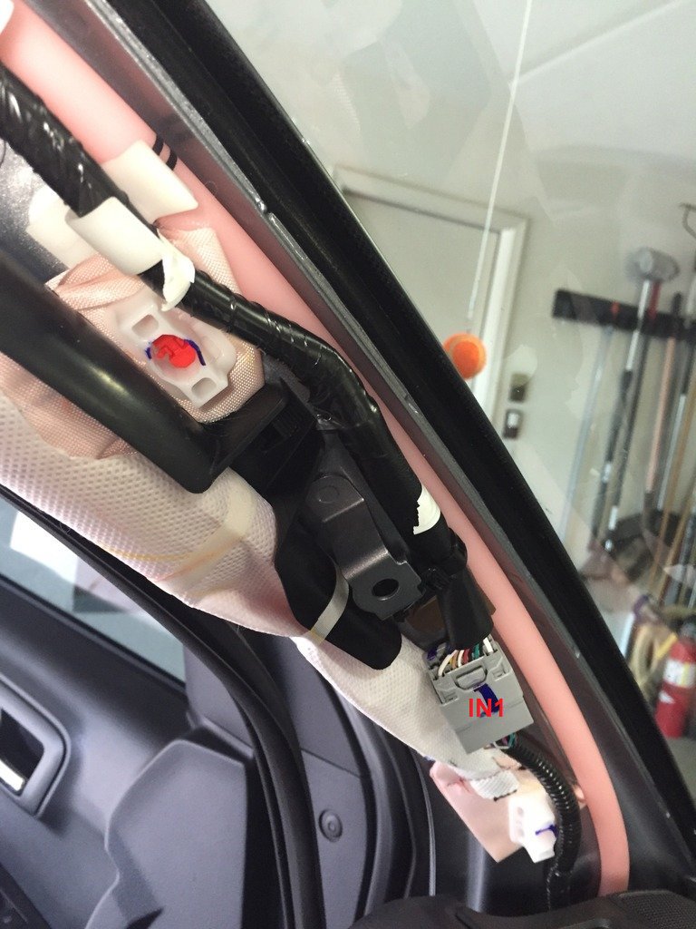

    There's your battery source in-cab.
    IN1 is behind the sail panel on Driver's side.

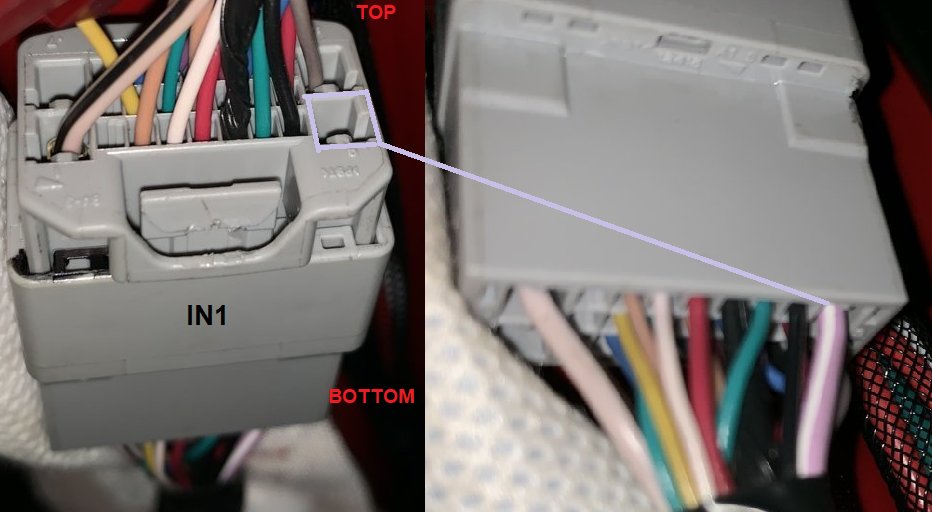

    Missing terminal on IN1 is 090/2.33II type.

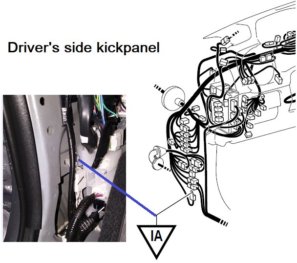

    Ground location on Driver's side:
    Many other are also near.
