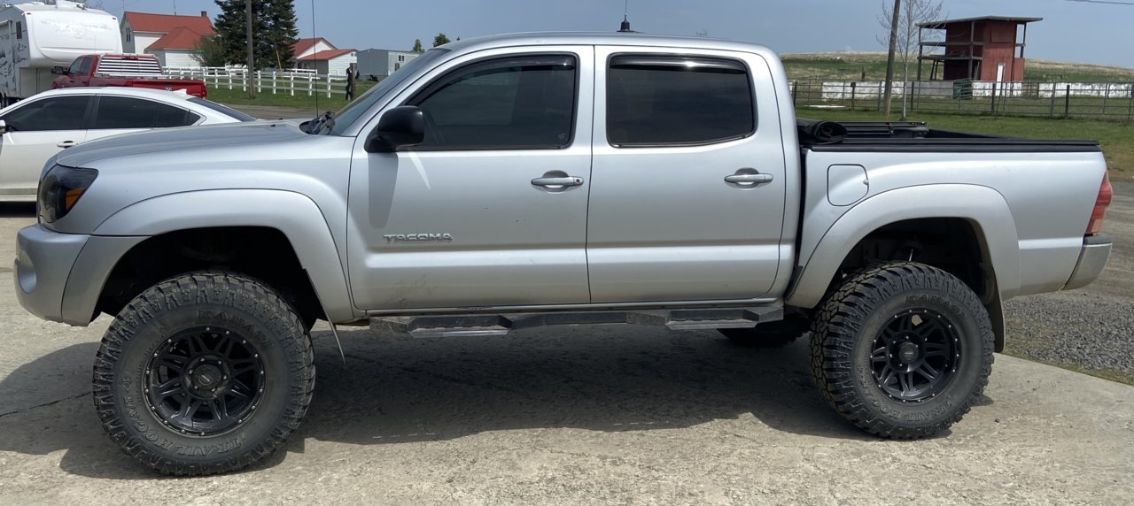

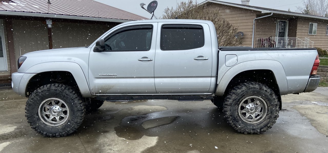

    1. Chrome wheels are 37” Boggers pre trim, cut, grind, bend and hammer.
    2. Black wheels are the current 35”s I’m on.F4D38332-7867-4975-A641-63D81212CF15.jpg2C401D53-A3F8-4292-97C1-277182E4D5DC.jpg
