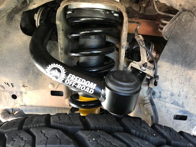

    I started my Tacoma Build last week end! and I wanted to share the results. The TW fourms were an invaluable resource when choosing my parts for the build. I am trying to build my truck on an Budget. If I can buy it on Craigslist that is what I will do. However I did not want to cheap out on the suspension. I choose the OME lift because of all the good review on the forums.

    FRONT:
    OME 3" Liftkit purchased through ToyTech (Used their coupon code on TW. Worked great.)
    Coilovers w/ 884
    Freedom Offroad UCA

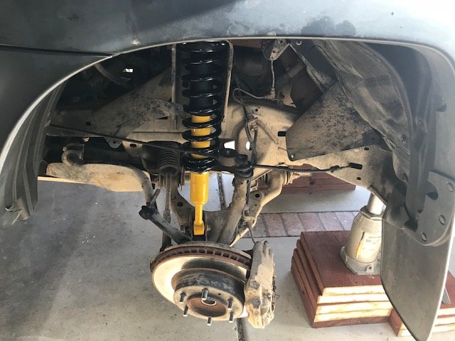

    REAR:
    OME Rear Struts + AAL

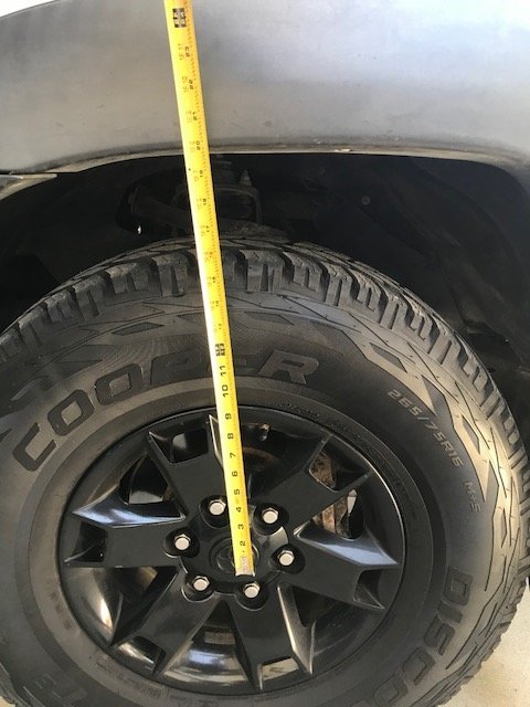

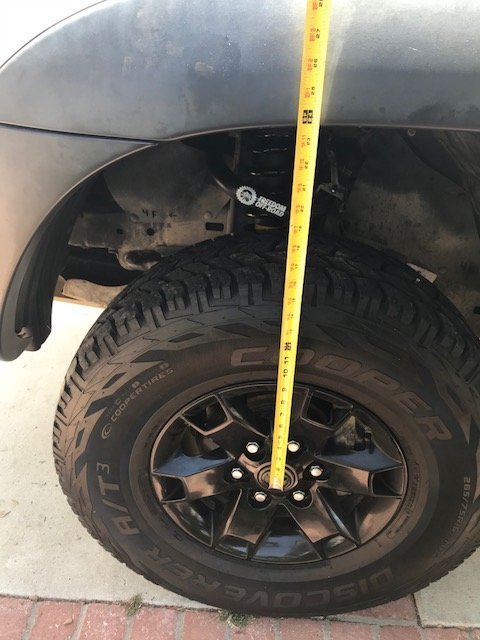

    STOCK HEIGHT = 20"
    LIFTED =23 1/2"
    (a little bit over 3" before it settles)

    Freedom Off Road UCAs doing their thing. I have nothing to compare them too other than stock. So far they are great. I have not been off road with them yet. I will post review when i do go. I choose them because they were the cheapest.
    Honesty I took me and a friend about 7 hours just to install the Coilovers and the UCA. This was way longer then I expected. So much so that we did not get to do the rear lift. I have been driving around with a Baja truck all week. We will get it finished this week end. If I get time I will install new Wheels and tires also.
