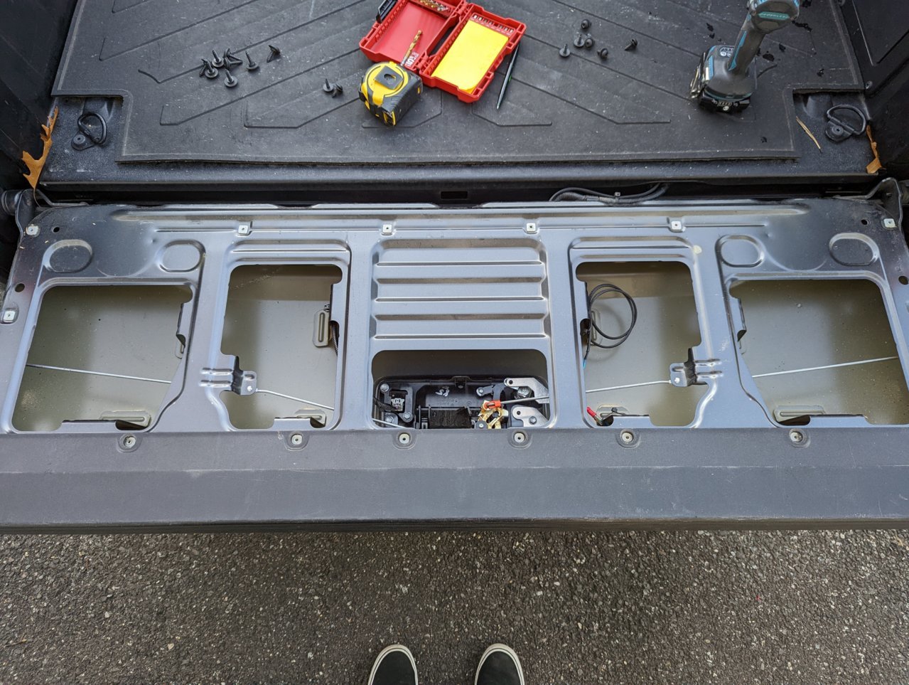

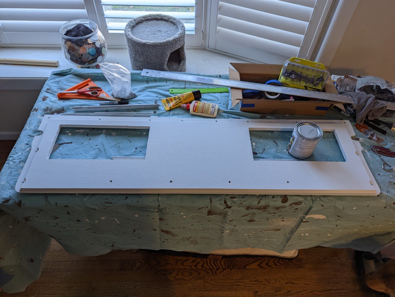

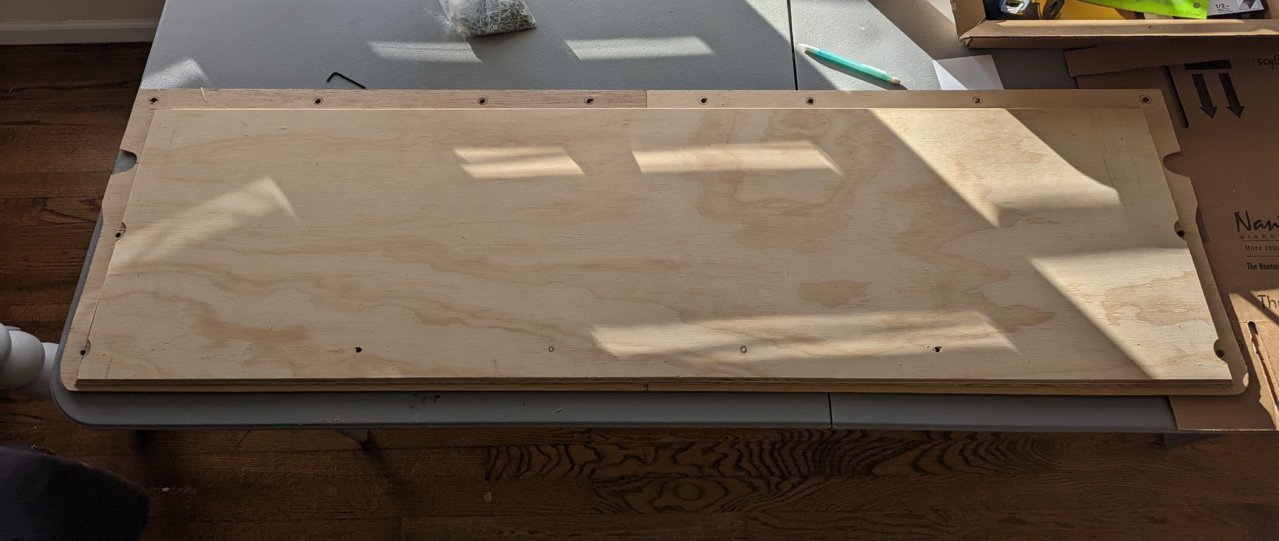

    Saw a company makes a storage box but it is really expensive and you have to cut out most of your tailgate. Decided to give it a try with minimal cutting. Not done yet. Just doing a little bit at a time and for less than $200.
    1/4 ply with a piece of 1/2 glued and screwed.
    Was going to fiberglass over the plywood but decided to use zinsser indoor outdoor primer to seal it. Will final coat with some black deck paint.
    Some aluminum to protect edges and give a lip for weather stripping, also for the handle to latch onto.
    Will attach the lids with piano hinges.
    Going to bend some abs sheets to make the bins. Already cut out the pattern.
    Only modification to the tail gate it cutting out two cross pieces and switch the rods to a cable for opening the tailgate.
    It's not a mind blowing amount of storage but it will get the straps, bungees and air hose out from behind the seat.
    Definitely not a professional, just bored.

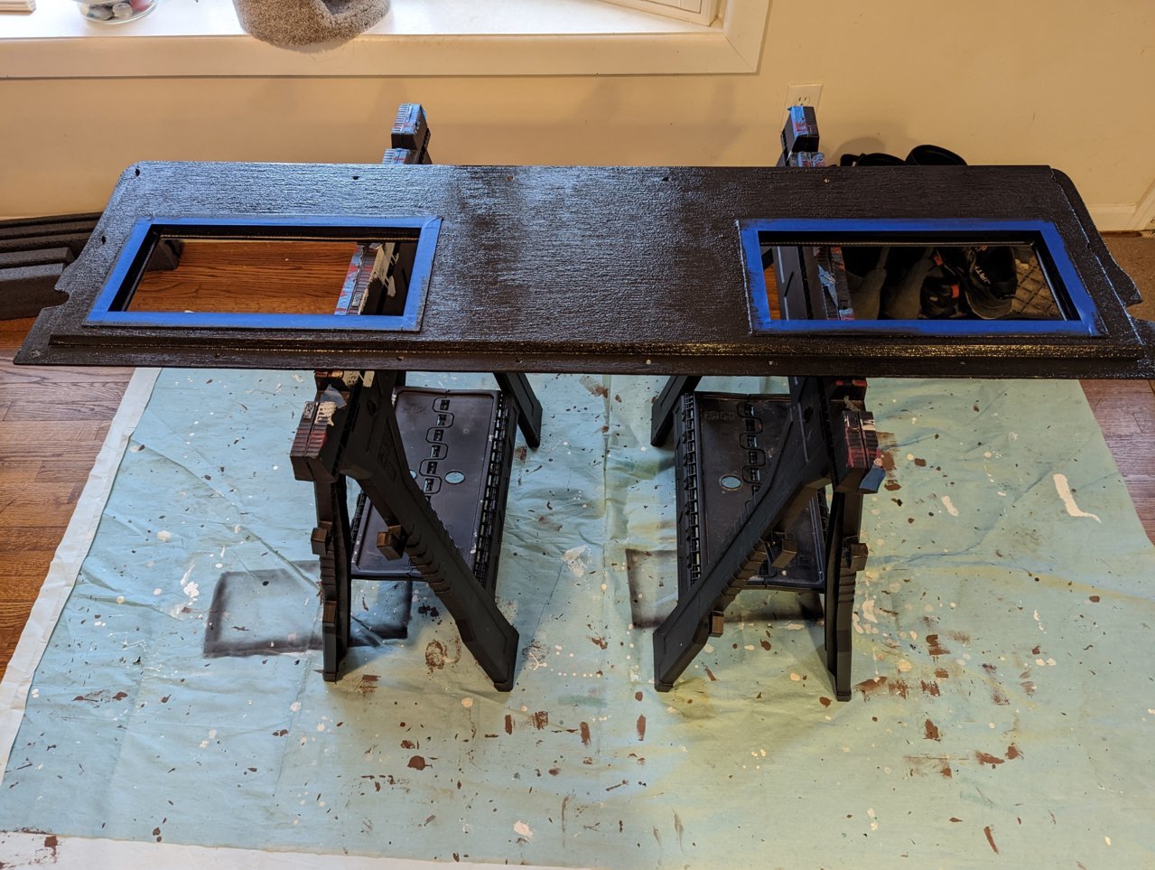

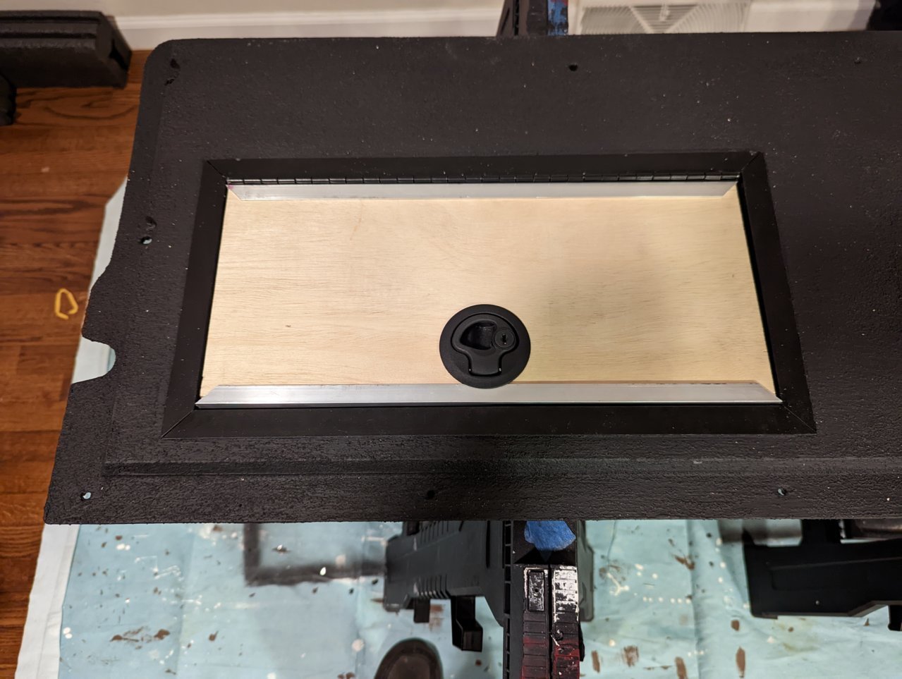

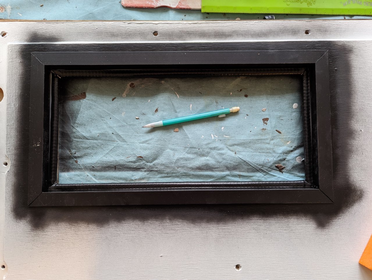

    Exterior paint with anti slip additive
  7. Dec 4, 2022 at 2:20 PM
    d0ugh0ck
    d0ugh0ck [OP] Well-Known Member
    Jan 14, 2022
    #387285
    248
    NJ

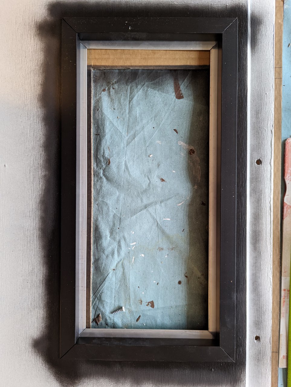

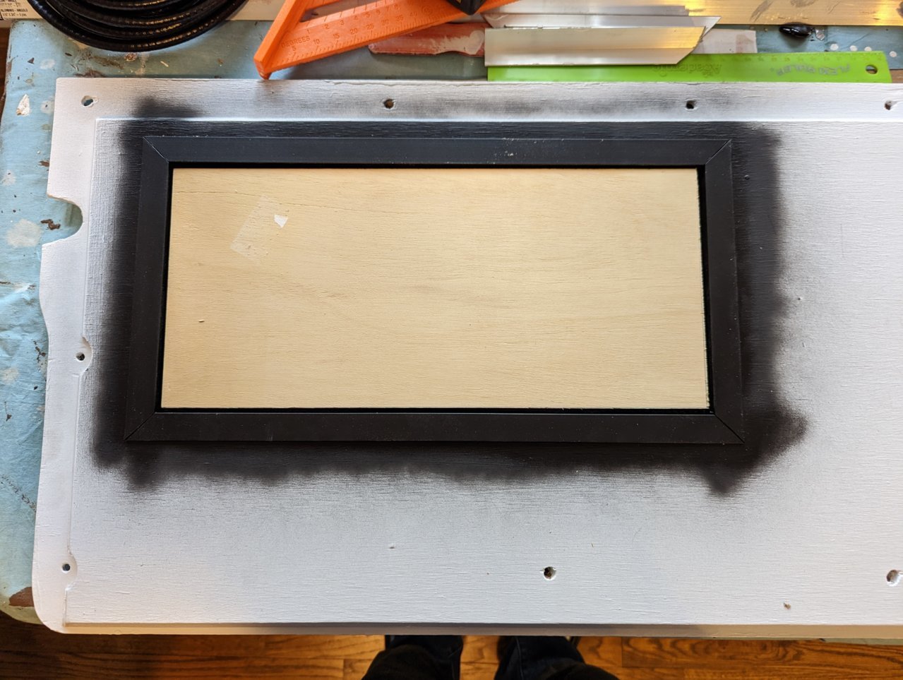

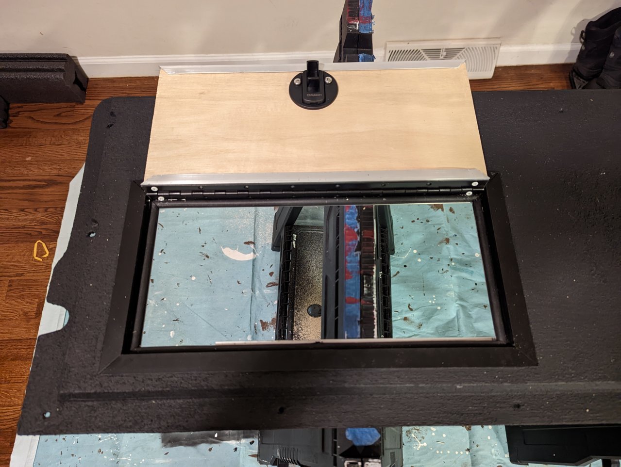

    Started working on the doors

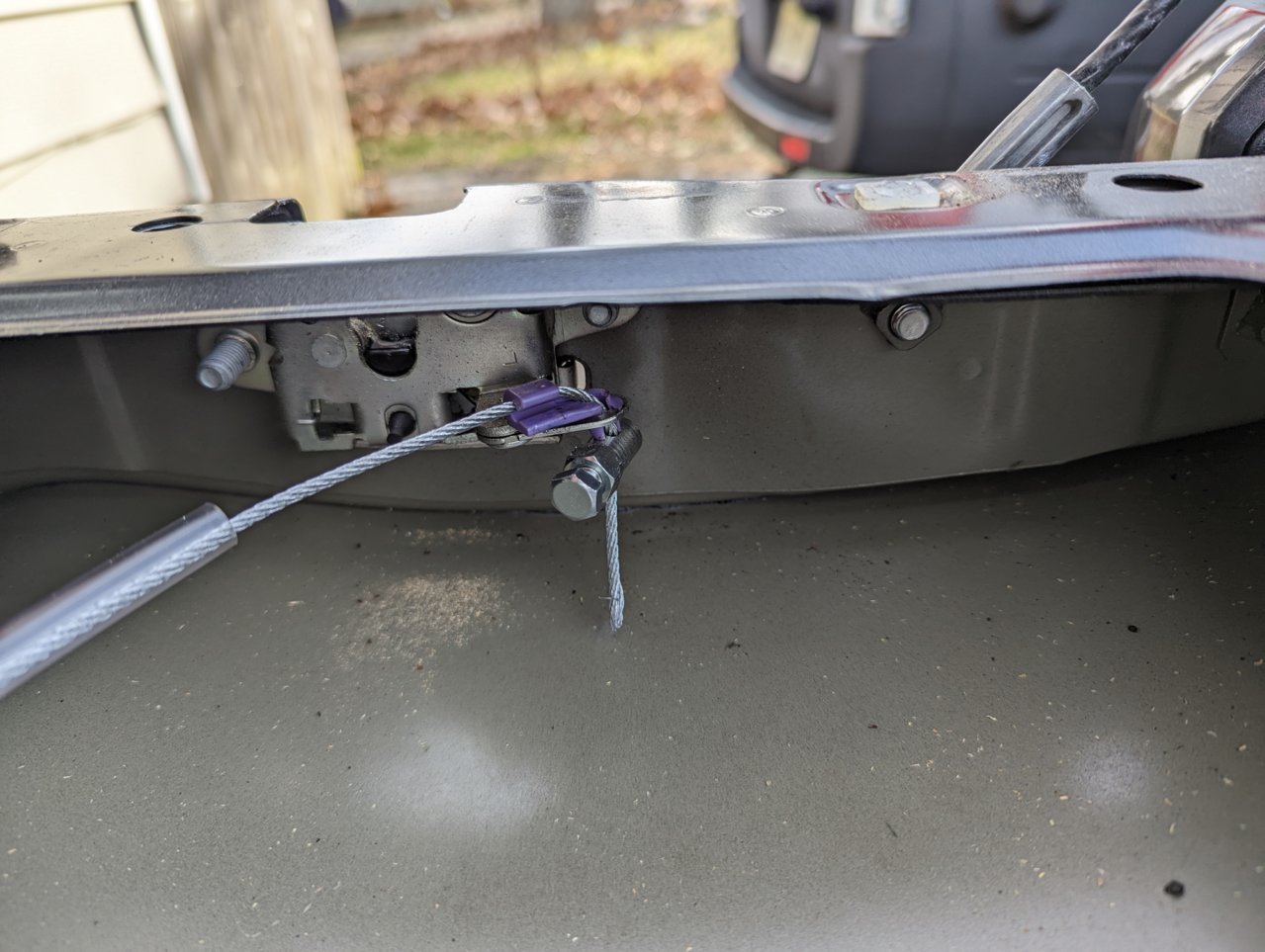

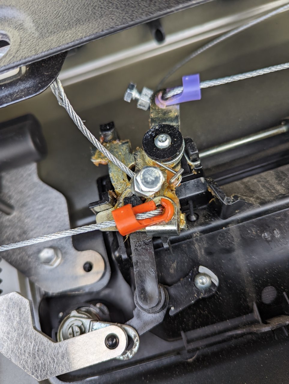

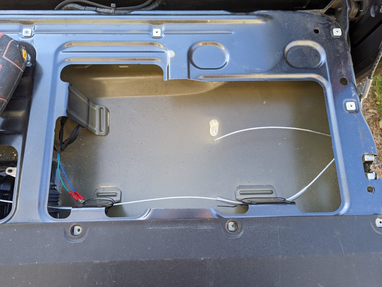

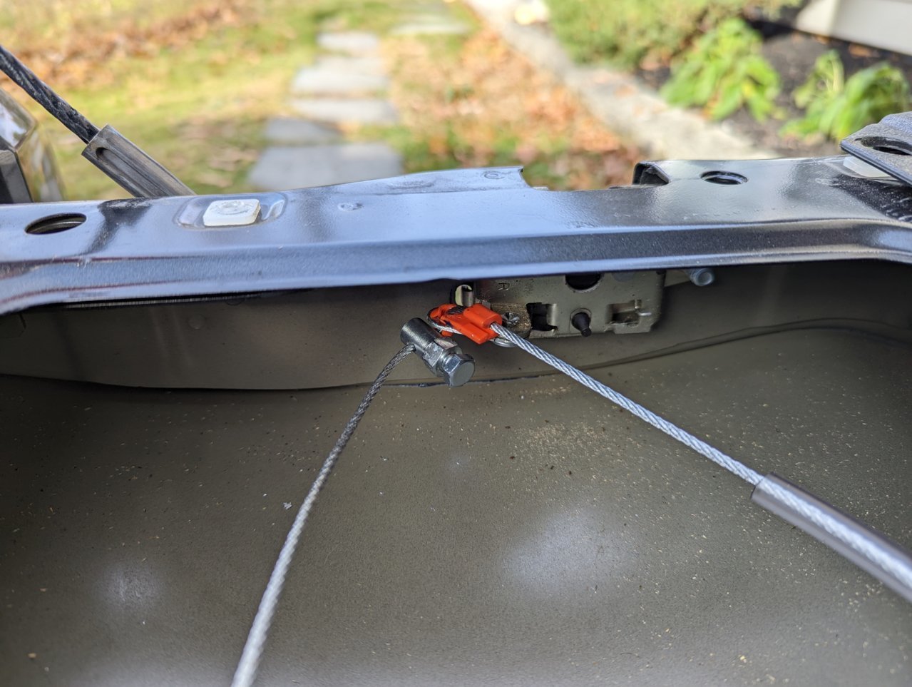

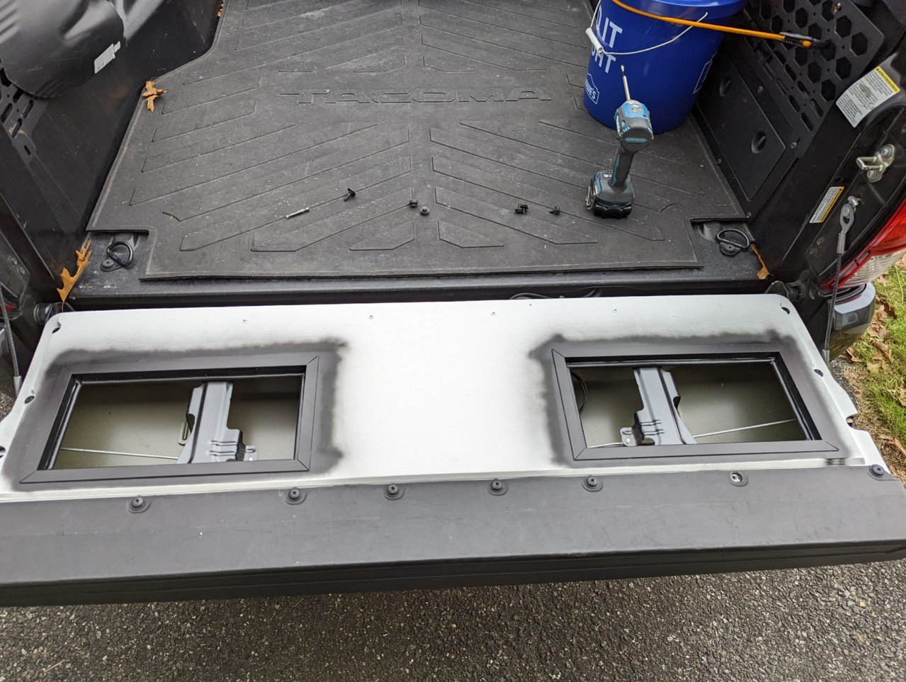

    Ran the cables for the latches
    Vinny C likes this.

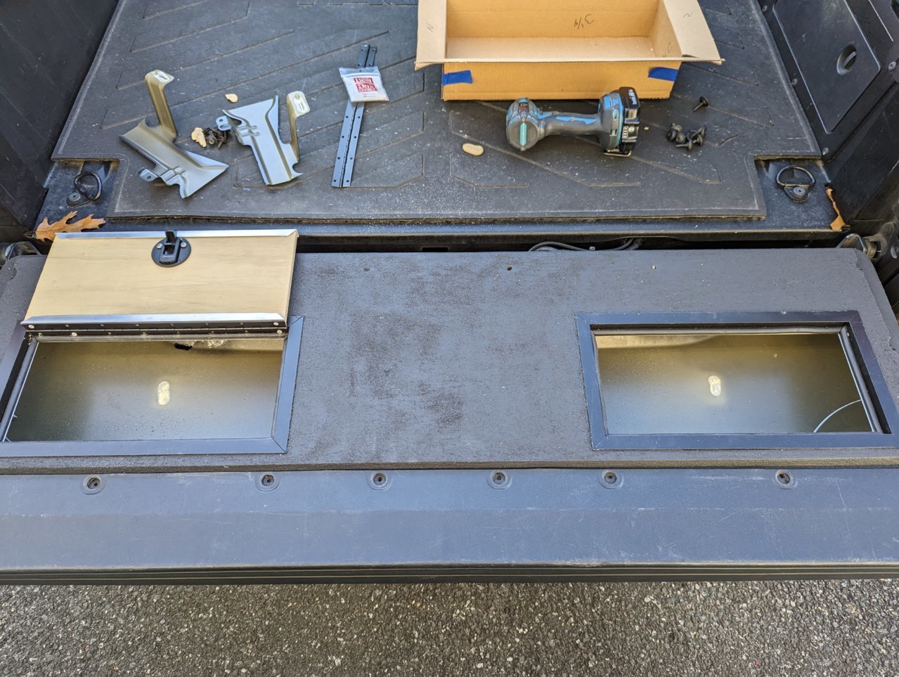

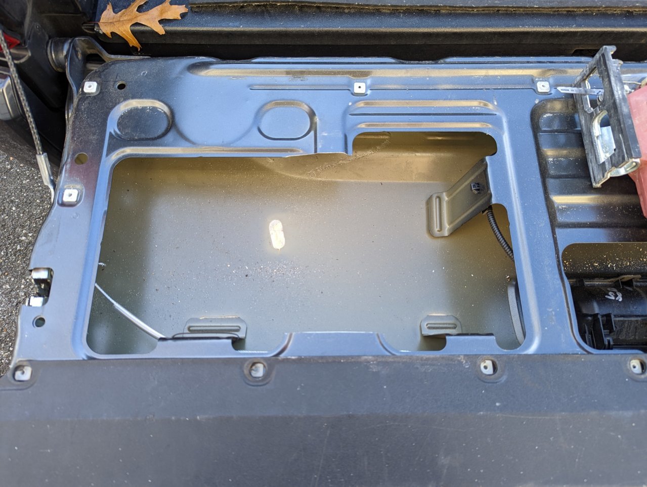

    Cut the support. Used a jigsaw with a metal blade. Quick work

    I was wondering how you were going to protect the backs of the storage boxes from the cable. That explains it.
