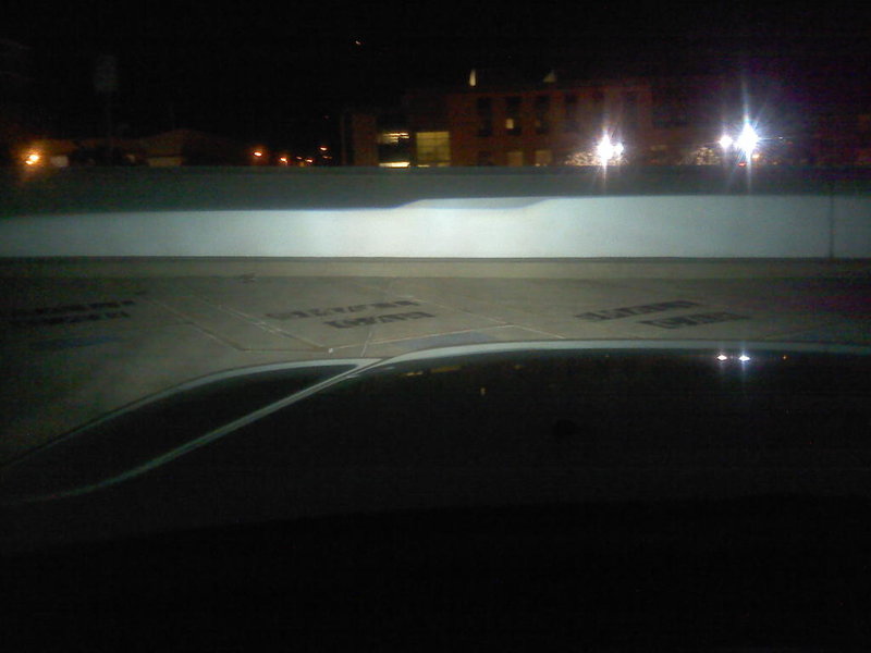

    BTW: Here's my D2S cutoff....
    And you can see where the beams fall on the back of a car....

    Nothing wrong with that cutoff line. So you eyed the projectors up, sealed and didn't touch em?

    nice cutoff Rich....I also did the same with my wire routing under the radiator flap with zipties, ziptie squares, and wire loom (just in case)

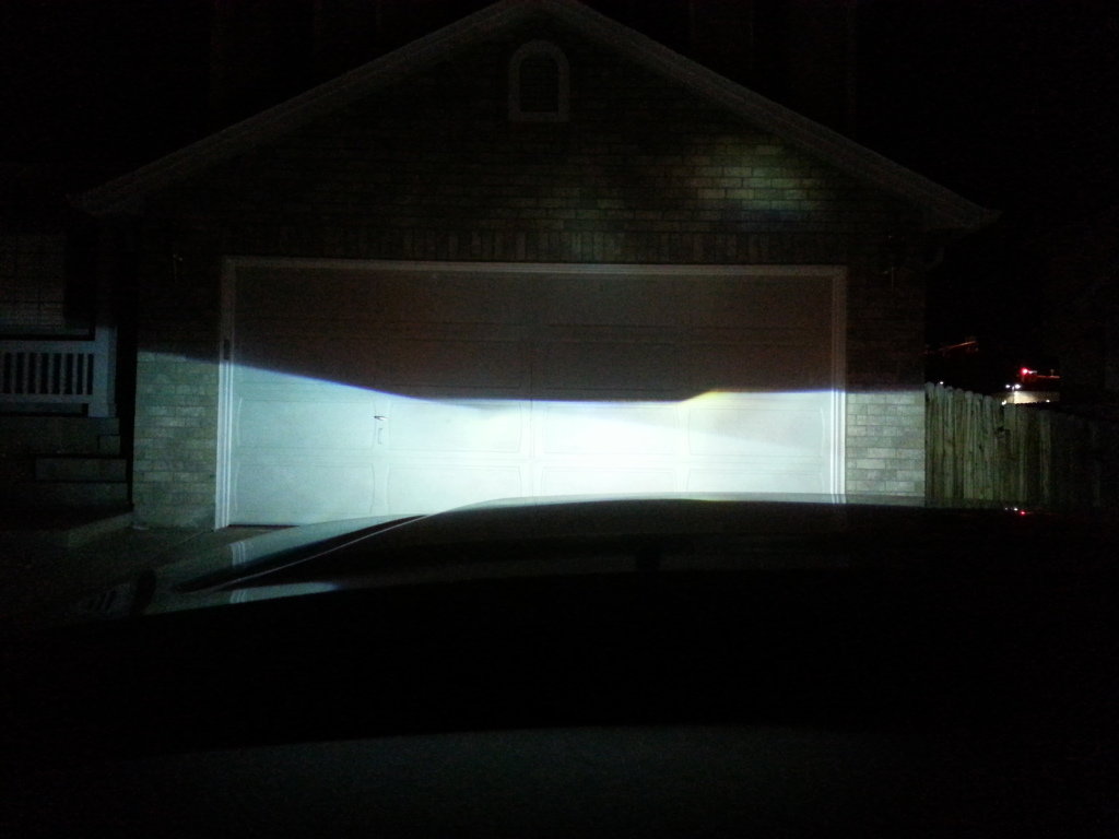

    My cutoff, yeah gonna adjust the driver side in the morning.

    Ya, if anything, I'm a little low on the left, but they're both the same, and it doesn't bother me because it's pretty freaking close, and it is less likely to blind oncoming drivers. If I need more light, I can always hit the highs.
    That's what I don't get about guys who intentionally aim high, or don't reaim after a lift or leveling job, and claim they need it because of deer and the dark country roads.
    Use your freaking high beams! Nobody wants to get blasted. Nearly every morning on the way to work, I'm making a lane change and slowing down to let some moron with HIDs in stock housings or improperly aimed lights pass.

    I'm happy with mine now, very close to being even. Drove next to a new Volvo with OEM hids and my light output is just as bright.
