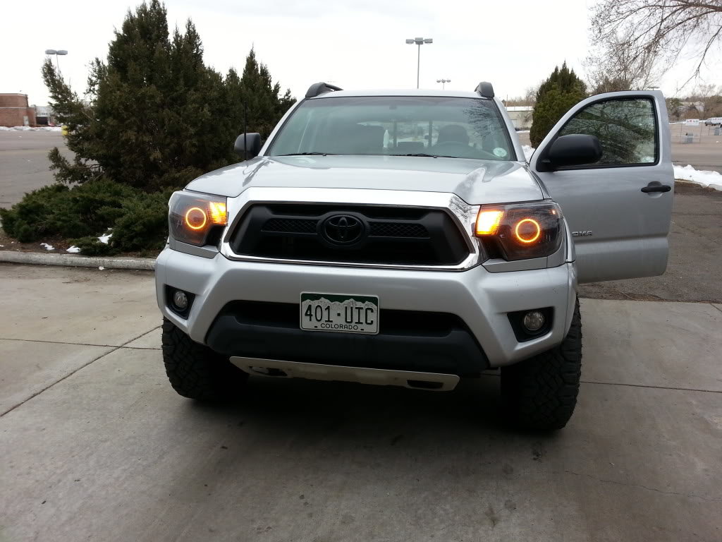

    Got mine done, couple times now and still fogging up, I swear I sealed it up with so much window weld so I don't know what's going on. I did use rubbing alcohol to clean it, could it be its not dried???
    Pic

    Mine have still fogged up on occassion when it changes temperature very quickly. But then it goes away. I have read that guys that have done painting and not waited a few days for it to dry that the lens will fog up.

    I waited like 2 days for mine, I think I have to redo again, getting tired of this really. Glad you got yours done though. You can adjust the driver side light to go up so it evens out.
