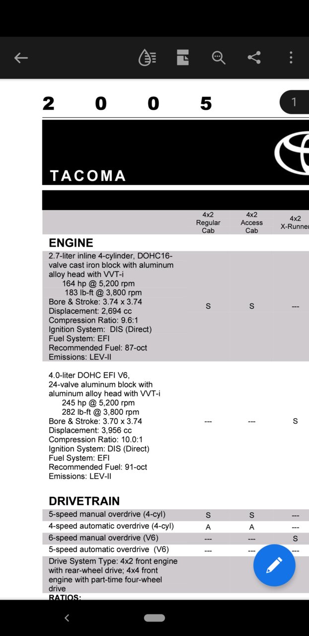

    I owned an '06, and I currently own a '13. I distinctly remember my old owner's manual stating improved performance using 91 octane. That phrase is missing From my current owners manual, yet no changes have been made to the v6, that I am aware of. I did find this supporting what I remember from my old manual. Specifically, v6 horsepower, torque, compression ratio, and fuel requirement.Screenshot_20200611-192043.jpg

    The tune was changed in at least the accel pedal to throttle plate relationship. Maybe other parts of the tune were changed to make 91 less of a benefit... Or they just dropped the verbage in the manual.
