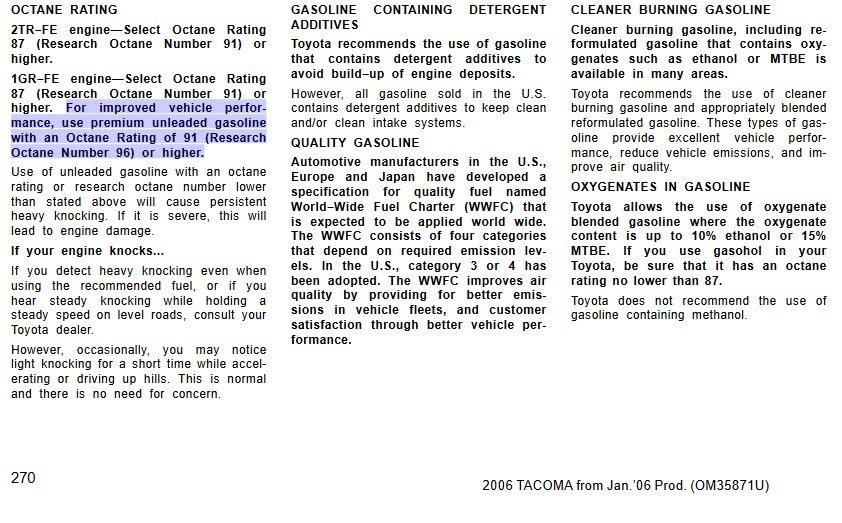

    My theroy is that during the Great Recession when regular gas prices were over four bucks a gallon, Toyota feared suggesting the use of premium fuel might scare away customers, so they stopped suggesting that. At any rate, I have experimented with 87 octane and have found 91 does improve power somewhat. Absolutely zero improvement in mileage. I run only 91 octane or above since that experiment. Heres the complete documents I found supporting my hypothesis. I think I found them on Toyotas website.

    Toyota used to recommend (not require) 91+ octane in the old MZ V6s. They would perform fine on 87 but picked up a bit of performance with a higher octane. Even said as much in the manual. But telling the average Camry owner or soccer mom with a Sienna that they need to use the expensive stuff proved futile. When the GR series replaced the MZ engines, Toyota didn't even bother talking about it anymore....except briefly in the 1GR powered FJ for a couple of model years. But even that fell out of favor with the buying public...especially during the Great Recession
    airplanebuilder likes this.

    I just pulled this from the Toyota website. Page 270 of the 2006 Owners Manual. Missing from '07 and above manuals.
    07tacomatoy likes this.

    Would be interesting to see the fueling and timing tables from an 06 and a later model 2nd gen.

    It certainly would. They might have cracked open the ECU and detuned it, but why would they? Just quit telling people about running premium and leave the ECU alone, considering it runs fine on 87 octane. Deleting one sentence from the Owners Manual is cheaper and easier than redoing the maps on the ECU.
    Plain Jane Taco likes this.
