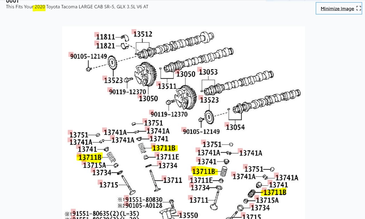

    Based on the Toyota OEM parts manual the valve spring parts numbers haven't changed over the various production years through 2020. I was unable to find a source for the 2021 parts numbers.
    Also of importance is that all the valve springs within the valve train are the same spring regardless of the cylinder number or intake/exhaust valve.
    Seems odd that that only the #5 cylinder valve spring would break and not any valve springs for other cylinders that use the exact same valve spring. Could there be something else that precipitated the damaged #5 valve spring or more damage that has not been mentioned within the thread?
    source: https://parts.toyota.com/a/Toyota_2...1507_6717072/CAMSHAFT--VALVE/674470-1302.html
