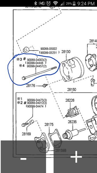

    That's the same diagram that I found to be correct, and I believe that the dealer ordered the numbers you circled. But, I am 100% sure that they are incorrect. Those are the screws that secure that housing assembly together. I gathered that the ones i need are in the bottom right of the diagram (the number in parentheses 90080-10207 and the third number 90105-10221). I just wanted to see if I could get confirmation from another source.

    Looks like these are the bolts that secure the housing together. Or am I not understanding?
    For whatever reason the fsm skips the starter. Goes battery, alternator, then harness. No mention of the starter or mounting bolts. Wierd.

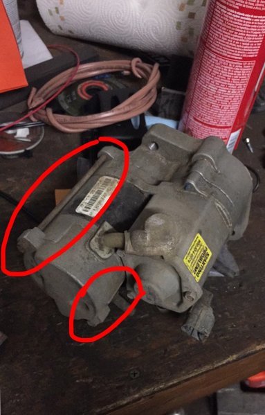

    See my attached pics. Those long bolts I circled in red do hold together the motor part of the housing. The part numbers you circled that I said were wrong are the blue circles and the yellows are the bolts I need. You can see why I am having problems finding what is what, the diagrams are a joke lol

    Gotcha, I see what your saying now. I'd have to agree with you, what the dealer ordered is probably those screws and not the bolts for the starter to the bell housing.

    And in the key to the lower left you can see which is for the auto or manual tranny.

    Well they were 1 for 2 on the parts they ordered. They got the longer bolt right (which was a match with the part number I thought to be correct), but the other part was the "screw" that I circled above in blue. I had them order the part from the number I supplied and they said it will be here tomorrow so we will see if I will be right again.
