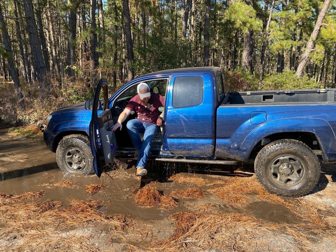

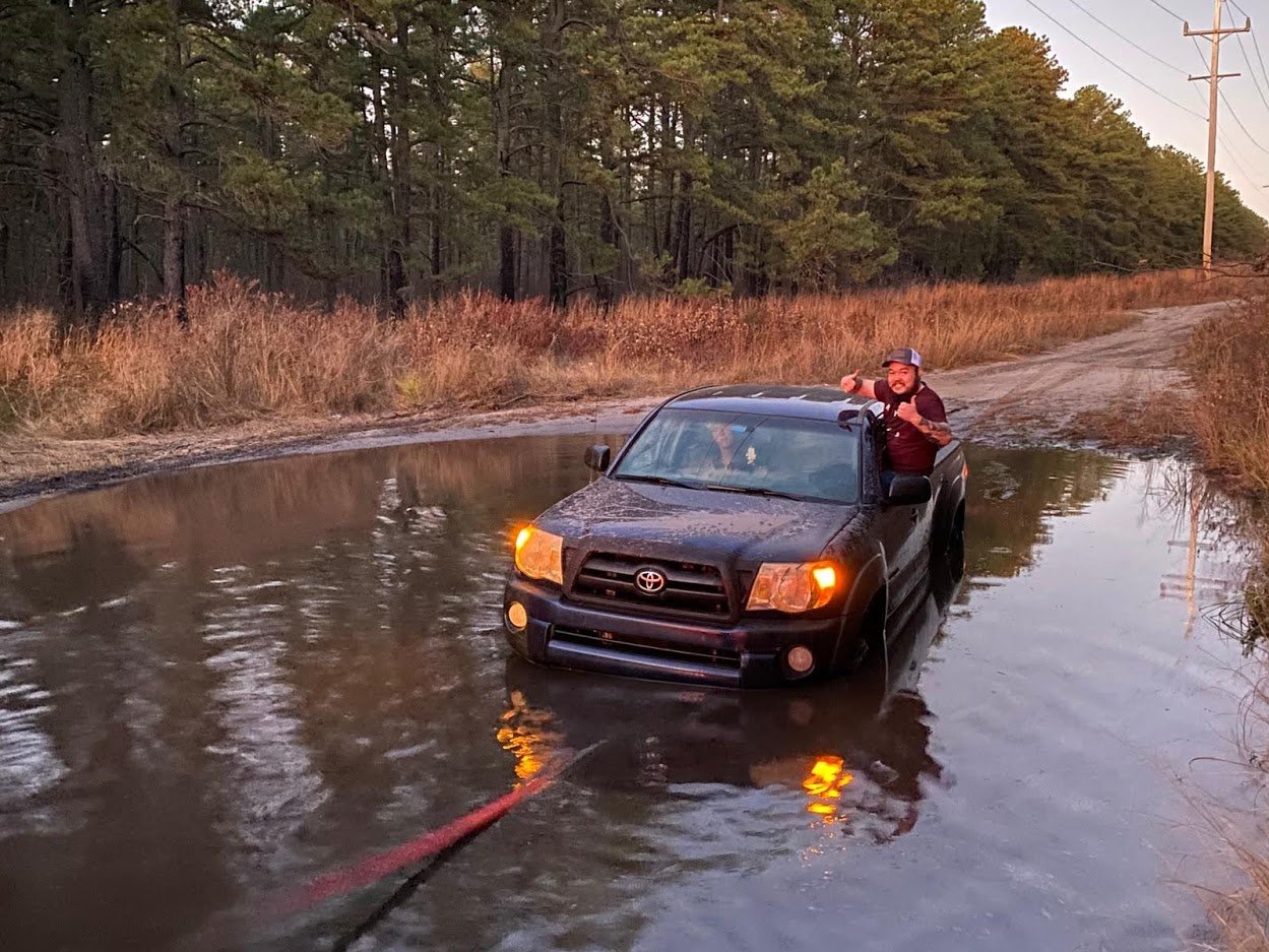

    So this weekend I got to do some off roading, and made a few dumb decisions. For example, I got myself stuck in water that was deep enough to start comin gin through my door seals. Twice...
    That was Saturday, and I had no problems. Yesterday (Sunday) the starter would hesitate for a second, and then eventually sputter to life. Today it did nothing the first 2 tries, then eventually holding the key, it was able to weakly start my truck. I should also note that yesterday I washed the truck, and did spray the engine bay. I just used the DIY washer wand so not a full power power-washer, and avoided the battery and alternator, however I did do some spraying elsewhere in the bay
    I'd like to avoid jumping directly into "Replace it" if possible. What should I be checking? Unfortunately I am at work at the moment and can't get too deep into things, but wanted to get some opinions here. Thanks everyone!
    tl;dr Got my truck real wet, now the starter is weak. What do I check first?
