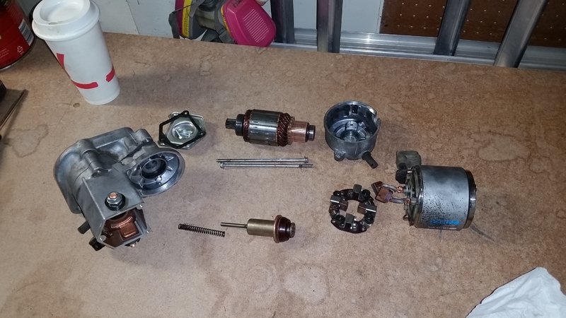

    So after reading a thread I decided I would pull the starter, clean all connections and see if this fixes my clicking when trying to start. Almost ready to put it back together, just waiting on the wife to wake so I can fill the air compressor to blow out all the components. I'm wondering if I should be buying a selonoid rebuild kit while it's apart?

    I'm going to put it back in and try the hammer. Guess I should have tried that already.
