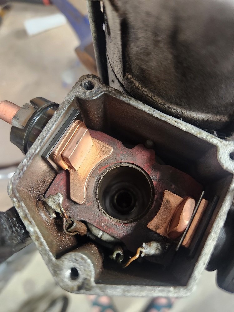

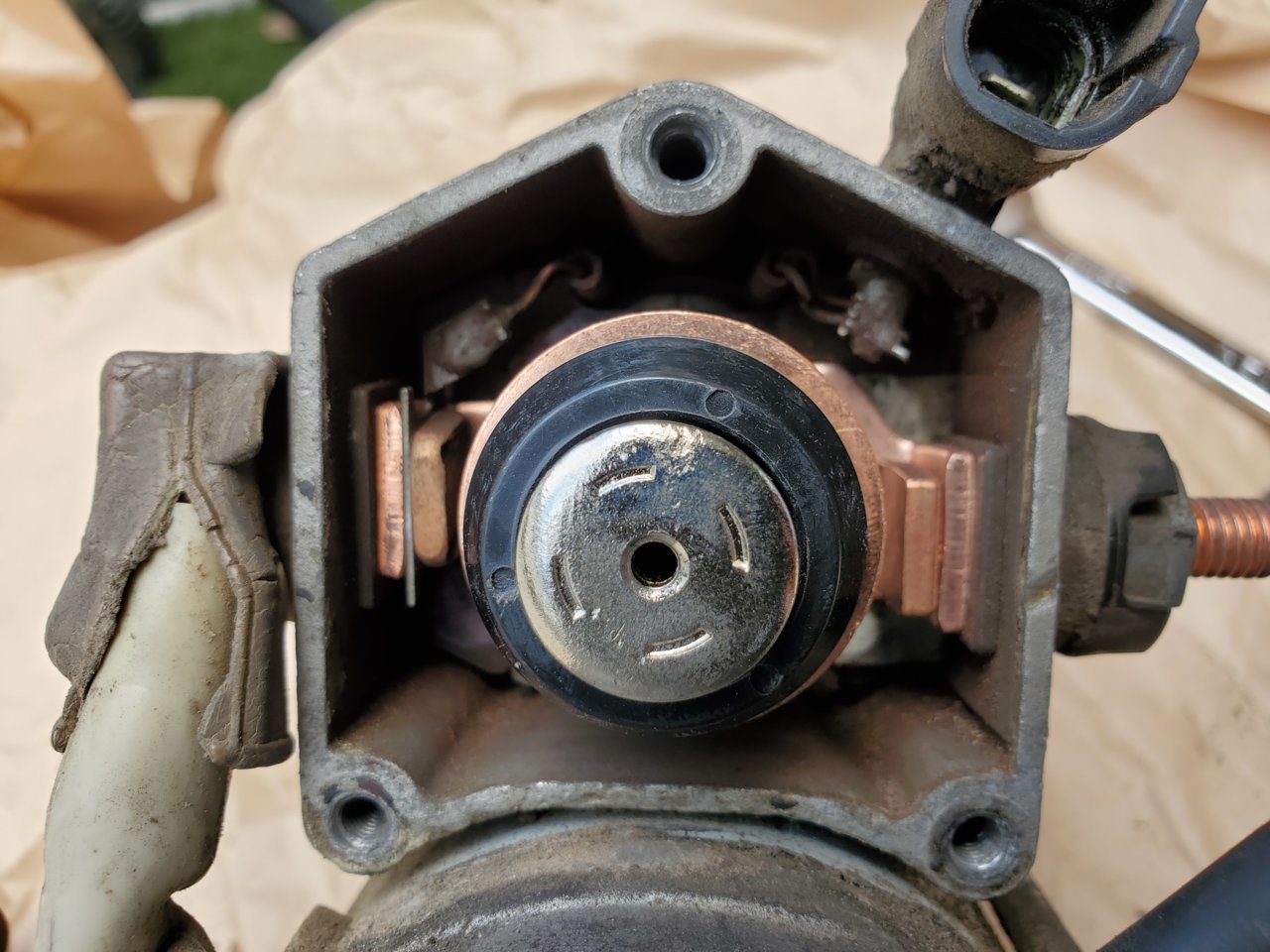

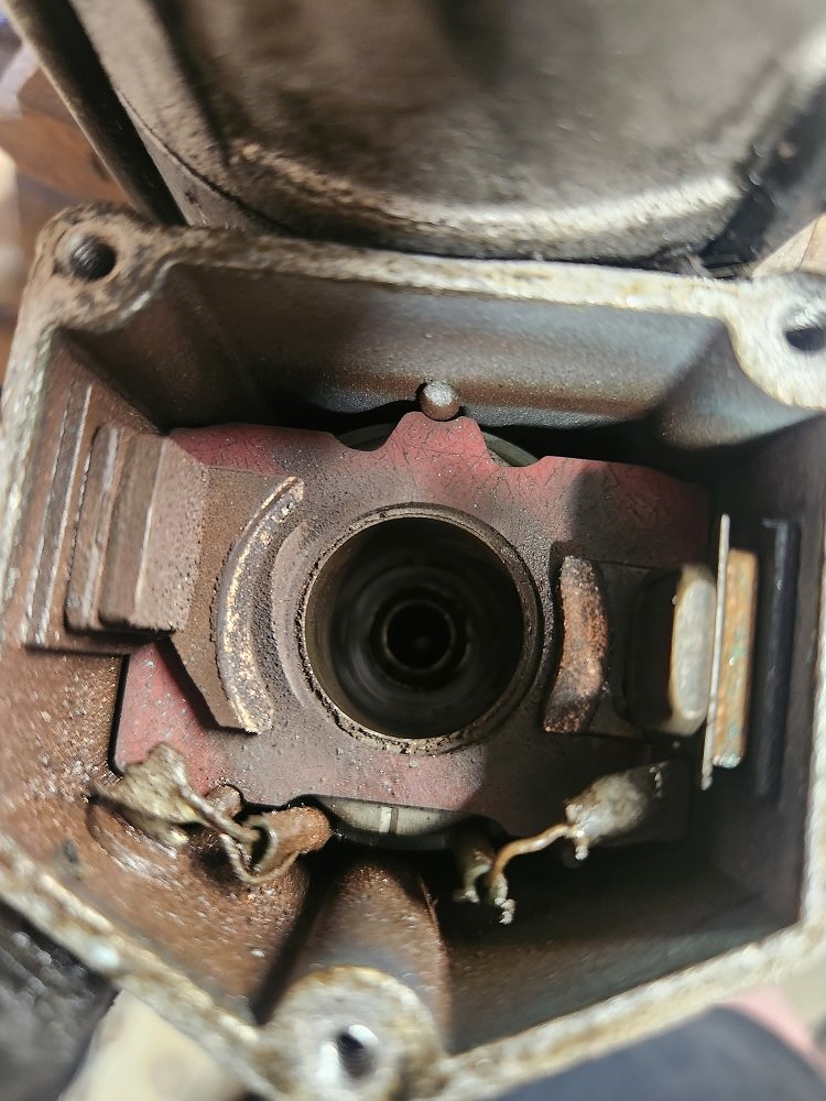

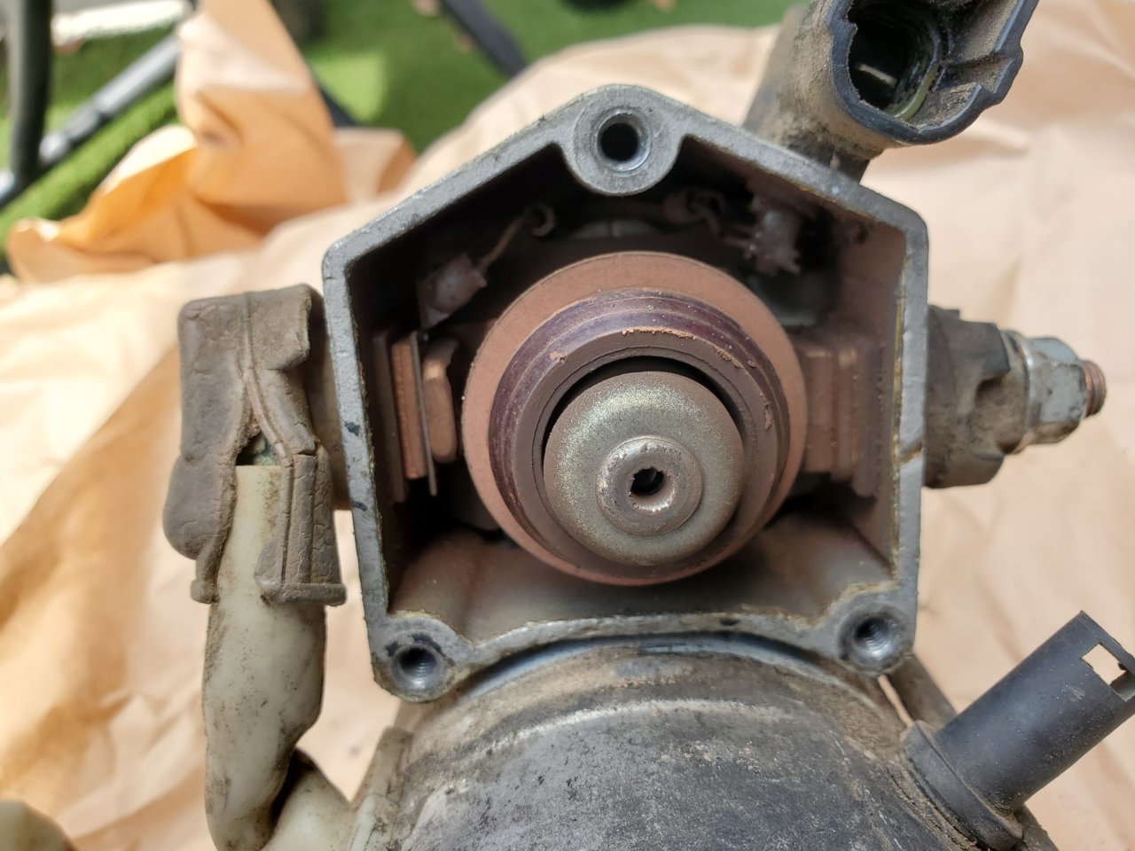

    Parts came in and I tackled the starter this afternoon, took about 1.5 hours in total.
    Lots of crap to get out of the way, getting to the bolts that hold on the starter is definitely a pain in the ass.

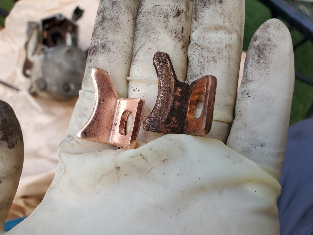

    The contacts on the old starter were very worn down, replaced all the hardware and plunger inside.
    Bolted everything back up, replaced the starter and everything else, truck fired up stronger than ever.

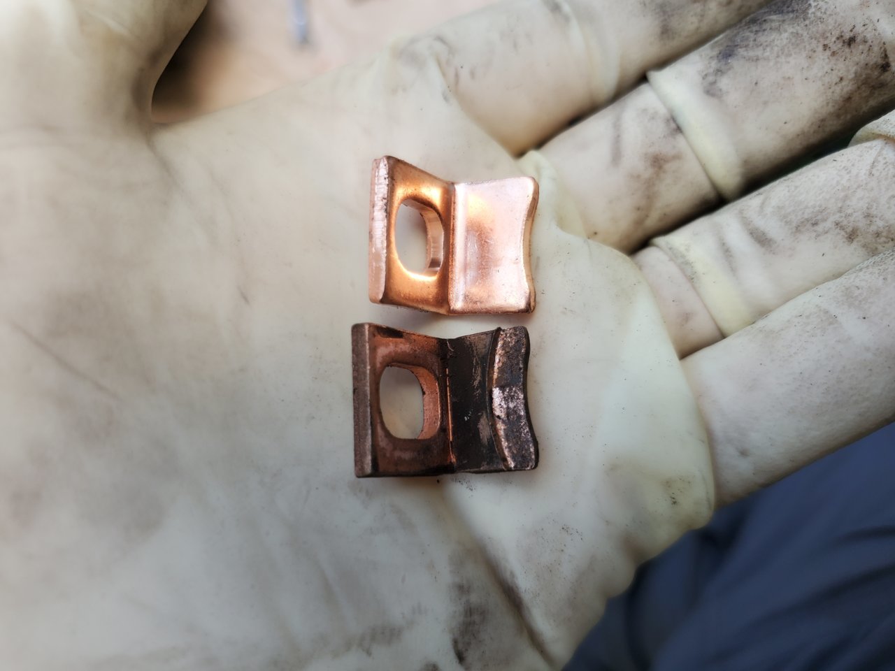

    One of the copper contacts was worn down significantly more than the other.
    Any idea what would cause that or if it matters to the starter functionality?
    Bivouac likes this.
  15. Aug 31, 2023 at 3:17 PM
    Kwikvette
    Feb 27, 2019
    #284735
    81,923
    Fresno County
    4 run, 2 don't
    Don't matter, mine was the same way.
    Think I had about 260-270k miles on mine when I rebuilt it.

    Might just be manufacturing tolerance differences.
    Just curious did you do lots of deep water crossings or was the truck in a flood?
    I have never seen that much grit and dirt inside the starter.

    No water crossings or flooding, but I live in a wet climate in the SE US by the water and it rains a lot.
    The rubber gasket sealing the inside wasn't in the best shape either.
