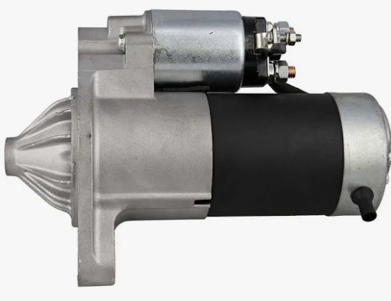

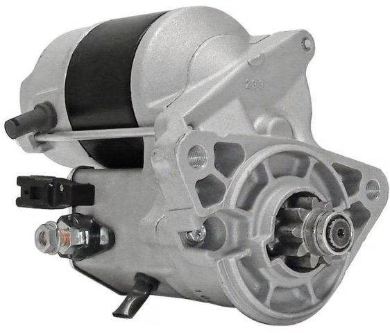

    Anyone have difficulty fitting in their 1st gen 2.4l starter motor? My previous OEM was a Denso. Other brands have a higher/taller profile. Notice the difference. Was it a major hassle getting in the larger starter?

    Will fit without issue. The difference is due to cold climate which requires a larger solenoid IIRC.
