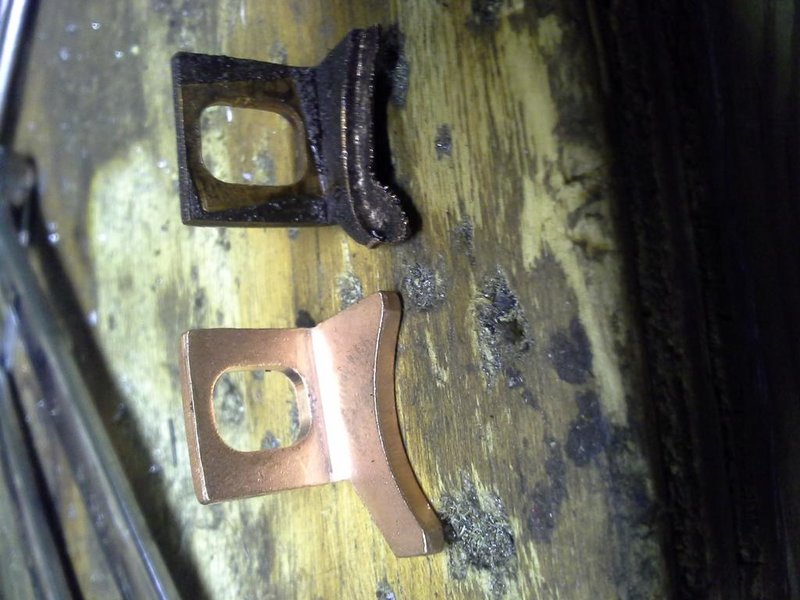

    Just replaced the contacts on my 99... Here is new vs old

    That old contact still has plenty of wear on it, but just gummed up. I'd clean it up and carry that as a trail spare.
    When I replaced mine, the wear 'shelf' was paper-thin, and couldn't carry the current.
