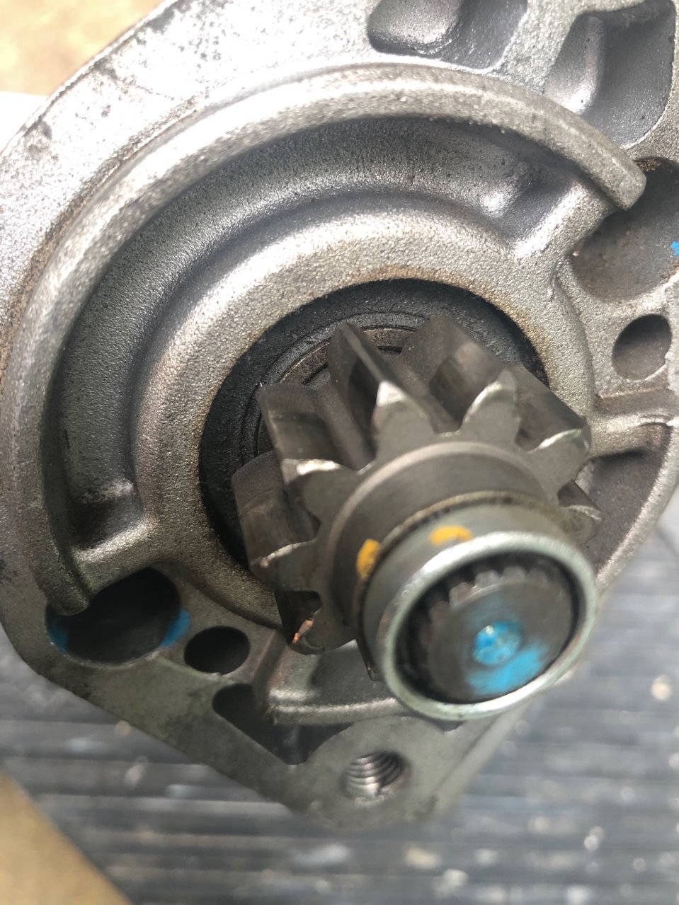

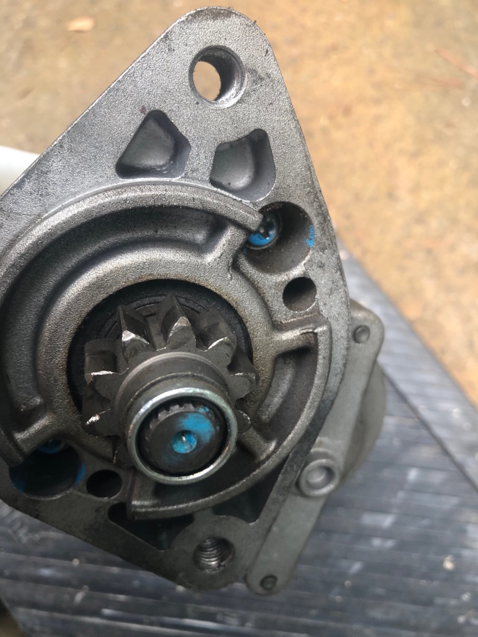

    IMG_7566.jpg IMG_E7564.jpg IMG_7567.jpg Okay. Here's what I'm working with. I have the starter off and as you can see the teeth are worn. My question is could this cause the problem? The spindle does seem to work appropriately (move in and out without diff), but it really appears the teeth are not seating in the other end proporly.

    I have an old motor in my garage. I'll take a pic of my flex plate. The starter looks fine to me, the flex plate looks really worn. Did you spin all 360 degrees? Are there missing teeth? The flex plates on these are pretty thin.

    Looks like starter isnt engaging all the way...teeth look worn on flywheel. Is your battery charging ok?

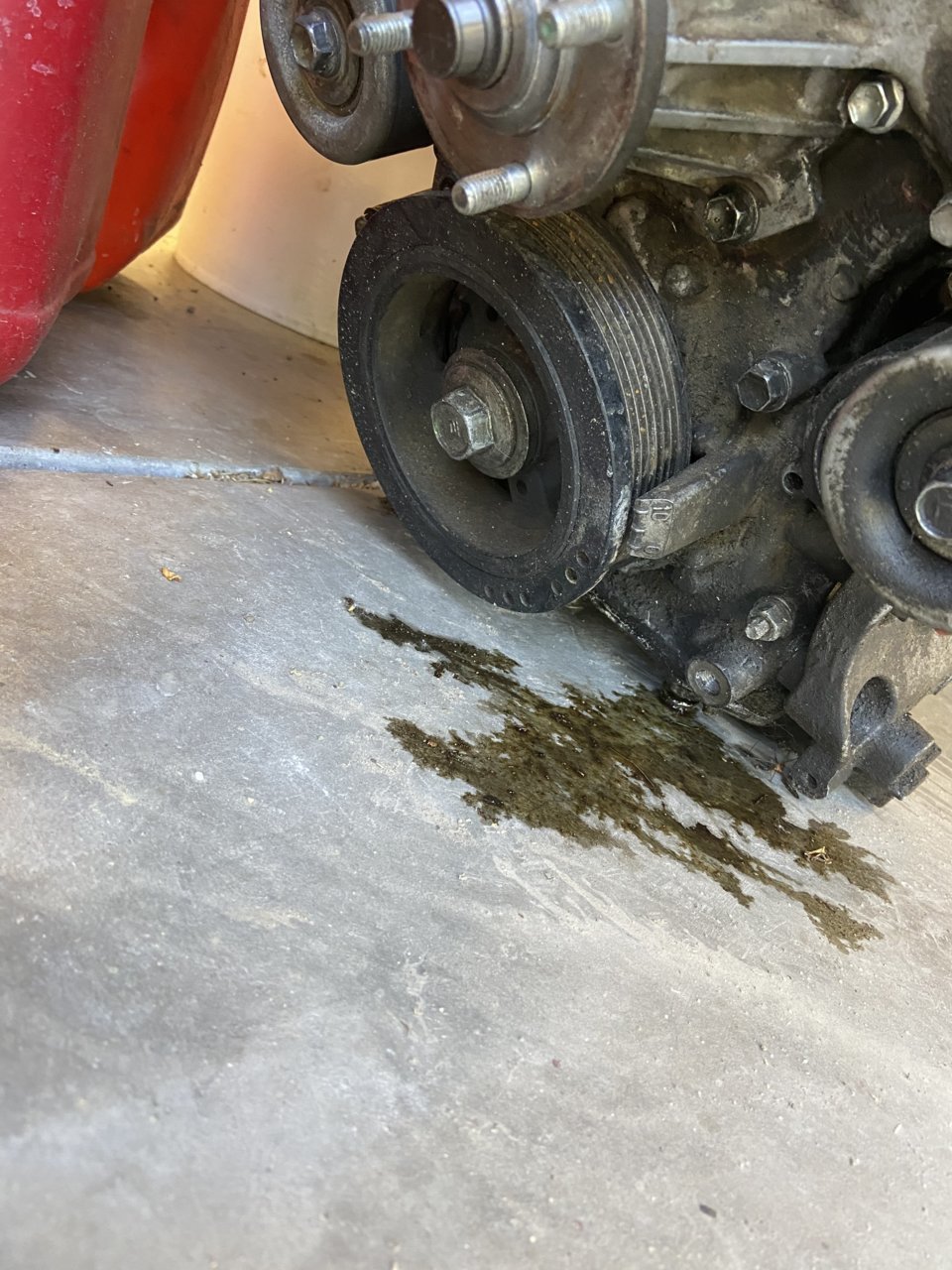

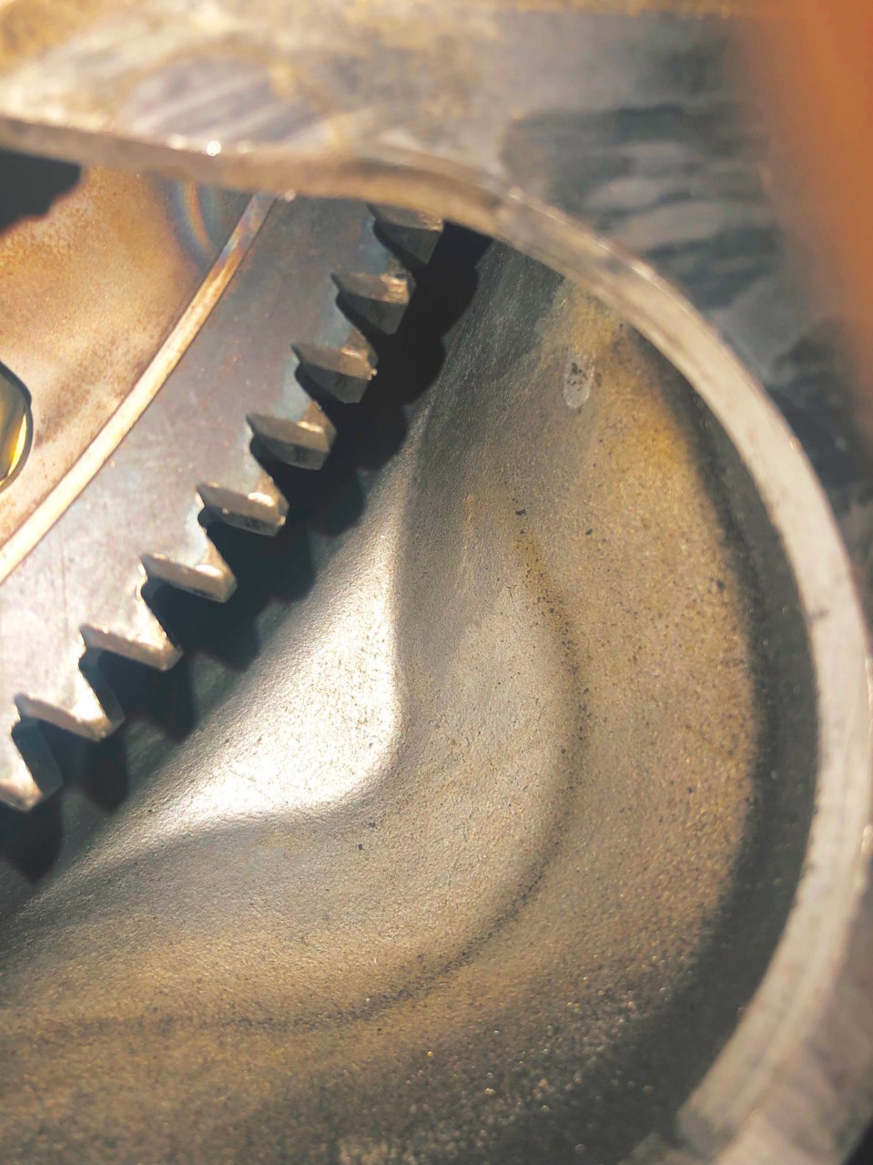

    34C933D2-1184-4AB0-BEE1-E9D7EF59C07A.jpg 3EBC4EEA-FA1B-4710-AFE4-40705A25C2A3.jpg
    Here are the teeth from a flex plate with 220k miles. They look perfect.
    Also, a pic of the harmonic balancer, which you can turn with a 22mm socket. It’s attached to the crank.
    I think your flex plate is shot.
