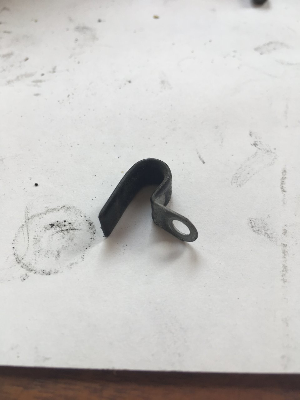

    When I was cleaning up I realized this piece got left behind! Is it crucial? Worth removing the starter and doing it all over again?

    Wow. There are whole shops that do nothing but rebuild electrical stuff like starters and alternators. He must have gone to the mechanical school of R & R. (remove and replace). It does make more money for most shops, I'll admit.
    :amen:
    Maybe. It looks like a wire harness retainer? You don't want that cable/wires moving and getting chafed, burnt, etc. Look it over and see if you can tell where it goes. PS, zip ties are NOT your friend in this case. Eventually they'll fail.

    Just a wire holder, make sure no wires are rubbing on anything and you should be good, zip ties WILL work for holding wires away from sharp objects

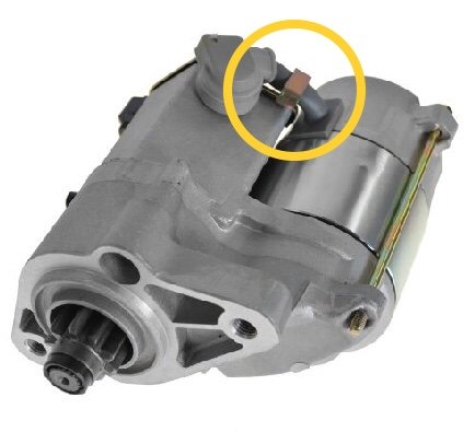

    I think this is the clip. Should do the whole thing over to put that clip back?
