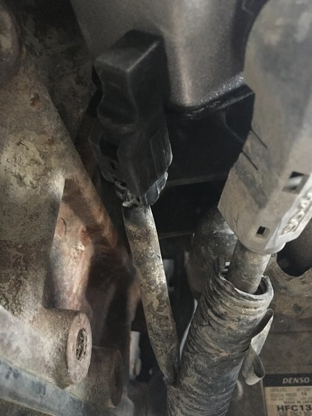

    Is there supposed to be a clip where the wiring connects to the starter? To hold it firm in place?

    What do you mean by the clutch safety circuit?
    And by the corroded wire connection do you mean the part that I have pointed out in the pics above? They don't seem corroded.

    And by plastic connector, do you mean that plastic cover that snaps on over the starter ground connection? It's there.
