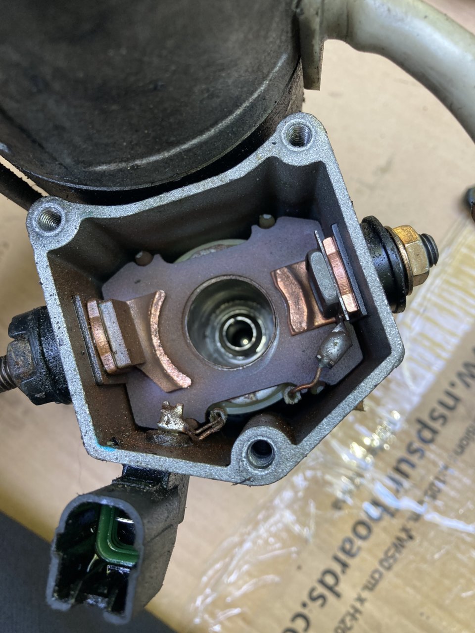

    I second the starter contacts, but yes check battery connections too. There are several threads on removing the starter motor to replace the contacts, it’s a bit finicky getting the motor out but a quick and easy job, and the kit is cheap. You’ll know if the contacts are worn, mine looked like the photo below.
    I had the same symptoms as you, intermittent “click” every 10 to 20 starts. If it ends up not wanting to start on you at all you can tap on the starter motor with your lug wrench or something to get the solenoid/plunger unstuck and get you home. I did that for weeks on occasion, but the final straw was having to rapidly tap on the starter while a buddy turned the engine over, in the rain. I replaced the contacts the next day.
