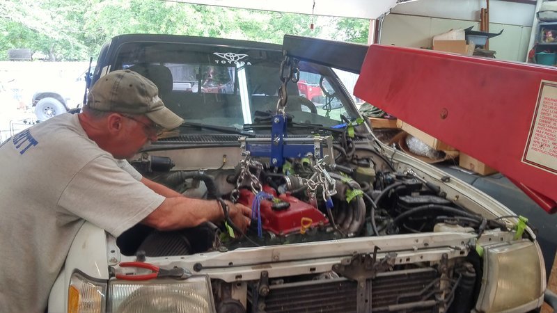

    Hey guys I have 1998 3rzfe, that I recently pulled the engine and transmission to replace seals and bearings. Now that everything is back together, I'm having some starting trouble. Yes it's a new fuel filter, and has 1/3tank of old gas with 3/4 tank of premium. I was able to drive for 100 miles after the new gas was put in but after I parked it to try it the next day I don't hear my fuel pump come on and I don't smell gas.. What are some common failures or fixes? Anyone else have this problem?
