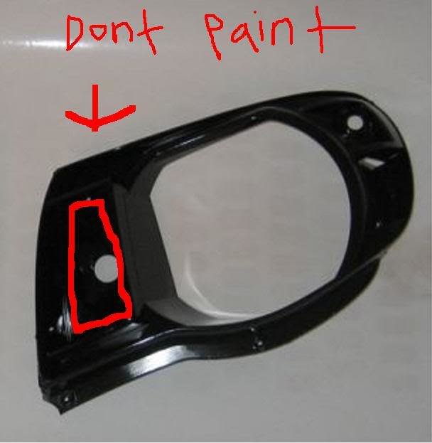

    how do you seal them again??

    You cook em again, let the original sealant melt again, as soon as you pop them out of the oven you press em together. After they were back together I added new sealant all around.

    both lights look great! i need to grow a pair of Huevos and do it! LOL

    ^^^ no seas culero guey! ITS EASY!!
    I tip for everyone... don't paint the reflector chrome from the turn signals. I did and now my signals are are very dim. Just put some tape before sprying them. No one would be able to tell because you still have the yellow plate that covers it.
